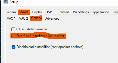

Wants/Wishes
Option to auto-reset the VAC Under/Overflow counters in the VAC Settings when clicking/resetting the VAC Under/Overflow indicator on the console.
Posted: Thu Apr 28, 2022 1:03 am
K1LSB wrote:Wants/Wishes
You can set them so they fade away. In that mode they will only momentarily show when the overflow/unerflow count increments. The other mode they hide when you click them, only to show again when the over/under increments. Not sure I see any gain from clearing the under/over number tbh.
Leaving this unchecked will cause them to fade away...
Posted: Thu Apr 28, 2022 9:22 am
The gain is that I wouldn't need to manually go in and clear the indicators and counters individually. IMO it would be more streamlined/elegant to at least have the option to reset the counters and indicators with a single click.
