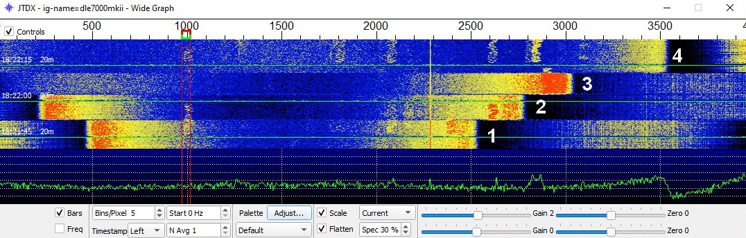

Re: Odd issue w/ FT8 & new builds.
When I began using the new 2.8.11 builds, noticed an odd issue w/ FT8 - increased signal on the JTDX waterfall near the edges of the filter band.
In the image below, #1 = 2.0K filter width, #2 = 2.5K , #3 = 3K, #4 = custom 3.51 K filter width.
Any idea what might be causing this? Looks like aliasing.
If no one else has noticed this behavior, could it be a corrupt database?.
All the best, Taiga

Posts: 1587
Not seen that issue here. Is digiu selected, and the correct filter size, such as 3.0k? Are you using VAC's or some other method?
Taiga

Hi Ritchie,
Thanks for the reply. Normally use digu with a 3K filter and VAC. In order to mitigate the issue now using a 3.5K filter so that the abnormal signal falls outside the FT8 passband.

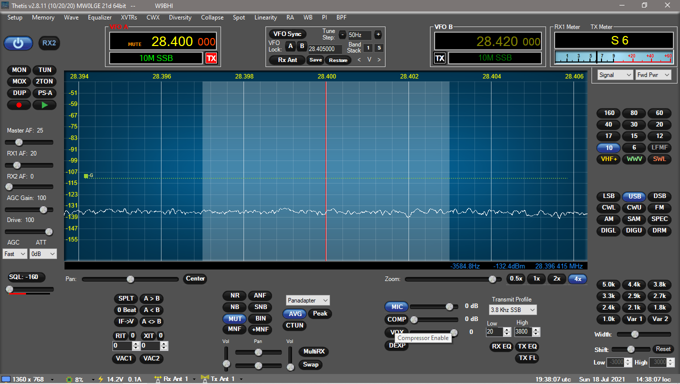

I went back to 21d and it still has problems with mode changes.
You see that it is in USB but the panadaptor shows AM.
I am running the 21d database.
Screenshot (140).png (240.92 KiB) Viewed 23686 times
