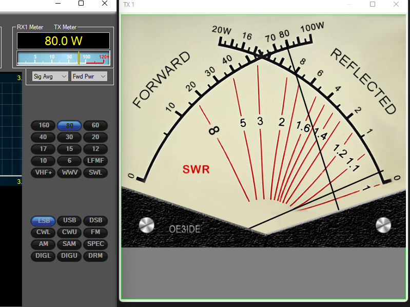

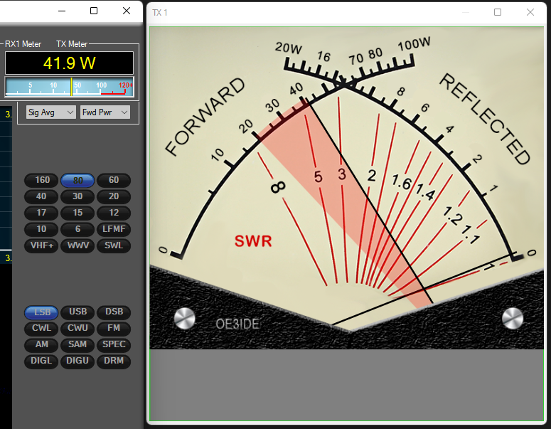

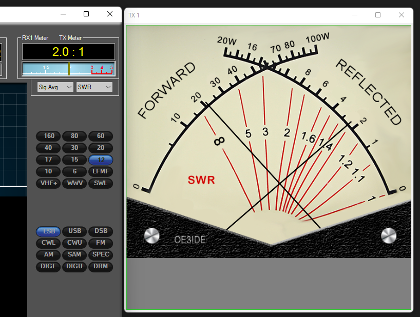

Hey all,
Well, a day of sorting out data to image calibration, so I just had to implement a cross needle meter. The images are thanks to Ernst, OE3IDE. Building all these different meters irons out issues and tests the implementation. They will all come as part of an update sometime down the line.
Loads more to do, but some progress at least.

Wow! That is a beautiful meter. I'm sure your completed work will be incredible, useful and needed. Thank you guys for the work you accomplish.
I've been using Bob's Meter for the past few months. I like the look of the analog meter. I don't particularly care for the large size, but I can get past that. I know it takes many weeks of work to bring the new meter(s) to fruition. I await the unveiling with great anticipation!
W7GES
Posts: 89
Location: Phoenix AZ
Post by W7GES »
rbduck wrote:Wow! That is a beautiful meter. I'm sure your completed work will be incredible, useful and needed. Thank you guys for the work you accomplish.
Hi Ruben,
I'm guessing that the large meter size in Richie's post is a screenshot during his development work. The meter looks like it's in a second window and most likely scalable.
George / W7GES
