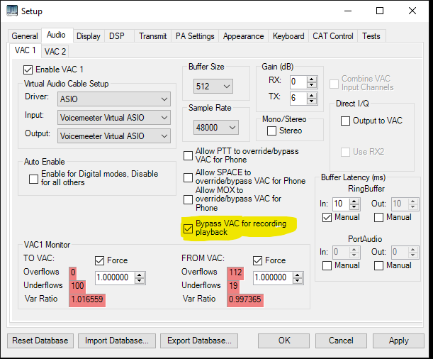

UPDATE
Small update to add option to disable/enable the VAC bypass changes related to recording playback when vac is enabled.
Link : https://www.dropbox.com/s/z4d5bx6nhhbgp ... 6.zip?dl=0
If VAC is being used and you want to use recording playback this needs to be checked on. This may be a stop gap solution and may change. If you use direct connection of mic etc to the hardware then with this option checked gain does not work on the wave window. @Michel uncheck this.

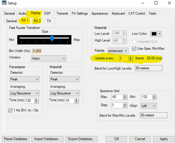

Waterfall delay has changed. In setup>display>rx1/2 set waterfall frame interval to 2 or whatever you want. A setting of 2 means that the waterfall is updated every 2nd frame. So waterfall updates are now directly based on the FPS timing. if you have 60fps selected for example, the waterfall set for every 3rd frame, you will end up with a delay between each waterfall update equal to (1000ms / 60fps) * 3 = 50ms.
Change logs explain it, as does big post somewhere a version or so up from here in this thread.
