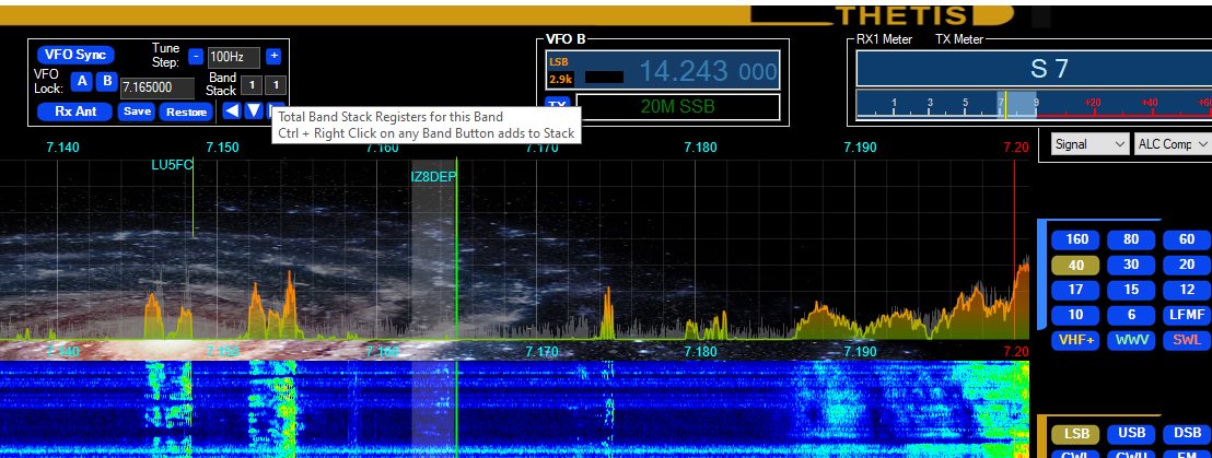

new band-stack:
Ctrl + Right Click does not work.. its now Ctrl + Left Click. So the tooltip should be corrected

I concur with Ernst, in that Ctrl + Right Click does not work.. its now Ctrl + Left Click for new band-stack entry.oe3ide wrote:new band-stack:
However, I believe the code should be corrected, not the tooltip (I assume Ernst was just being facetious, lol).
Thanks, Richie.
Code wise it was cleaner to do it on left click. The tool tip got changedK1LSB wrote:I concur with Ernst, in that Ctrl + Right Click does not work.. its now Ctrl + Left Click for new band-stack entry.oe3ide wrote:new band-stack:
Thanks, Richie.
Not a problem, Richie, I was only a bit concerned that folks accustomed to the previous functionality (CTRL Right Click) might get rattled if they haven't been keeping up with the thread.

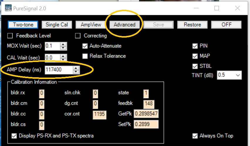

Just wanted to post a issue I came across. When I have 21d installed, pure signal will run but not turn green for about 30 sec during TX. It would happen every time. Starts off yellow and red when I first TX, then turn green after about 30 sec. I installed 21c and the problem was not there, pure signal worked as expected. Install 21d again, same problem once again. Not sure if it's my system but, it is repeatable.

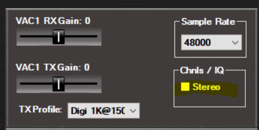

On 21d and Ernst Yaesu skin, in DIGU mode the check sign in stereo small window is rather same white color of the window background, not black as usual.

YesI2NOY wrote:On 21d and Ernst Yaesu skin, in DIGU mode the check sign in stereo small window is rather same white color of the window background, not black as usual. I will try this afternoon 21d2.
Confirmed, also in 21d2. @Ernst is this a skin issue?

About Stereo "button" in digimodes:
Its not skin-related. In fact it is a regular checkbox, I guess the foreground-color is white (or light grey).

(just tested: was black on white in 2.8.11.TAPR)

Like usual checkbox, the check sign would be black but in my case is the same color of background (white). Leon put already a picture of this small cosmetic issue.

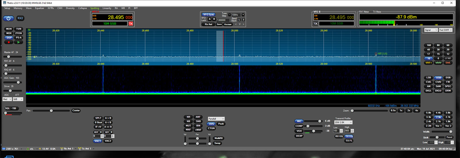

I will post a picture of a strange behavior of modes buttons, when you are in TX or with VFO locked, using Ernst Yaesu skin.

w2ner - I am not sure how the fixes to attenuate the correct adc would have an PS, working in 21c and not 21d. Can you let me know your radio model, show me screenshot of DDC page, and also the protocol you are using. The ddc/adc selection for attenuation is changing in 21e however.
i2noy - yes I blindly go through all checkboxes/radiobuttons and set the background colour to fix an issue Ernst was having with his skins

w2ner wrote:Richie
Hi OM, did you checked the AMP Delay setting?
See pict: with this setting i can reproduce what you see.
I don't have a Ext Amp so this setting is 0 in my setup.
- AMP delay.png (90.03 KiB) Viewed 20063 times
