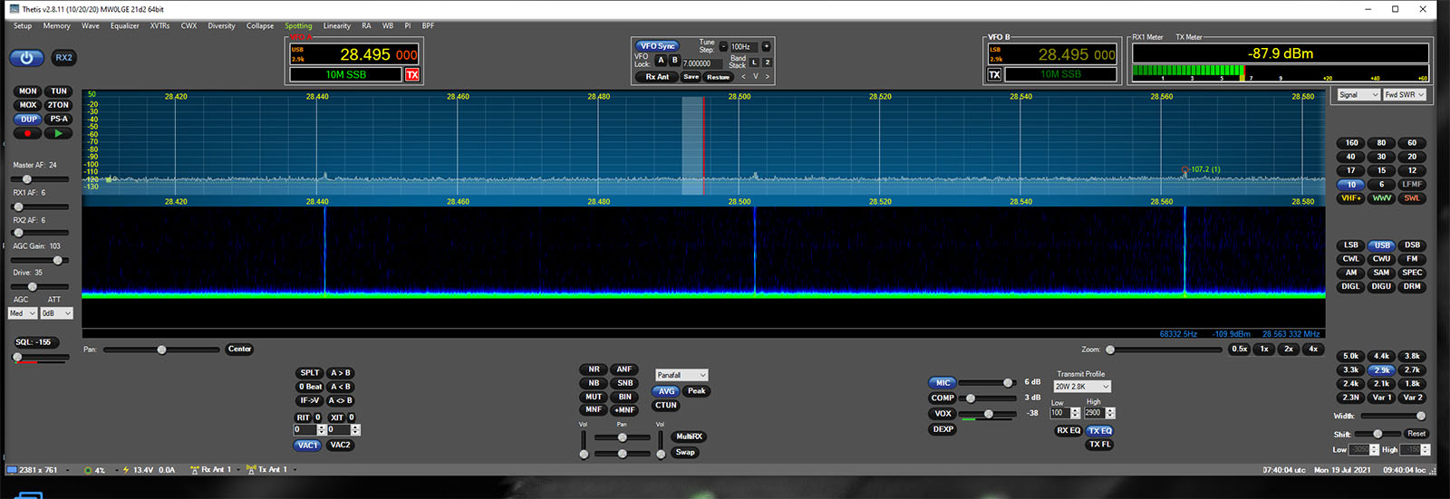

I went back to 21d and it still has problems with mode changes.
You see that it is in USB but the panadaptor shows AM.
I am running the 21d database.
I had the same but it was solved after changing the Bandstack setting for 28.400 to USB

Back to 21d2.
All fixed.
I had to put in the mode and bandwidth AND refresh and lock the frequencies in the bandstacks.
I need to read about this more carefully.
So far so good.
Keep up the excellent work.
I promise to pay more attention before reporting a suspected problem,

Don : ok, I am not sure why the mode highlighted wasn't the one in the pan adaptor through, that should not happen. Just q quick question, is this at startup from a DB update, or was it happening every time you clicked a mode?

It was happening every time when I hit a mode button.
It would sometimes switch but if you were on LSB it wouldn't switch to USB.
After adding the correct mode and bandwidth, everything straightened out.
I am guessing that the band stack info has these parameters stores in it?

yes indeed Don, every entry in the bandstack has zoom, centre frequency for receiver, ctun setting, frequency, mode and filter. I am not sure why you would be seeing a different mode selected to that displayed on the panadaptor though, that needs further investigation, and especially if you click on the mode button.

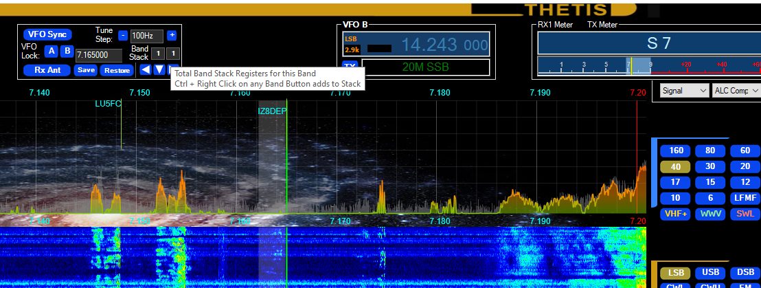

new band-stack:
Ctrl + Right Click does not work.. its now Ctrl + Left Click. So the tooltip should be corrected :-)

I concur with Ernst, in that Ctrl + Right Click does not work.. its now Ctrl + Left Click for new band-stack entry.
However, I believe the code should be corrected, not the tooltip (I assume Ernst was just being facetious, lol).

Code wise it was cleaner to do it on left click. The tool tip got changed ;) I can change it over if enough people think ctrl-right is better than ctrl-left. It will require re-adding right click handlers for all those buttons, on HF, VHF, and GEN panels.
Posted: Sun Jul 18, 2021 11:59 pm
Not a problem, Richie, I was only a bit concerned that folks accustomed to the previous functionality (CTRL Right Click) might get rattled if they haven't been keeping up with the thread.
I'm good, carry on!

Good morning,
ctrl left click is fine, it is more intuitive.
on a right click I would expect a context menu or something.
maybe right click on a band button brings up the bandstack-mngr? ;-)
