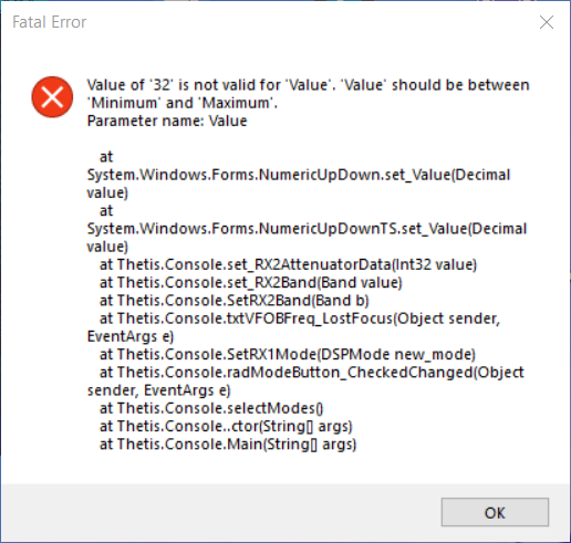

Starting Thetis 2.9.06 this morning coming up with the following fatal error:
Screenshot 2022-05-05 105018.png (122.18 KiB) Viewed 24934 times
What can I do? What is the problem?
Thanks a lot!
73 Georg, DG9FDA
Posted: Thu May 05, 2022 10:35 am
by DG9FDA
Problem solved, corrupted database!
Thanks, Georg DG9FDA

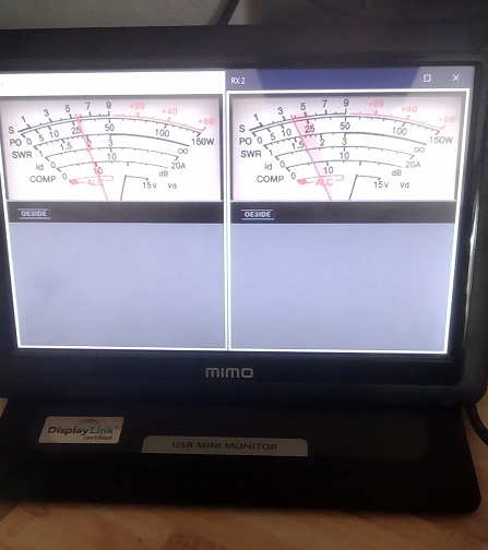

The new meters looking terrific. Thank you guys.
Can we expect other scales and a swr-meter in its own window?
and on my 7" monitor as well.

please send me the database that is causing this

on the kenwood look-a-like, when tx'ing click the meter area to cycle the data in use. btw, in RX they are only displaying SIG_AVG atm.

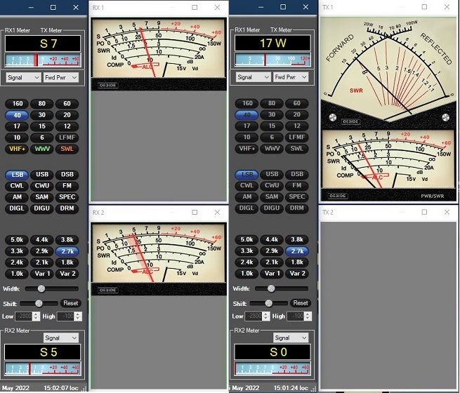

Well, a day of sorting out data to image calibration, so I just had to implement a cross needle meter. The images are thanks to Ernst, OE3IDE.
The meters are fabulous Richie and beautiful art work by Ernst! Thank you for all the effort going into this! Just my opinion here but as a ham who grew up in the analog era of electronics I love the arc and swing of a nice big meter. Major props to you for having the skill to calibrate the multi-meter scales. Amazing!

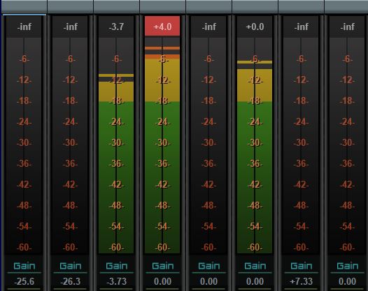

I would love to see something like this in Thetis

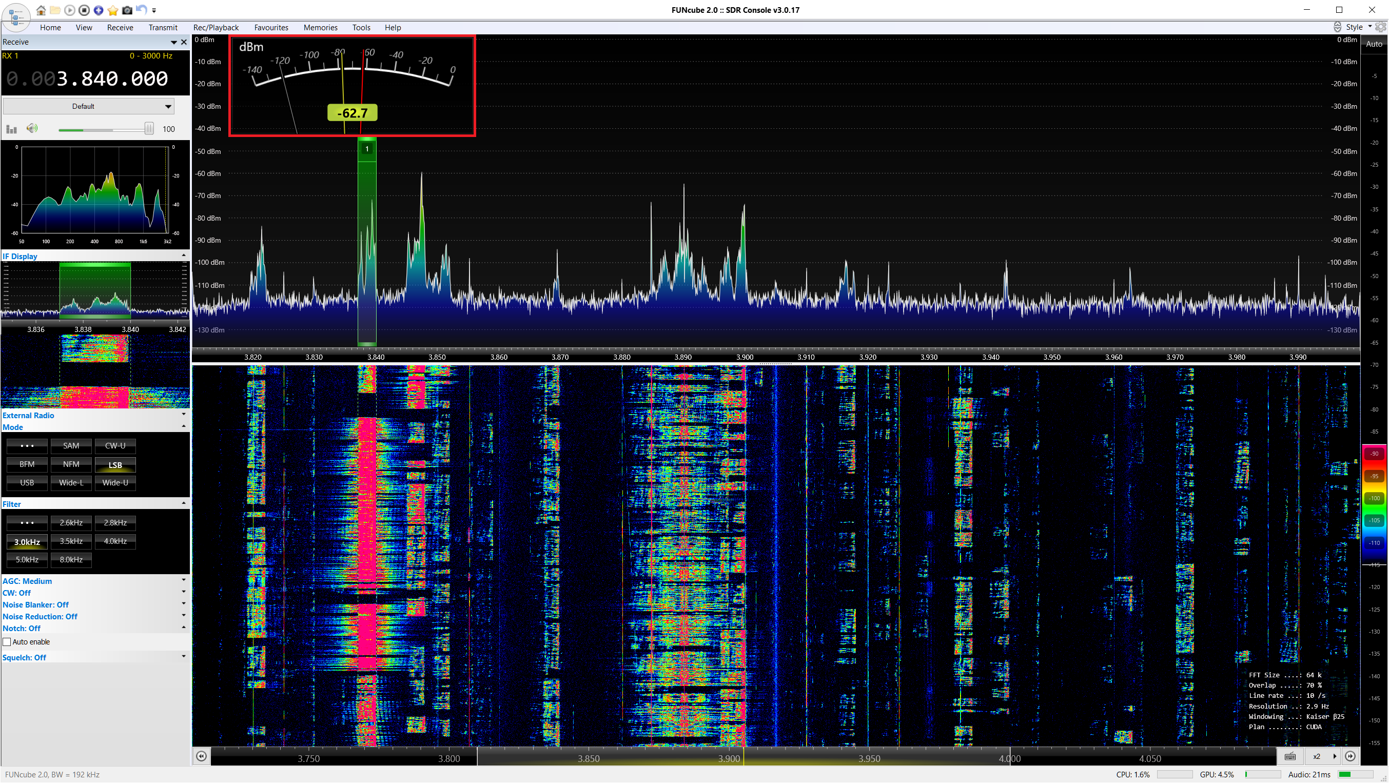

Gary,
Re "real estate", as you noted there is currently lots of unused "dead space" in the lower portion of the console, some of which could be well utilized to house a good-size meter.
Also as an example, here's a screenshot of Simon Brown's S-meter in his SDR Console. Notice how it sits rather unobtrusively in the upper right corner of the spectrum scope. Also note how it has three needles -- peak, instant and noise floor -- lots of info there! It's also resizable.
Lol, I just remembered that screengrab was actually taken to record the horrible splatter of Bill's signal on 3.840. I'll not publish his callsign here but anyone listening stateside in the mornings between 8:00 and 10:00 am Central Time on that frequency can find out for themselves. His signal is very strong, and always that trashy. Positively disgusting!

I'm not sure people are thinking big enough. One need not be limited to one or two dial style gauges, be they old fashioned or ultra-modern.
Here's what, IMHO, would be most useful, something like this:
Where each vertical bar Is user defined/selected to represent the parameter desired and has:
1. An appropriate, easy to read scale.
2. A solid section the top of which indicates the average value, or just the value if there was no separate peak and average information.
3. A bar that floats over the top of the solid section indicating the peak value where available.
4. A numeric readout at the bottom showing the current numeric value and the units they are in (my example has no units--too lazy to Photoshop it).
5. A numeric readout at the top showing the current peak value.
6. A parameter label at the top or bottom (my lazy example shows "Gain", but you get the idea, I hope).
Such an arrangement provides a most efficient use of space while still allowing a large amount of information to be clearly and consistently displayed and understood.
Also:
7. A typical layout need not have a fixed number of bars, but there might be some maximum number allowable.
8. Bars would grow/shrink in width and height to fill the available space in the Window/Windoid/Docker, but there should be some minimum allowable width and height so that they cannot be shrunk infinitesimally small.
9. Scales might become more or less detailed depending on the absolute size of the bar in pixels.
10. Context would NOT change between RX and TX--to do so risks confusion. The more meters allowed, the less important it is to change context.
A typical lineup of bars might be:
MIC, ALC Group, FWD PWR, SWR, S-meter (both avg and peak on the same meter), PBSNR
Bars need not be colorized as in my example, but one could play all kinds of games here. For instance TX related bars might have a different color background than RX related bars, etc.

That's my kind of meter Scott. It looks simple, efficient, elegant and customizable for my individual needs ;)
73, Manny
