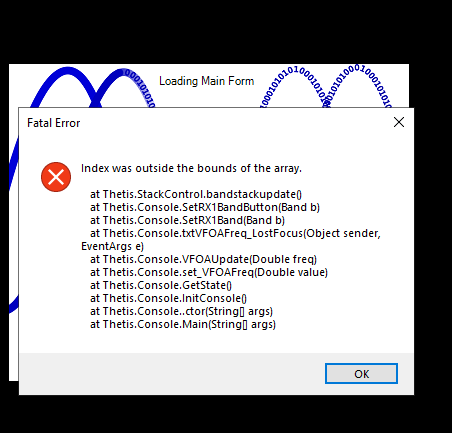

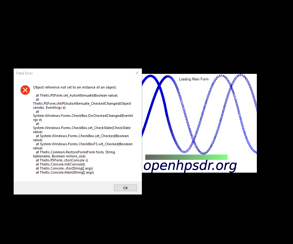

Spoke to soon.
2.6.8 resent D4.
when 160 meter band selected , software halts and gives an array error.
Upon next load of Thetis , software fail's to load.
please see attached.
oxt
2.6.8 resent D4.
oxt

Re: 2.6.8
Gary, can you send me your database.xml file.wa1oxt wrote:Spoke to soon.
2.6.8 resent D4.
oxt
My email is on qrz, or PM me with it.
Cheers
Richie. MW0LGE

Will sent DB.
Other issues here , give me a few hr's
tnx , oxt
tnx , oxt
Re: 2.6.8
Hi Gary, please try : https://www.dropbox.com/s/n2tz1b61y28x6 ... 2.zip?dl=0wa1oxt wrote:Will sent DB.
tnx , oxt
(this exe has also been included in original update post above)

Re: 2.6.8
Yes, that worked .
Thank You
wa1oxt / / garyradio
Thank You

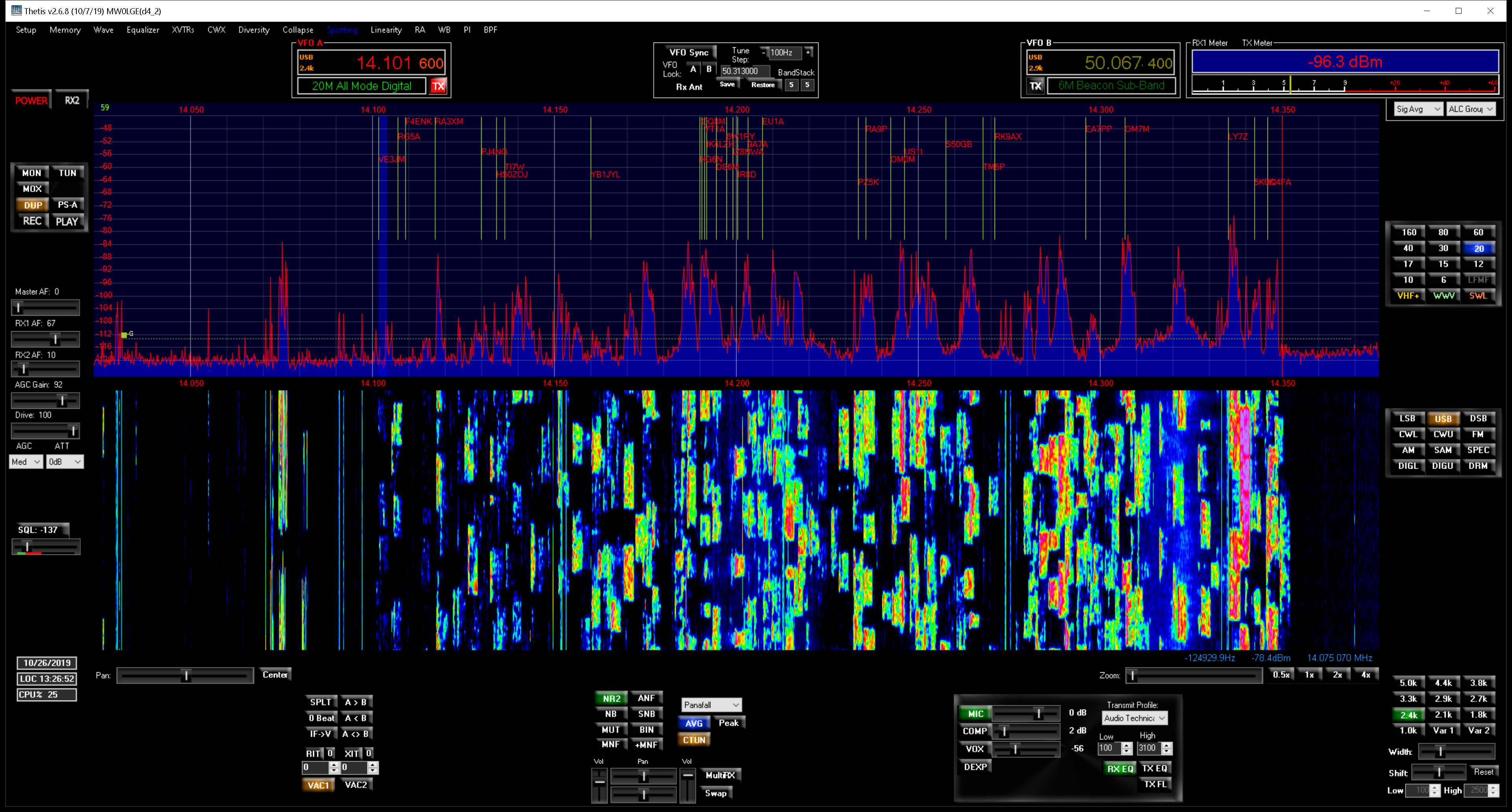

Display looks really good with the contest today on 20m

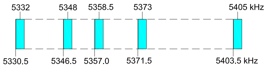

A couple of small bugs to report, and some thoughts about the WB display...
Small bugs:
- With CTUN enabled, occasionally when I switch bands, or when I start up the app, the display will center on the passband instead of on the frequency that it was originally centered on. I don't have an exact sequence to reproduce, I'm afraid.
- The state of Fwd/SWR metering mode for TUN is not being stored and had to be reset every time I start the app.
- 60M band stacks are messed up (I think you know about this one already)
US frequency allocations for 60M are as follows:
Thoughts about WB display:
- The display blanks after resize. Work-around is to close/open the window.
- Window existence is not remembered on start-up (although size and location is). Work-around is to open it manually after start-up.
- It probably needs to be coded up for DirectX.
- It would be very nice if there was a way to pan/zoom the frequency scale, and adjust the amplitude scale. Even if these were just adjustments in a setup window tab that would be a huge improvement.
Thanks, Richie. You continue to make an incredible impact on the usability of Thetis! Saving of current state and settings is now blazingly fast!

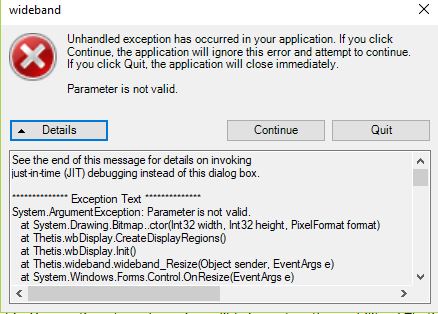

Hi all and Ritchie,
Sorry forget it: Version is now d4-2
I get also the Error on the WB Display, if I make the Window bigger no Problem, but if I make it much smaller it chrashed
with this Window when I minimized the WB Display: It is a long Text, so here only the little Pic.
When I click Quit Thetis closed. After restart Thetis it is not on the Band as before the Crash.
73 Erwin

All issues noted. Have been busy since last release so nothing done, but will look at the problems this week, including some logging around seq errors.

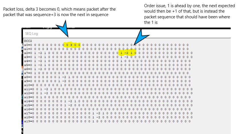

Re: 2.6.8
Hi
In an effort to debug/look at the sequence numbers of inbound UDP packets, I have quickly added a SEQ log window. This is what is happening...
1) every packet coming in for dcc0-7 has a sequence number. A delta from received number vs expected is logged, in a ring buffer of 40 slots. A delta of 0 signifies the packet number received is the one expected
2) whenever there is a seq error, a snapshot of that ring buffer is made, 20 snapshots in total, with the newest being s0
Still work to do on presentation of the info, and being able to switch between delta and packet number. I have used app called 'clumsy 0.2' to simulate problems.

Re: 2.6.8
Hi Bryan, yes it will be. I am seeing loss here from time to time, which undoubtedly is the hotchpotch of switches, 10gbit, 1gbig and 100mbit links in this placeBryan W4WMT wrote:Hi Richie,
Nice work! It will be very interesting to see what the "real world" log will look like after clumsy is turned off and the un-tampered packets are streaming in.
73, Bryan W4WMT
RIchie.

- fix: wideband minimize and resize issues fixed
- add: first pass of SEQ logging, access through Setup->Tests->Show SEQ log button. Just plain text at the moment. Numbers are delta from expected sequence number expected. 40 slot ring buffer per DCC0-7. When SEQ error occurs (ie not expected next in sequence) a snapshot of that buffer is taken. 20 snapshots in total, s0 being most recent.
