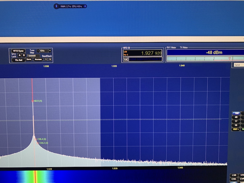

Richie, not sure Im looking at this wrong or not but I would think the DBM on the meter would agree with the blobs. If you look at the screen shot, I was tossing a constant carrier in AM (from my Kenwood 890s) and the meter did not read the same DBM reading as the blobs. Meter shows -48 and blob shows 62.5 . Any thoughts?
- IMG_4013.jpeg (224.73 KiB) Viewed 36877 times
Re: 2.6.9
There is nothing wrong with the software. The panadapter shows the total energy in an FFT bin width. The S-meter shows the total energy in the selected receive passband. The two measurements are not the same.

Re: 2.6.9
Not crazy about that but thanks, did not know that.w-u-2-o wrote:There is nothing wrong with the software. The panadapter shows the total energy in an FFT bin width. The S-meter shows the total energy in the selected receive passband. The two measurements are not the same.

Re: 2.6.9
Yeah, physics sucksw2ner wrote:Not crazy about that but thanks, did not know that.w-u-2-o wrote:There is nothing wrong with the software. The panadapter shows the total energy in an FFT bin width. The S-meter shows the total energy in the selected receive passband. The two measurements are not the same.

It's really funny how a lot of folks just don't intuitively get that when measuring RF energy the bandwidth matters. I've been trying to think of a good analogy but I continue to fail at that, all I can do is fall back on mathematics
Also, folks who are finding this forum and going right to the Thetis sub-forum are missing all of the good old tacked threads that answer these sort of FAQs because they are in the PowerSDR sub-forum. I guess I'll need to make an FAQ sub-forum now when I get a spare few hours!

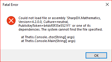

Hi Richie...I was running Thetis v2.6.8 and tried to get v2.6.9 to load and get error message...Can you help me please...Samuel
Here is error message...
Re: 2.6.9
1) make sure SharpDX.Mathematics.dll is in the thetis install folder. This will be the case if you have used Thetis v2.6.8 installer from https://github.com/TAPR/OpenHPSDR-Theti ... tag/v2.6.8 as it is part of the installSamuel wrote:Hi Richie...I was running Thetis v2.6.8 and tried to get v2.6.9 to load and get error message...Can you help me please...Samuel
2) copy all the files from 2.6.9 b6 zip file over the top of the ones in your thetis install folder
