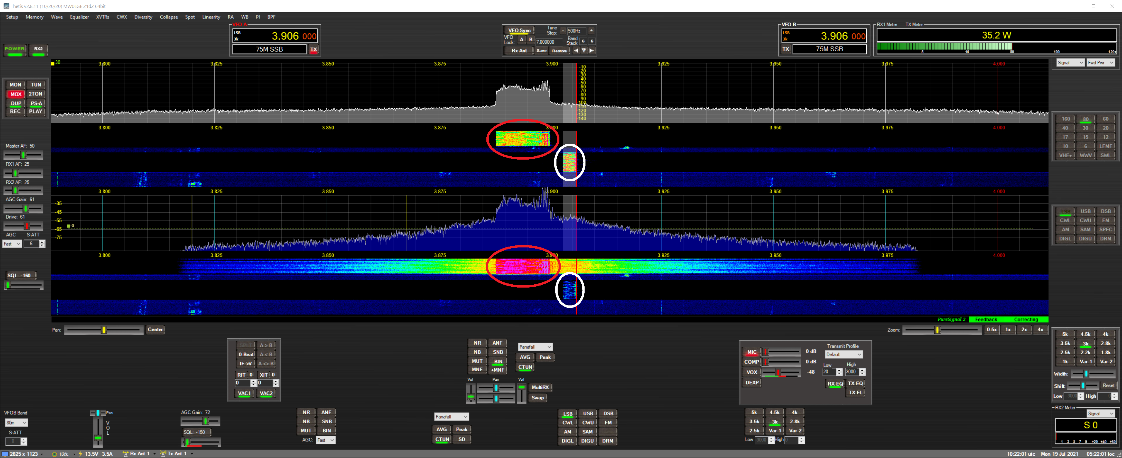

Running 21d2 here on my 7000 DLE MKII, P2 firmware. I'm not sure what the new checkbox "Display PS-RX and PS-TX spectra" in the PureSignal screen is supposed to do, but I'm seeing some very large power levels displayed in the RX2 screen when that box is checked, regardless of the fact that I have "Gnd BPF2 on TX" checked in Settings>General>Ant/Filters>Antenna.
The screenshot below has two different SSB transmissions displayed. The first transmission (in the white ovals) is with the "Display PS-RX and PS-TX spectra" box unchecked. Notice how weak the signal is in RX2 (this is as it should be, because the RX2 prefilter is grounded during TX).
The second transmission (in the orange ovals) is with the "Display PS-RX and PS-TX spectra" box checked. Notice the huge signal strength in RX2 despite the fact that "Gnd BPF2 on TX" is still checked.
In both cases the transmitted power is 61 watts. I'm getting my PS feedback from an external sampler downstream from my linear amp, so I'm really worried about the power that would be sent to RX2 If I were to have my amp switched on!
Also, notice that my VFO transmit frequency is 3.906 MHz, but when the "Display PS-RX and PS-TX spectra" box is checked the panafalls for both receivers indicate that I'm transmitting on 3.900 MHz.
Thank you for all you do for us,

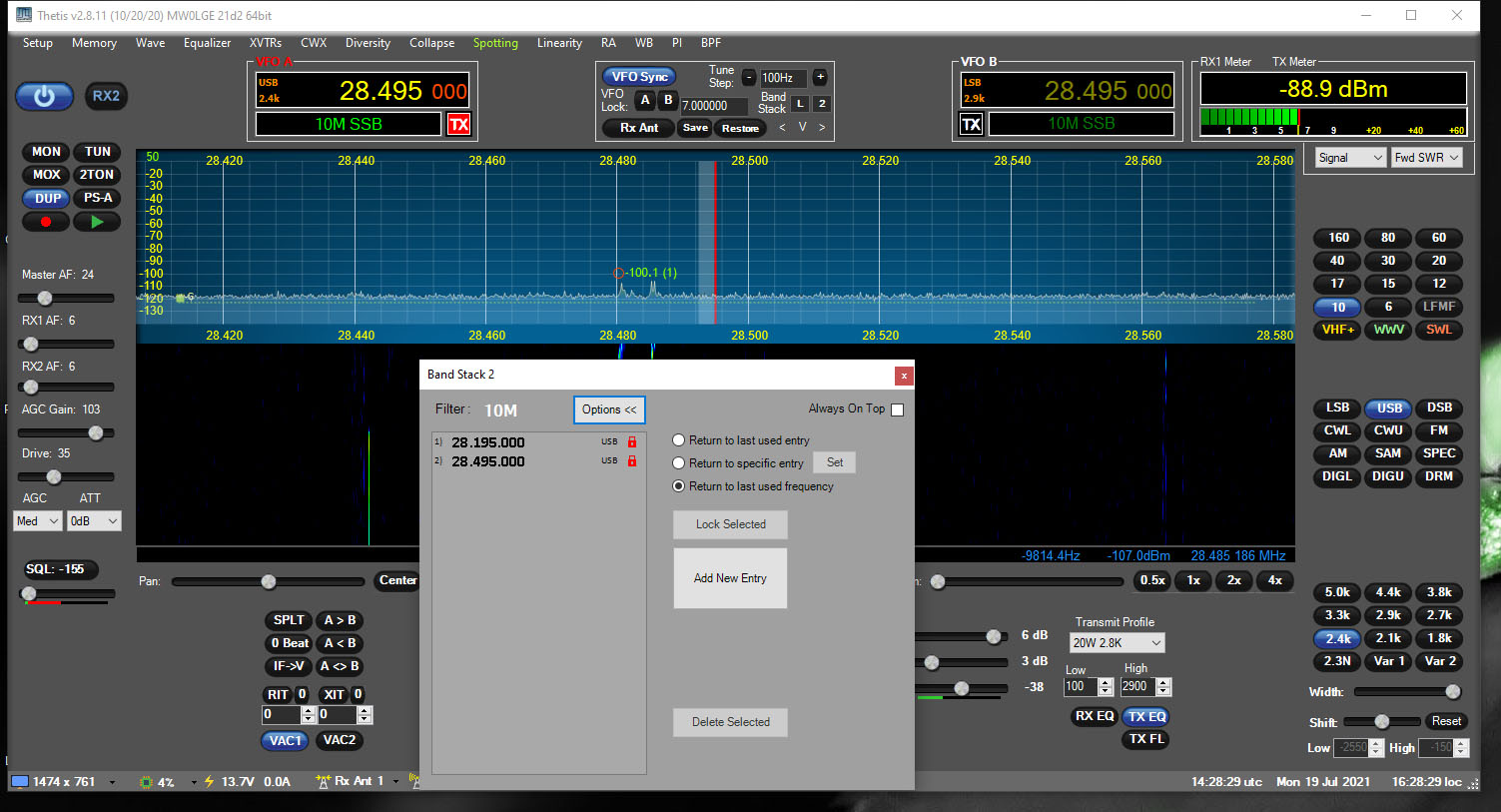

ea3aqr - noted about start up state. Please open up the bandstack window, take screenshot, next to the vfo and panaptor.

ea3aqr - thanks, I will look into it. It is probably fixed now due to the fixes in 21e for mode/filter button section state. That screen shot helped.
EDIT: yep looks resolved in 21e.

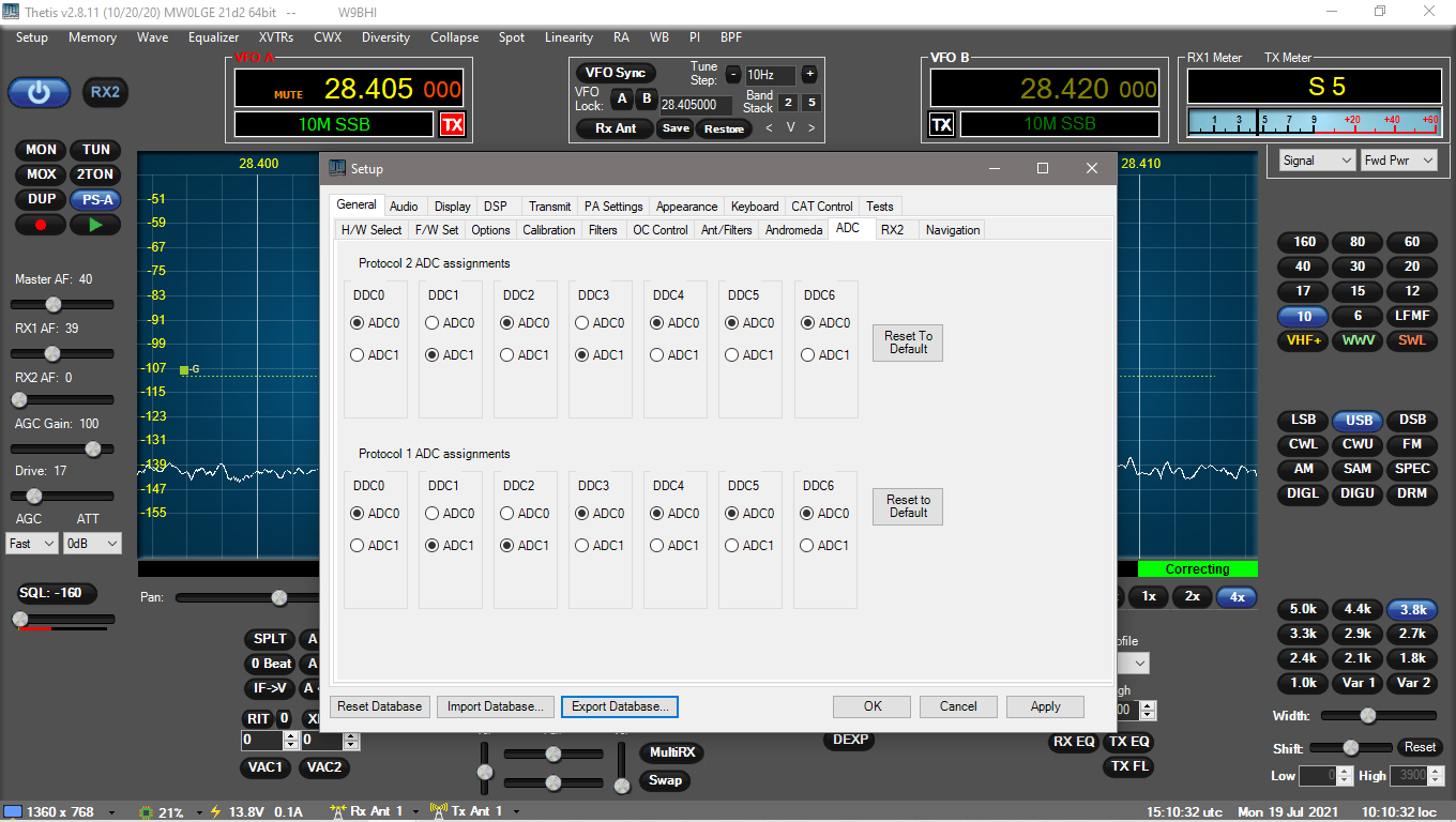

I did a Protocol 2 ADC assignments reset to default and it seems to have fixed the issue I was having with PS.
I am running a blue face 7000DLE. P2, v21d2.
There is a lot of changes from the original 2.11 that I am having to figure out.
Thanks for your patience.

So just for asking, what should the ADC settings be set to?
I have mine set for default.
No diversity being used.
Don
Screenshot (141).png (209.41 KiB) Viewed 20332 times
