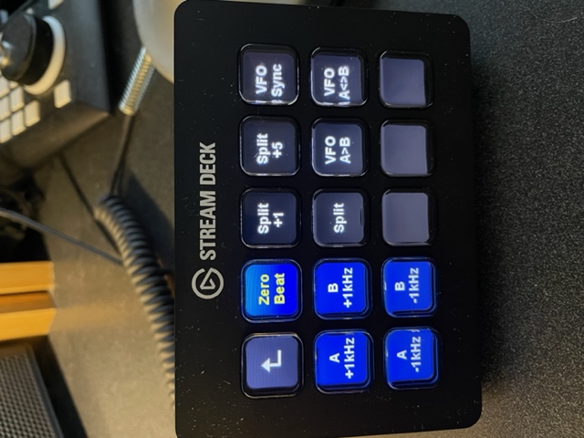

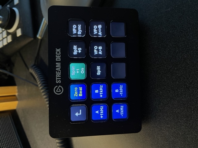

Here's a script I use to activate split for "Up 1" Dx contacts:
echo ZZLB000;ZZLD100;ZZFI02;ZZRS0;ZZSY1;ZZSY0;ZZBP07;ZZSW1;ZZMU1; | ncat 127.0.0.1 13013
What this does:
1) Turn off Rx2 if On;
2) Activate MultiRx;
3) VFO A in left ear;
4) MultiRx in right ear;
5) Set filter bandwidth;
6) Set VFO A>B
7) Set VFO B up +1kHz from VFO A;
8) Set Split for VFO B TX.
If using a Stream Deck, one button can be used to invoke the above commands. Then, a press of the same button resets the "Up +1 kHz" function and restores the receive bandwidth. Restoration of bandwidth is just my preference. When the above macro is invoked on my Stream Deck, the button background color changes from white letters over black to a green background that changes to read "Split +1 On." A second up-split macro is set to +5 kHz which is common for SSB splits.
It doesn't have to be Stream Deck either. Other hardware and software options are available to invoke macro commands.
See images below of the Split button changes.

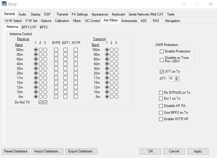

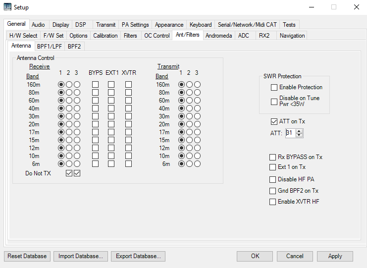

ATT on TX synchronized to PS attenuation
Hello All,
Several weeks passed after I changed Thetis from v2.8.11 to v2..9.0.6.
I report about "ATT on TX" function I didn't expect. Once I set it to 31dB, it becomes e.g., 10dB just after I executed Pure Signal. This 10dB is equivalent of PS attenuation. In v2.8.11 I remember this ATT figure doesn't change regardless of PS execution. Is there any another set-up item to keep this attenuation?
Tokio
JA1CCA
Tokio
JA1CCA
