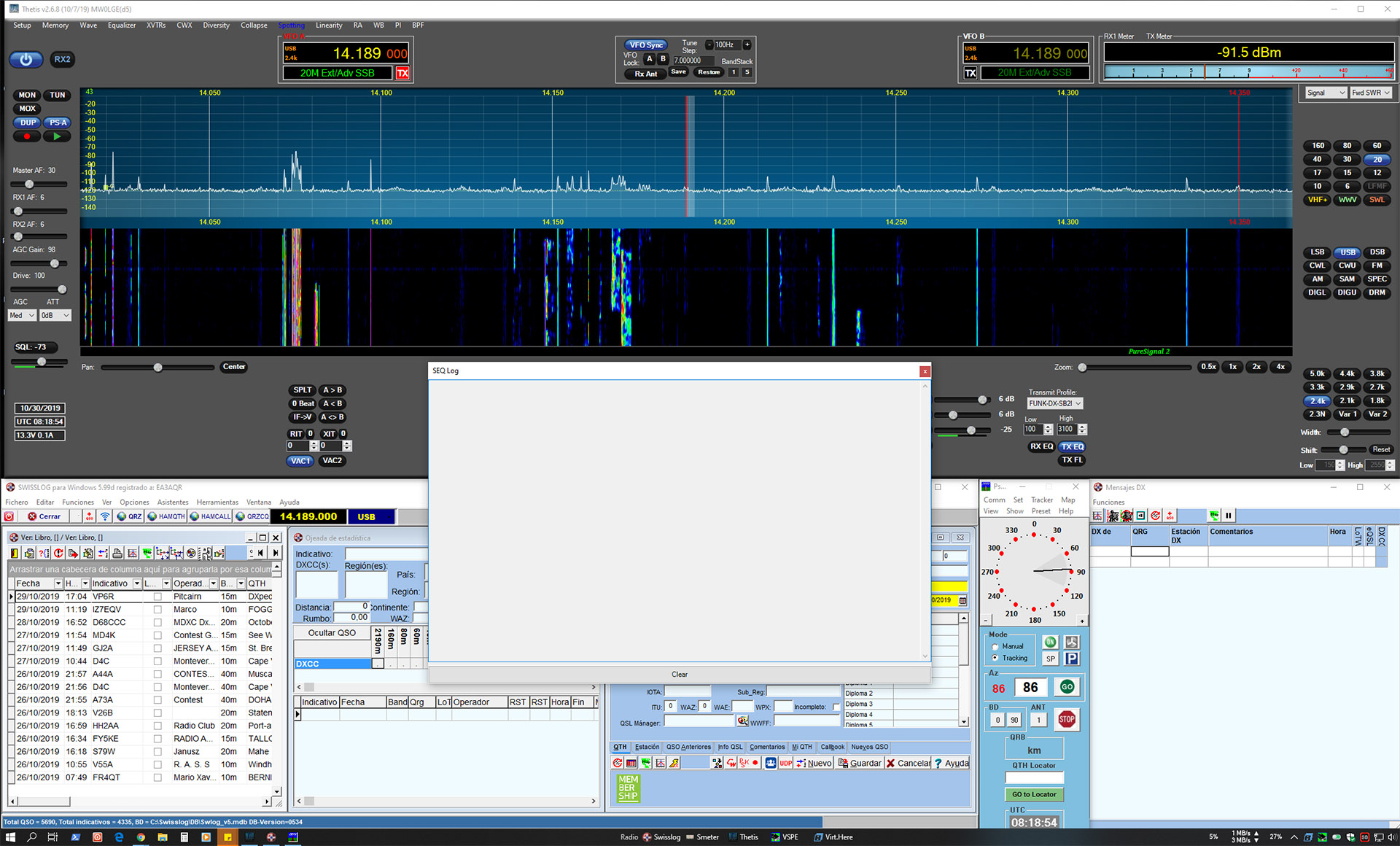

The Seq Log screen is not showing info at all...ramdor wrote:UPDATE

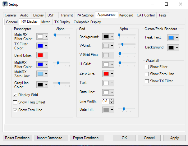

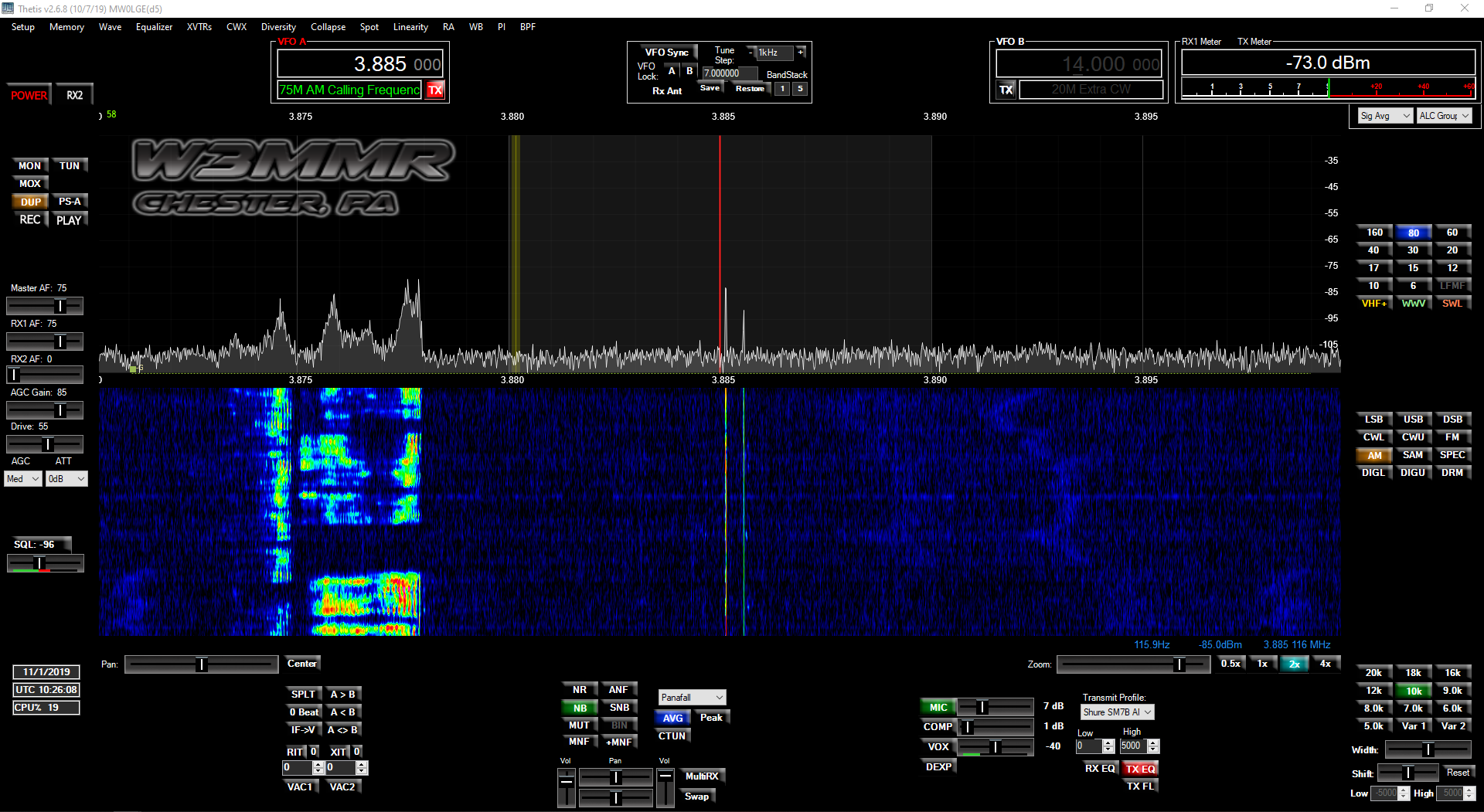

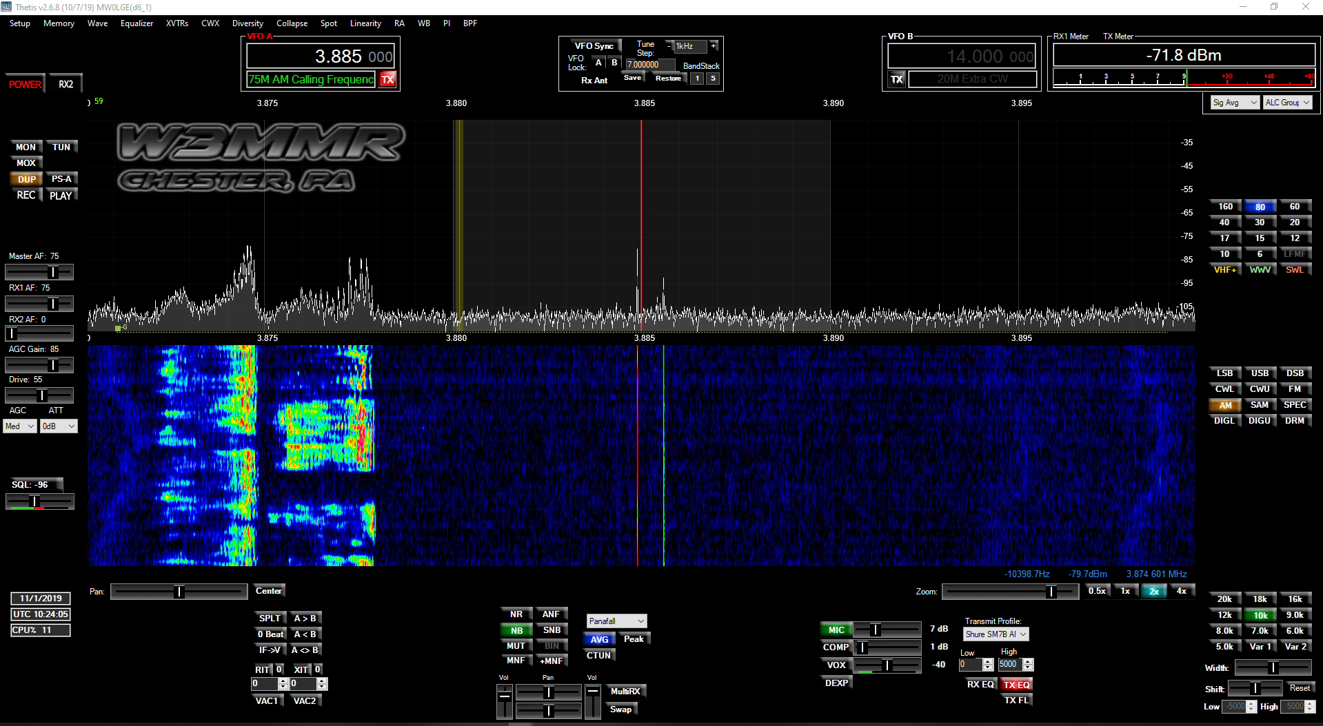

Installed D6 this morning and im having an issue with the data line. #1, its not as "smooth" as the data line in D5, and it looks like the data line when I have GDI+ selected instead of DirectX. But if I have the line size below 1.0, i keep mine on 0.8 normally, it becomes spotty. This used to happen to me if I was to go from DirectX, to GDI+, and back to DirectX. Then closing an reopening the program would always fix it. But now on D6, nothing fixes it. Its all the time, no matter what I try. I tried restarting my PC, powering the radio itself down, and still the same result. Anyone else experiencing this? And yes, i put all the files in the directory this time hi hi
Perry
This is what im talking about This is how it looks in D5, with the same settings. These are my settings
Perry
Re: 2.6.8
Hi Perry,
Yes, this is due to anti-aliasing being disabled. To draw a line narrower than 1 pixel nicely anti-aliasing needs to be enabled. Best you can do at the mo is set line width to 1.0 and pick colour that is dimmer/darker than you really want.
I made the change to bring it into line with the GDI+ display as I disliked the way the line seemed to fade as it became sub 1 pixel wide and gdi+ didn't really do anything below 1.0 anyway. I will add an option to enable/disable anti-aliasing.
