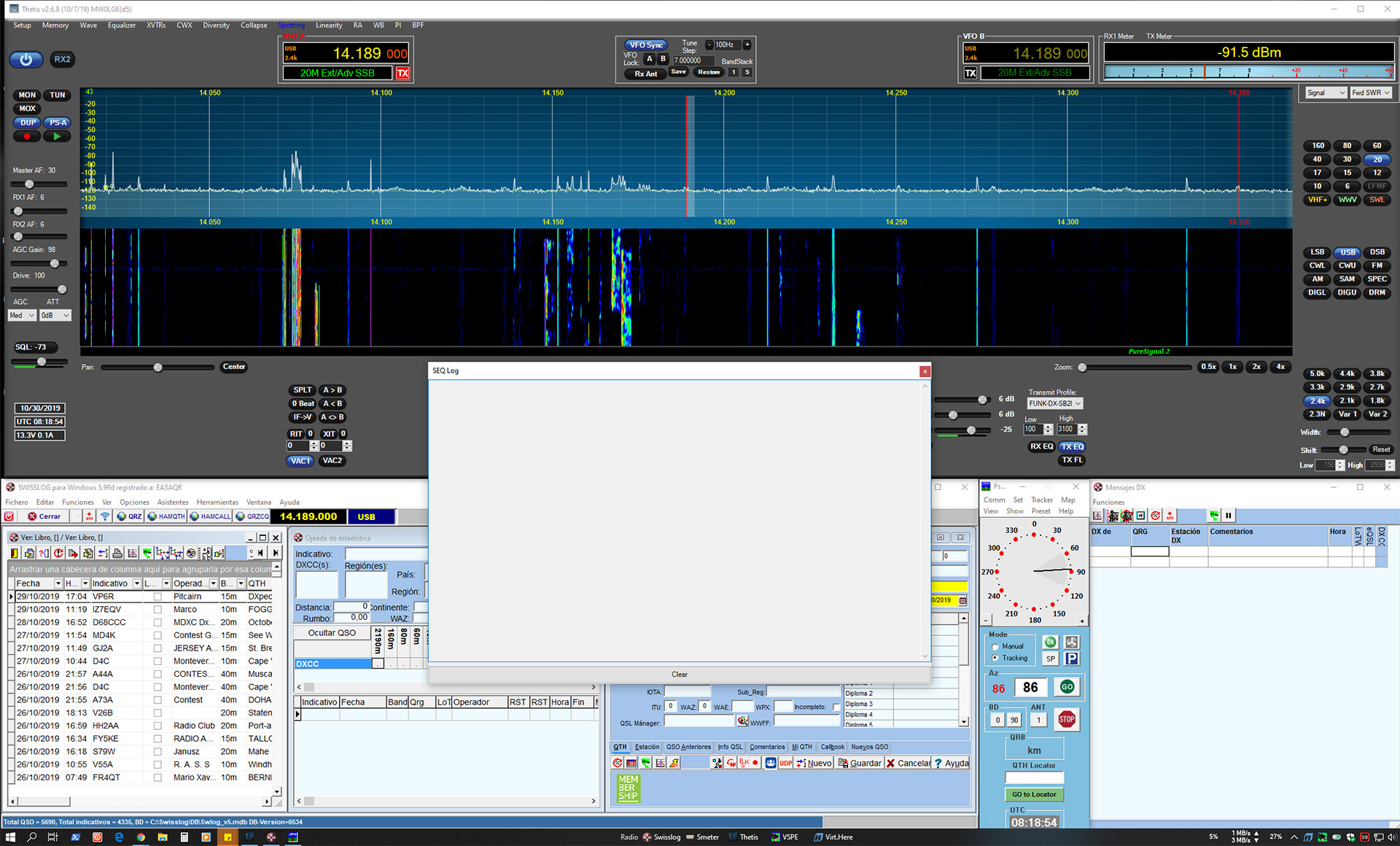

The Seq Log screen is not showing info at all...

Just took a look at the SEQ log after a few hours and its blank. I'm hoping this means no errors :-)

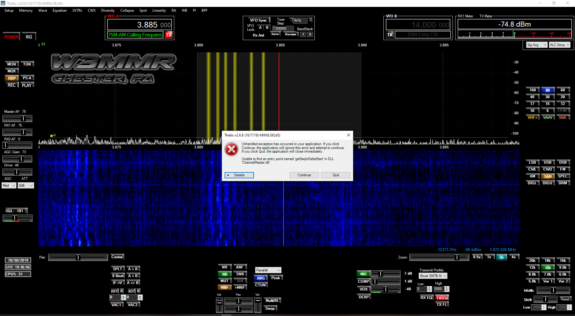

Just installed D5... Anyone else getting this? Besides this, it works fine. I hit "continue" and it seems to pop up every 10 minutes or so.

ok Perry,, did you include channelmaster.dll from the d5 zip? or just the exe?
It looks like you perhaps are getting a rare (10min ish) SEQ error and the front end is trying to get the data from channelmaster.dll

No, I didnt... Sorry about that. Ill include it and get back to you...

you want to include everything that is in the zip, not just parts of it ;)

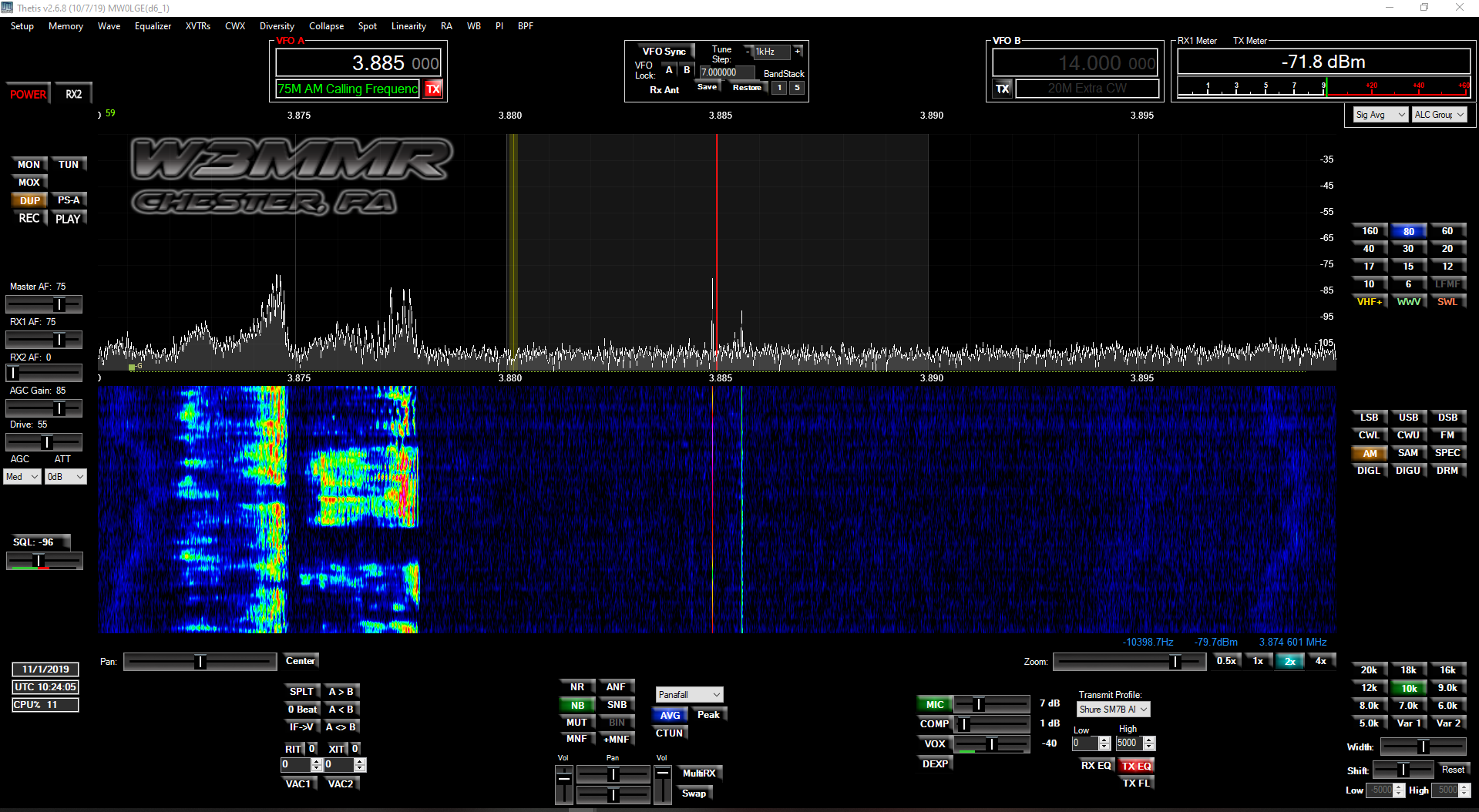

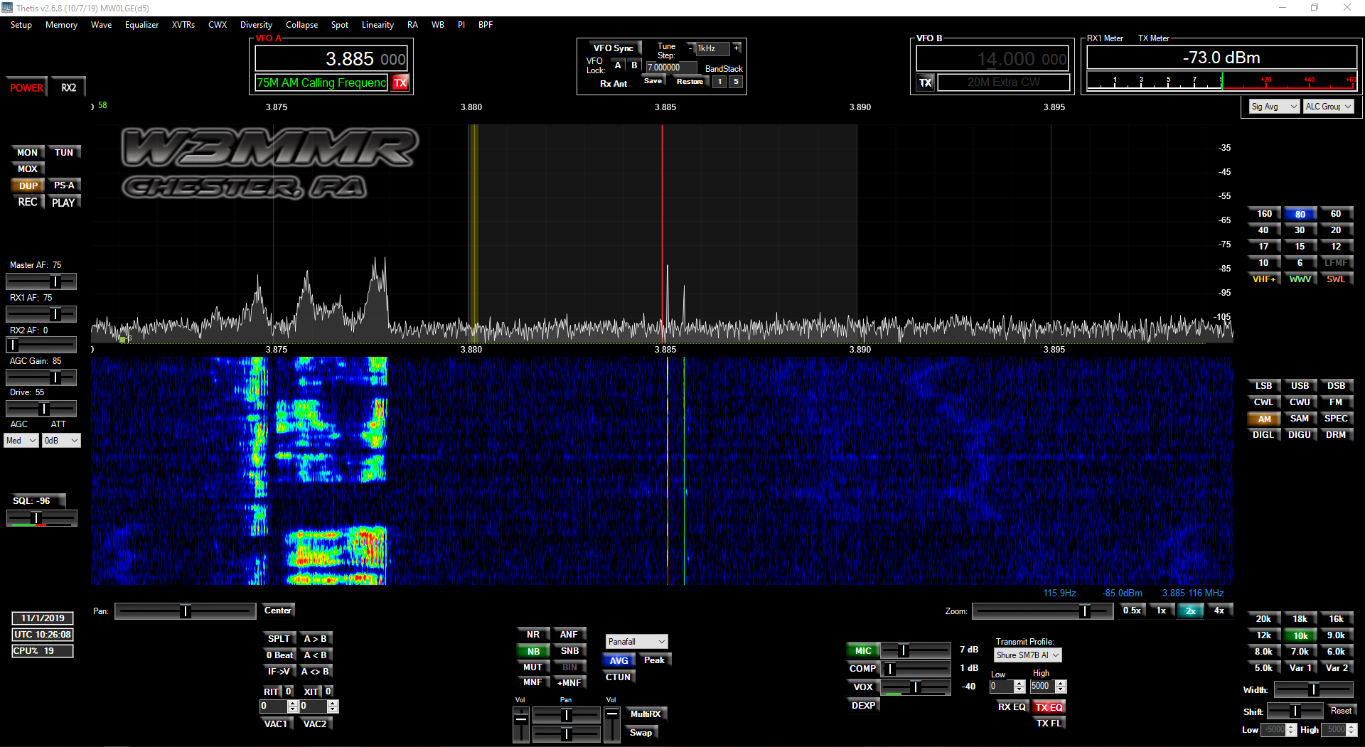

Installed D6 this morning and im having an issue with the data line. #1, its not as "smooth" as the data line in D5, and it looks like the data line when I have GDI+ selected instead of DirectX. But if I have the line size below 1.0, i keep mine on 0.8 normally, it becomes spotty. This used to happen to me if I was to go from DirectX, to GDI+, and back to DirectX. Then closing an reopening the program would always fix it. But now on D6, nothing fixes it. Its all the time, no matter what I try. I tried restarting my PC, powering the radio itself down, and still the same result. Anyone else experiencing this? And yes, i put all the files in the directory this time hi hi :)
Perry
This is what im talking about
This is how it looks in D5, with the same settings.

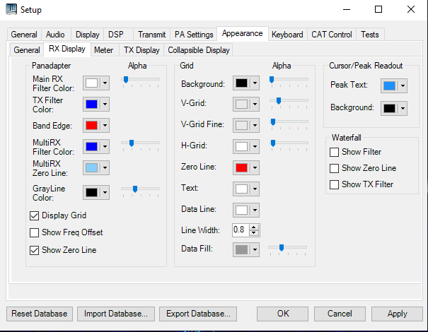

These are my settings
Re: 2.6.8
Posted: Fri Nov 01, 2019 11:22 am
Hi Perry,
Yes, this is due to anti-aliasing being disabled. To draw a line narrower than 1 pixel nicely anti-aliasing needs to be enabled. Best you can do at the mo is set line width to 1.0 and pick colour that is dimmer/darker than you really want.
I made the change to bring it into line with the GDI+ display as I disliked the way the line seemed to fade as it became sub 1 pixel wide and gdi+ didn't really do anything below 1.0 anyway. I will add an option to enable/disable anti-aliasing.
