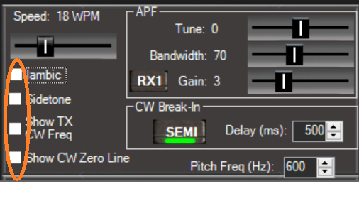

As for the stereo box .... this also applies to the CW selections ;) (pict)
CW selections.png (57.42 KiB) Viewed 21769 times

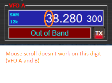

Hi, i'm not sure if this has worked before.... can't scroll this digit with the mouse wheel.
regards, Leon
Digit scroll.png (27.79 KiB) Viewed 21619 times
rbduck
Posts: 350
Post by rbduck »
PD3LK wrote:Hi, i'm not sure if this has worked before.... can't scroll this digit with the mouse wheel.
regards, Leon
That has not worked since I started with Thetis 2.6.9.
I've never seen that scroll forward or backward. Only the digit just before the decimal.

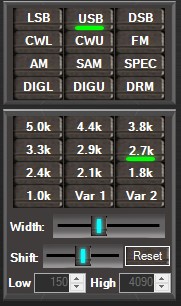

Report for 21D4 64 bit on 7000 P2:
-<CTRL> pressed at program start prevents program to start
- Stereo check sign is now OK.
- Still issues on USB and LSB default filter width on RX1 after a reset press. RX2 seems OK (see pictures)
RX1-2.7k USB.jpg (23.64 KiB) Viewed 21725 times
RX2-2.7k USB.jpg (15.46 KiB) Viewed 21725 times
