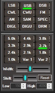

Posted: Mon Jul 19, 2021 7:42 pm
by PD3LK
ramdor wrote:ok you think this might a problem at the import stage? I will go check in there to see if existing filters are copied over. I wonder if ea3aqr did that this time as well? Although, tbh, the old tables no longer exist if importing from anything 21d onwards.
Also, I missed the damn flat style for the vacstereo..... :lol:
Richie, take your time and many thanks for what you did in such a short time.
As for the stereo box .... this also applies to the CW selections ;) (pict)

Report for 21D4 64 bit on 7000 P2:
-<CTRL> pressed at program start prevents program to start
- Stereo check sign is now OK.
- Still issues on USB and LSB default filter width on RX1 after a reset press. RX2 seems OK (see pictures)
RX1-2.7k USB.jpg (23.64 KiB) Viewed 21754 times
RX2-2.7k USB.jpg (15.46 KiB) Viewed 21754 times
