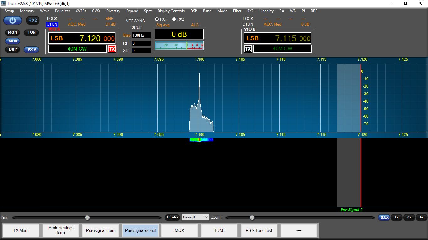

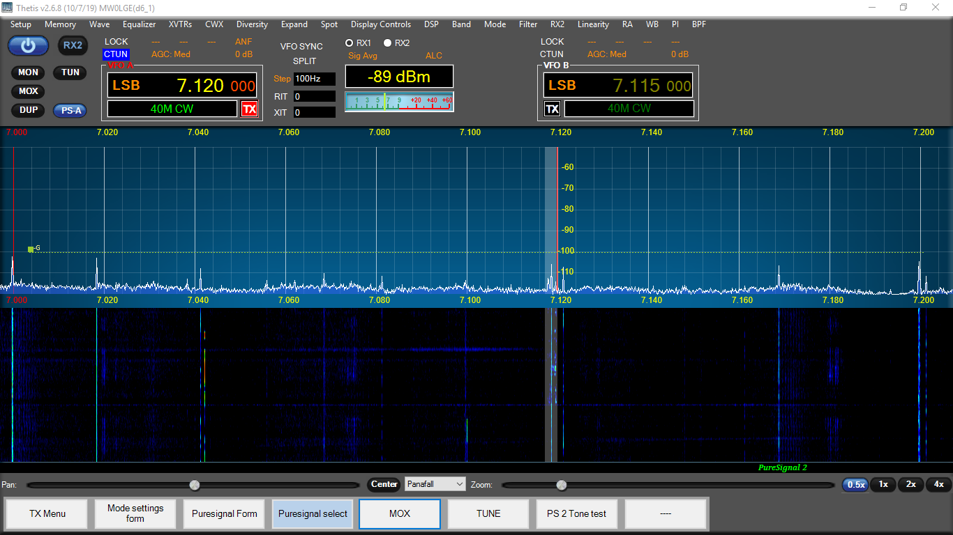

small issue to report.
In Andromeda (Top and bottom enabled) having CTUN enable and switching to TX the display changes and displays TX on a different frequency.
See attached screeners.
BTW LOVE THE INTERFACE !!! Slick and modern!
Cheers,
Hauke

Can you provide steps to get this to happen?devnull wrote:small issue to report.
Cheers,
Hauke
Cheers Richie.

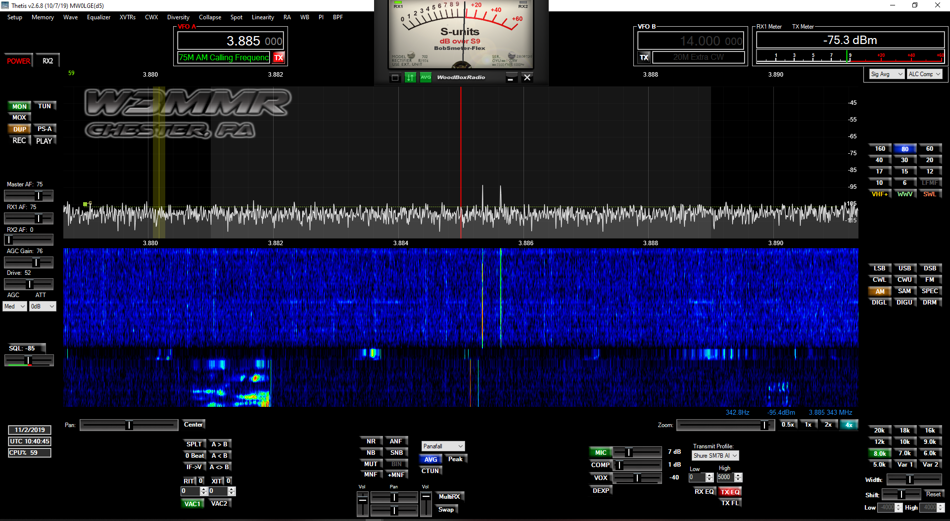

Thanks Richie. The data line with anti-aliasing disabled is not nearly as smooth, and this is above a 1.0 line size, as it is when enabled. The data line with it disabled, looks like the data line when I have GDI+ selected. Anyway, thanks for putting in an "on/off" switch hi hi.
I enjoy it much better with it enabled and DirectX selected. And I want to thank you again Richie for all the work you're putting into this. Keep up the great work!
Now its hard to really see what I mean, just from the small attachment sizes, but they're definitely different.
DirectX, 1.0 Data Line Size GDI+ 1.0 Data Line Size
Re: 2.6.8
yes with it on direct x can do sub pixel lines, personally I prefer it off, and 1.0 line thickness but the option is there now. It is amazing the impact it has on GDI+ frame rates. The following are with 1.0 line width.W3MMR wrote:Thanks Richie. The data line with anti-aliasing disabled is not nearly as smooth, and this is above a 1.0 line size, as it is when enabled. The data line with it disabled, looks like the data line when I have GDI+ selected. Anyway, thanks for putting in an "on/off" switch hi hi.I enjoy it much better with it enabled and DirectX selected. And I want to thank you again Richie for all the work you're putting into this. Keep up the great work!
DirectX AA On (MSAA=1 AM=Per-primitive) DirectX AA Off (MSAA=1 AM=Per-primitive)
