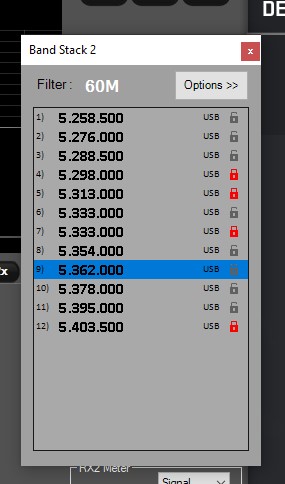

W9BHI
Posts: 146
Location: Serena Il.
Post by W9BHI »
loaded 21d5.
If you lock the bandstack entries and close Thetis, when you start Thetis again, all of the bandstack entries are now unlocked.
Same as it was in d4.
Don W9BHI
Posts: 1596
W9BHI wrote:loaded 21d5.
Don W9BHI
how are you starting it? with ctrl held or something? or another point, how are you closing it? and has the DB got write access?
Always worked for me. I might have noticed if the red padlocks didnt show :o
WWV are all locked, as are 60m on US for example. A shutdown/restart after locking a load ......
W9BHI
Posts: 146
Post by W9BHI »
I close it with the X in the upper right corner.
I open it by double clicking on the Thetis icon.
This time I locked the bandstack entries and then did an apply at the bottom of the setup form.
I closed Thetis and then restarted.
Now all of the bandstack entries are still locked.
Your guess is as good as mine.
Don W9BHI
W4WT
Posts: 173
Location: Cumming, GA
Post by W4WT »
I see what could be a problem. I would think that "Force" on the Audio tab would be saved by profile but it appears to not do that for me. I have a digital mode profile where I use Force but don't use it with SSB or CW. I tried to save Force either set or not depending on profile but it stays the same regardless of profile selected. I think the state should be saved to the profile like virtually everything else in the Audio tab.
I'm running a 7000 black , protocol 2, and am now using "21d5". I believe this has always worked this way.
Joe W4WT
