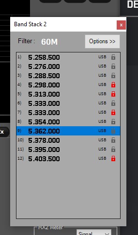

by W9BHI
Just an observation, when upgrading to new versions of software, the band stack info is still there but everything that was locked is now defaulted to unlock status.
Don W9BHI

Posted: Tue Jul 20, 2021 10:26 pm
W9BHI wrote:Just an observation, when upgrading to new versions of software, the band stack info is still there but everything that was locked is now defaulted to unlock status.
Don W9BHI
from old band system, locked state should now be imported. This was not being done before.
lock state of existing entries from the new system to should imported with their lock state intact already
edit: this will reset if you change region/extended at any time

by W9BHI
loaded 21d5.
If you lock the bandstack entries and close Thetis, when you start Thetis again, all of the bandstack entries are now unlocked.
Same as it was in d4.
Don W9BHI
Posted: Tue Jul 20, 2021 11:47 pm
W9BHI wrote:loaded 21d5.
Don W9BHI
how are you starting it? with ctrl held or something? or another point, how are you closing it? and has the DB got write access?
Always worked for me. I might have noticed if the red padlocks didnt show :o
WWV are all locked, as are 60m on US for example. A shutdown/restart after locking a load ......
Posted: Wed Jul 21, 2021 12:02 am
by W9BHI
I close it with the X in the upper right corner.
I open it by double clicking on the Thetis icon.
This time I locked the bandstack entries and then did an apply at the bottom of the setup form.
I closed Thetis and then restarted.
Now all of the bandstack entries are still locked.
Your guess is as good as mine.
Don W9BHI
