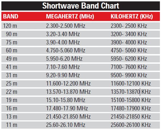

Hi, some band-border issues. Maybe these where already there but i just noticed them today.
- i tried to add 198 kHz (BBC) into the LW/MW bandstack but everything below 200 kHz jumps wrongly to the 160m band.
LW = 148.5 - 283.5 kHz
- every frequency between 4 Mhz (end of 80m) and 5.1Mhz is wrongly seen as 61m BC band
61m band (60m) = 4.750 - 5.060 kHz
- 60m amateur band is skipped when vfo tuning (band button doesn't lit up)
There's possibly more. I think these borders are hardcoded in the software but it would be better if users can adjust them in the future. Also to adjust them to there own region. (I.e. overhere 80m stops at 3.8 khz not 4 kHz).

- Shortwave bands.jpg (60.51 KiB) Viewed 22372 times

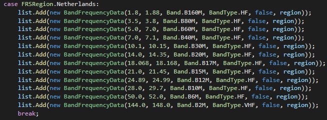

Below are the entries that the Netherlands will be using. It will eventually all be moving to an xml file, or overridden by one.
EDIT: it looks like 0.198 will get put into 160m band if using extended. That is the way it worked previously. Perhaps not what should happen

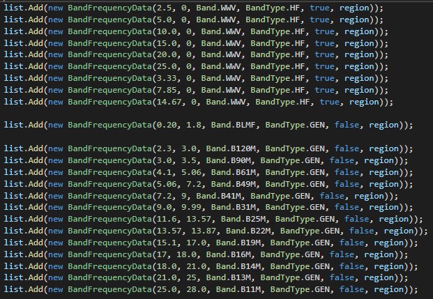

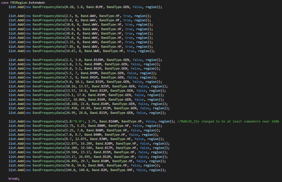

and as a follow up, this is when the extended option is turned on in settings. Note, that when fitting a frequency to band it runs down these lists from top to bottom, and takes the first that fits. It used to be a massive If/else statement, some 6500 lines !!!!! It was impossible to change/administer anything in there.
yeah just ignore anything but the latest. All that was stripped out until I get a moment to re-work through.I2NOY wrote:Hi, I checked yesterday d4 and attenuators (0, -10, -20 and -30 dB) act differently on S-meter, FFT and waterfall, from RX1 and RX2.

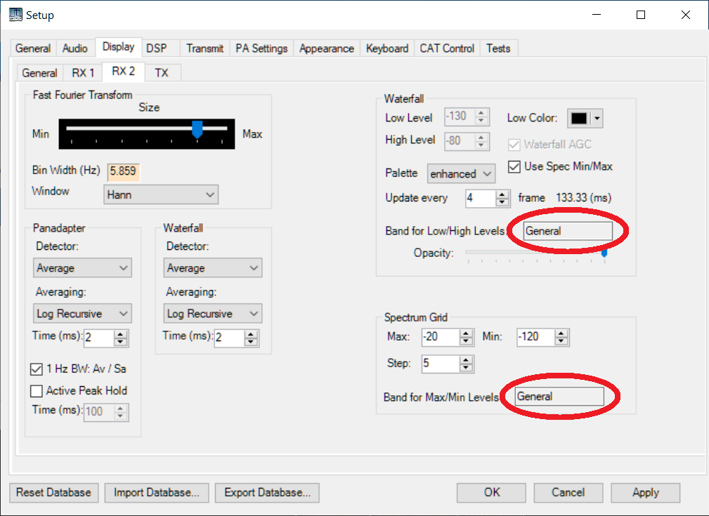

Running 21d6b on a 7000DLE black case, Protocol 2, Windows 10
When I'm running dual receivers (VFO's synced) the RX2 Display Settings screen doesn't correlate to the band I'm operating in. The pic below was taken while I was operating on 80 meters but the band referenced in the RX2 Display Settings screen is "General" (BCAM). Changing bands in the session doesn't change the band referenced in the RX2 Display Settings screen.
I had noticed the same thing here last night, but didn't bother to report it as I had not regressed to earlier versions to see when it changed. But had not caused any issues yet, or wasn't yet convinced it was an issue.K1LSB wrote:When I'm running dual receivers (VFO's synced) the RX2 Display Settings screen doesn't correlate to the band I'm operating in.
Thanks Mark, typeo (copy paste problem) in there. Will sort it this evening. Just had a quick look.

Many thanks for your time and reply Richie.ramdor wrote:and as a follow up, this is when the extended option is turned on in settings. Note, that when fitting a frequency to band it runs down these lists from top to bottom, and takes the first that fits. It used to be a massive If/else statement, some 6500 lines !!!!! It was impossible to change/administer anything in there.
I see what you mean, i have Extended off now: everything < 200 kHz is within the bandstack part "GEN" but there's not a GEN band button to lit up.
A change in the future seems logical, seperate bandstacks & bandbuttons for LW and MW with there correct boundaries but this doesn't have prio for now so i'll set a reminder for this under "wishes". r/Leon
yeah it is moving towards that slowly. I am planning on making a new band grid, that can be setup with your own filters, defaulted to some norm of course. Lack of time this week, but should be fine next week to spend some decent time on things.PD3LK wrote:Many thanks for your time and reply Richie.ramdor wrote:and as a follow up, this is when the extended option is turned on in settings. Note, that when fitting a frequency to band it runs down these lists from top to bottom, and takes the first that fits. It used to be a massive If/else statement, some 6500 lines !!!!! It was impossible to change/administer anything in there.

- PSform Button Advance: Black Text on black background.
- Setupform/Display/RX2: Band indication is fixed on random Band.
Settings are applied global to all bands. - Console:
