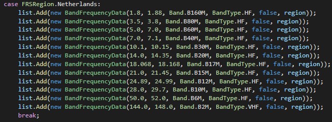

Hey Leon,
Below are the entries that the Netherlands will be using. It will eventually all be moving to an xml file, or overridden by one.

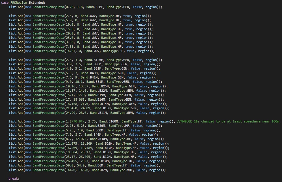

EDIT: it looks like 0.198 will get put into 160m band if using extended. That is the way it worked previously. Perhaps not what should happen ;)
Posted: Thu Jul 22, 2021 12:09 pm
and as a follow up, this is when the extended option is turned on in settings. Note, that when fitting a frequency to band it runs down these lists from top to bottom, and takes the first that fits. It used to be a massive If/else statement, some 6500 lines !!!!! It was impossible to change/administer anything in there.

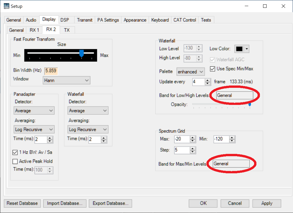

Running 21d6b on a 7000DLE black case, Protocol 2, Windows 10
When I'm running dual receivers (VFO's synced) the RX2 Display Settings screen doesn't correlate to the band I'm operating in. The pic below was taken while I was operating on 80 meters but the band referenced in the RX2 Display Settings screen is "General" (BCAM). Changing bands in the session doesn't change the band referenced in the RX2 Display Settings screen.
Posted: Thu Jul 22, 2021 2:08 pm
by NC3Z
K1LSB wrote:When I'm running dual receivers (VFO's synced) the RX2 Display Settings screen doesn't correlate to the band I'm operating in.

Thanks Mark, typeo (copy paste problem) in there. Will sort it this evening. Just had a quick look.

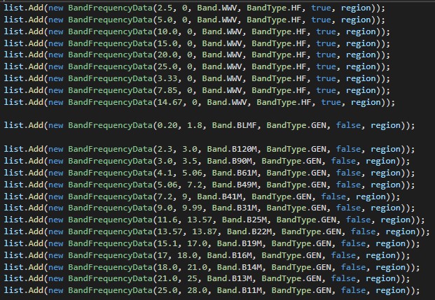

I have put up all the band related stuff on a sheet for now. Perhaps a look at that lot to see what needs changing/swapping. Also keep in mind that this is the same way that old band decision was made, but instead 6000+ lines of If/Else.
https://bit.ly/3BwESZ1
Remember, Thetits works down the list for each region, and will return the band that first surrounds the frequency in question.
