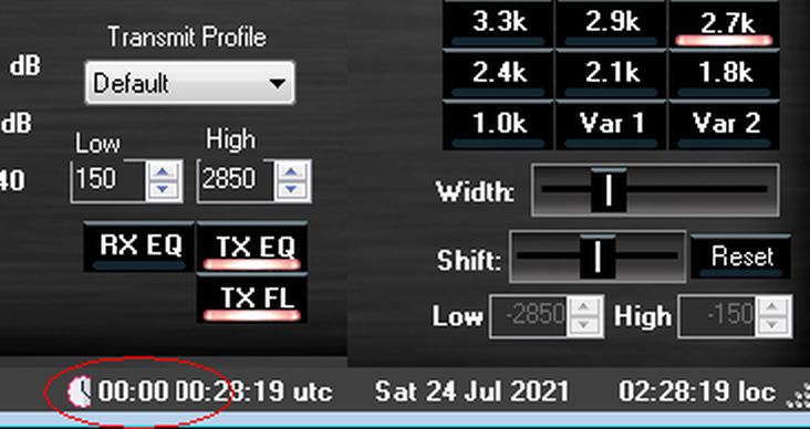

Just a cosmetic one.
Posts: 1595

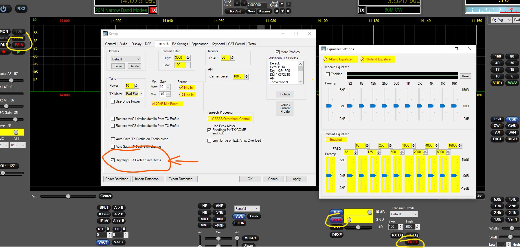

Added an option to highlight everything everywhere that is included in a TX profile. Figured it might be of use, at least so we can work out if too much/too little is being stored against them.

ramdor wrote:Added an option to highlight everything everywhere that is included in a TX profile. Figured it might be of use, at least so we can work out if too much/too little is being stored against them.

add: option to highlight anything that is stored as part of a TX profile

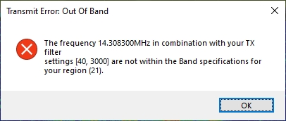

Just noticed this bug. I tried to transmit on 14.308,8 and get this msg (I get this msg on all ham bands)
