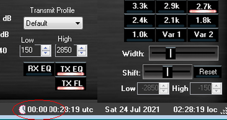

Just a cosmetic one.

There is a problem starting to surface with the status bar. So much stuff has been put there, from antenna selections to andromeda warnings, the designer can no longer arrange it nicely automatically for some reason. Time to get the prodding stick out ;)

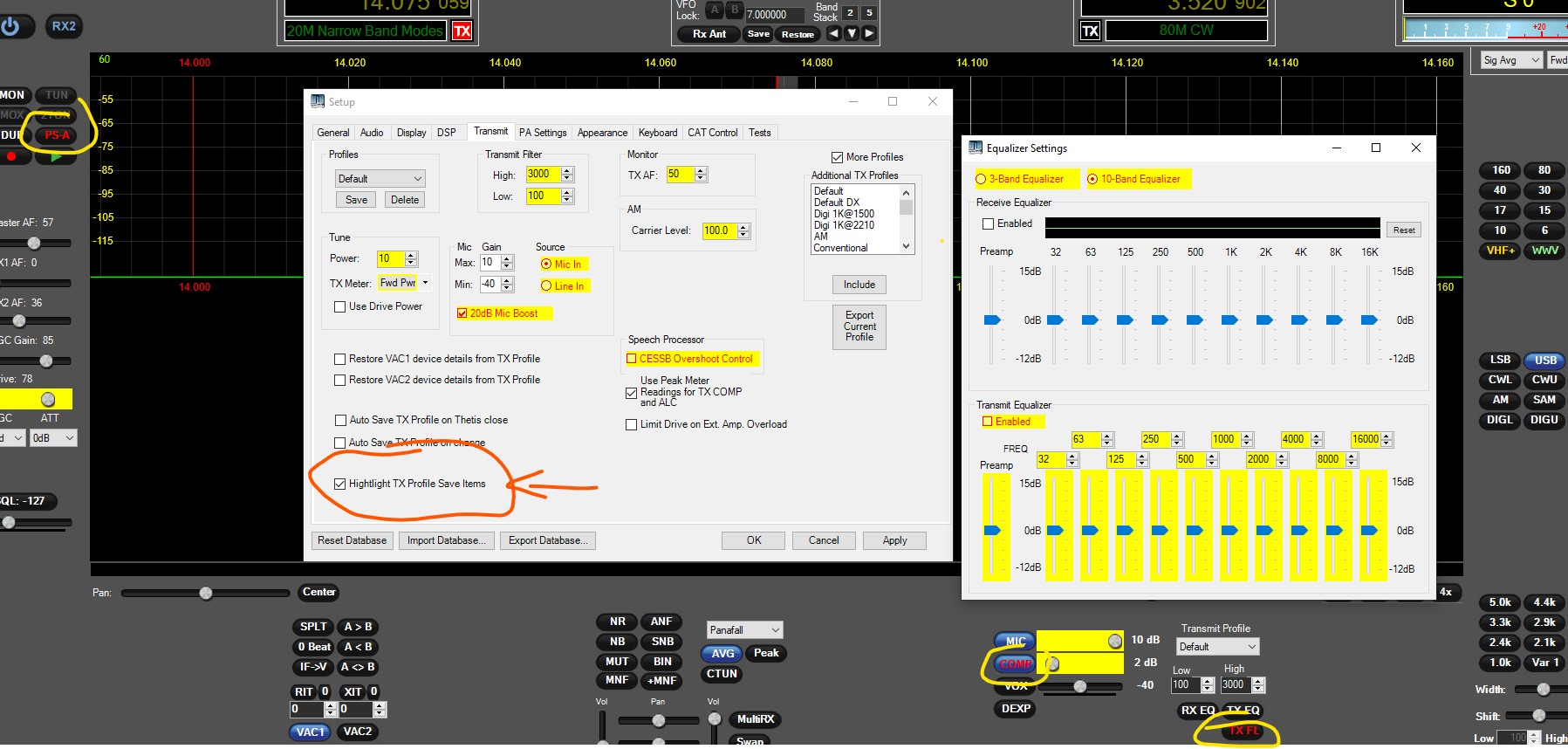

Posted: Sat Jul 24, 2021 6:18 pm
Added an option to highlight everything everywhere that is included in a TX profile. Figured it might be of use, at least so we can work out if too much/too little is being stored against them.
There may be a 21e version out at the end of the weekend which has a couple of features and fixes.

ramdor wrote:Added an option to highlight everything everywhere that is included in a TX profile. Figured it might be of use, at least so we can work out if too much/too little is being stored against them.
Now that is very interesting. WIth the updates and features you have offered recently has had me learning things I wasn't aware of. Some things I thought I knew how functioned , but discovered I had it all wrong. Other things I didn't even have a clue. I believe when I see this feature I'm going to discover a little of both. That is what I love about this hobby and specifically the Apache Anan/ Thetis combinination.
I think I am aware of everything in setup that relates to the Transmit Profile. I guess I'll find out.
Thank you Richie.

one small cosmetic (not new in 21e):
Can you pls remove the text-label in the buttons.
Currently the skin-png's for these buttons must have a quite large symbol on it, to cover the text < V >
Image 14.jpg (23.35 KiB) Viewed 22094 times

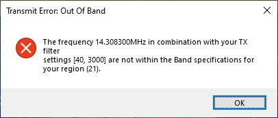

Just noticed this bug. I tried to transmit on 14.308,8 and get this msg (I get this msg on all ham bands)
