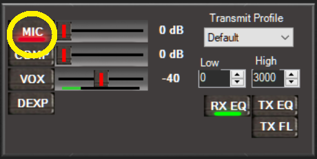

Not sure if you ever addressed this, one tiny persistent bug I'm still seeing is the MIC button won't stay disabled (my "Default" profile has been customized and re-saved).

Richie,ramdor wrote:K1LSB - it is caused I think by having different values stored into a TX profile. The slider value get stored, and when re-applied via the txprofile, causes a change, which turns the button on. Turn the mic off, then drag the slider, it turns on. Not sure if we actually want it to do that, it has to be coded around otherwise. I'll look at it again.
I never touch the Mic slider, it's always at zero. That value is saved with every TX profile so reloading any of my profiles doesn't change the value of the slider.

but assigning it a 0 is different to the value that is there by default which seems to be 6, so a change will occur, which will turn the button on. I will look at it.K1LSB wrote: Richie,
Just as a test, set it 6, turn the mic off, save the TX profile, restart and see if it comes back on.

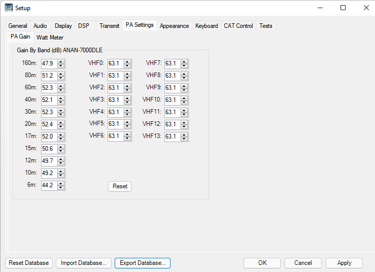

Are the PA Gain settings not saved as part of a TX Profile? If not, what is retaining this information?
It looks like to me most of what is saved are items in the audio chain.

Ruben,
PA gain settings are not part of the transmit profile.
Why would you want them to be?

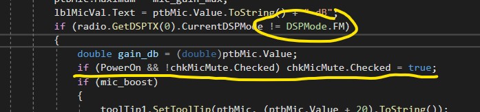

That mic turning on problem....
the function that contains that is called from 16 places
line in
line in boost
mic boost
MIC gain
CATMic
MicGainMin
MicGainMax
all the keyboard controls to change mic gain
The actual MIC button on the front end gui
when leaving FM
when swapping to AM but only if TXing on B .. for some reason
when swapping to SAM but only if TXing on B .. for some reason
The frustrating thing is that no comments are put in here, why is FM ignored for example? Every other mode it is ok to turn on the MIC if the system is powered and the MIC is off, but not FM? Why?
The upshot of this is that it could be any number of those settings that are changing and are causing the MIC to turn back on. Easiest solution would be to drop that code tbh and let user turn it on/off.
Code: Select all
if (PowerOn && !chkMicMute.Checked) chkMicMute.Checked = true;line in
No, I didn't know if those settings belonged in the profile or not. I was just curious. I ask many questions out of mere curiosity and not intended to be a statement of preference. This is why in an earlier message I stated than when I could see the highlighted sections I would learn a few things.w-u-2-o wrote:Ruben,
After seeing it all that is highlighted It looks like most all of it is audio chain settings that are saved. There are a places where
power settings are saved. I understand those ( the ones indicated in the profile) are specific power settings and not what I would refer to as power configuration settings that are in the PA Settings tab.
Thanks to you and Richie and all those that have been here a lot longer than I for answering my questions. Sometimes you ask me questions forcing me to think.

Hi Mark (& Richie), it took some time before i could reproduce this but in my case the mike changed to ON after switching from LSB or USB to AM or SAM.K1LSB wrote:Richie,
(7KDLE, v21e 64bit, Protocol 2, Win10)
Thanks for all you do for us!
The solution is rather simple... set TX-FL button to ON(!), change the mike setting to OFF and save your TX profile again.
Not sure if it's a bug but with TX-FL off your mike setting doesn't get loaded properly. r/Leon

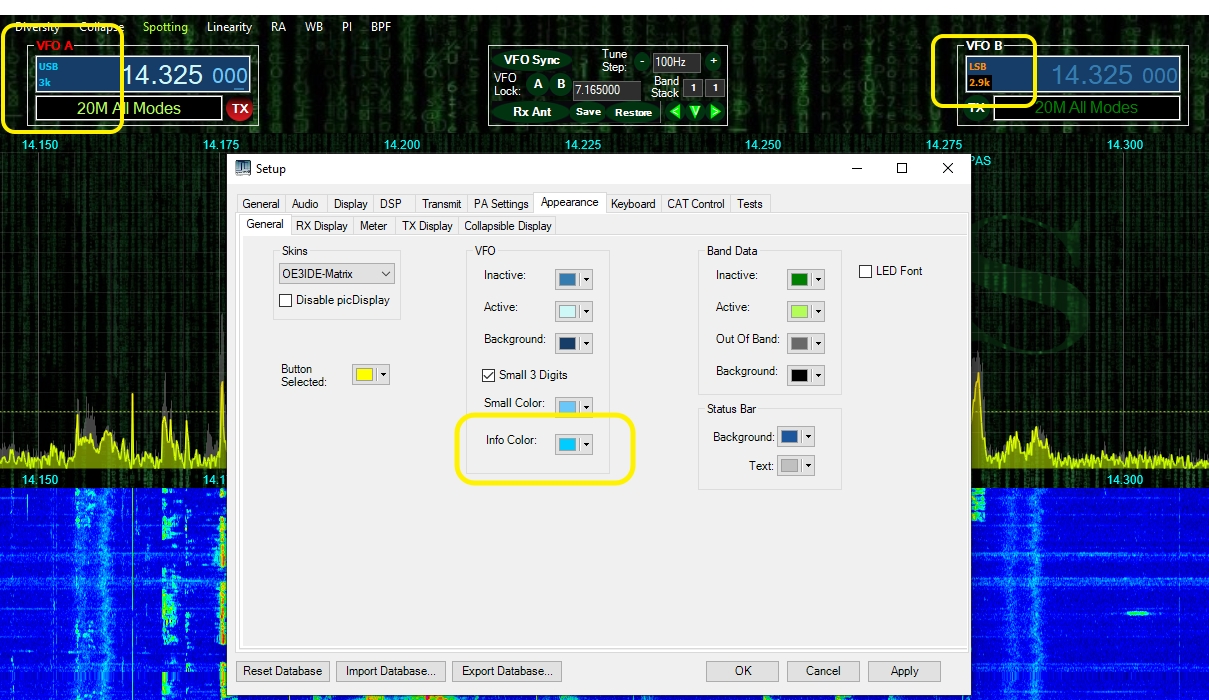

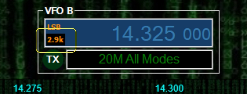

Ok, 2 small cosmetics for today

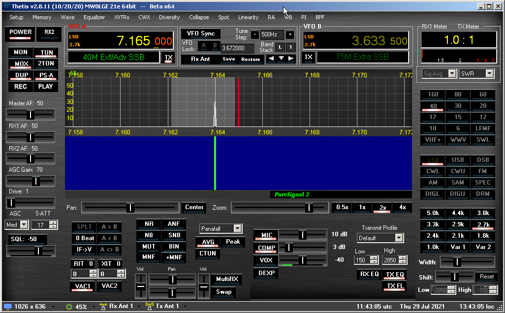

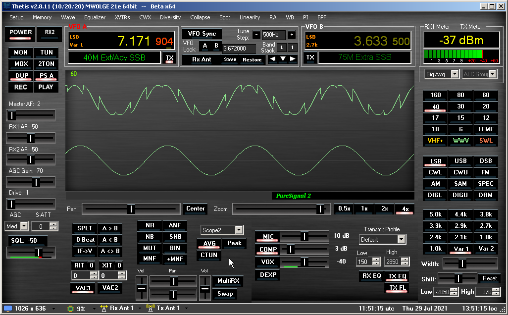

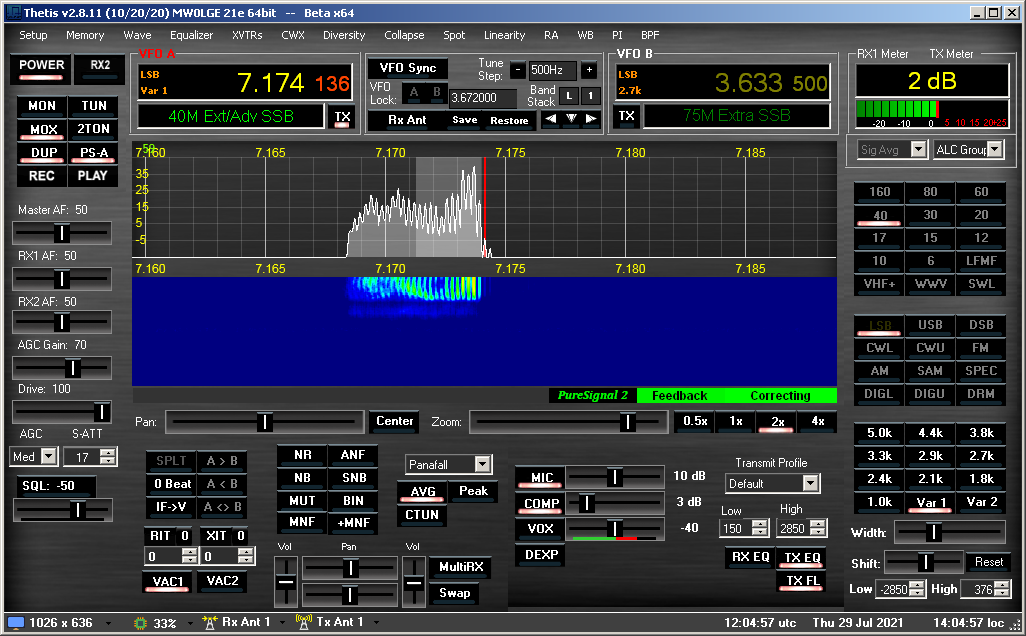

Bug report
[Thetis2.8.11 21e, Anan100 P2, WIN7 x64]
- Tune tone display is shifted by CW-Pitch in Panadapter, Panafall and Waterfall.
- TX spectrum display wrong widht if BW<>192k and DUP selected.
- Scope display is broken. Scope2 display first trace is broken, second trace ok.
- Collapsed Display: Band Control Buttons disapear if tuned outside hambands.
