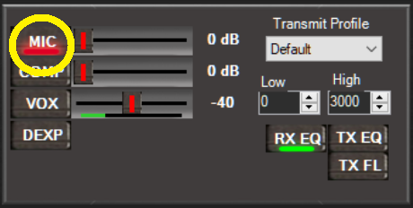

Not sure if you ever addressed this, one tiny persistent bug I'm still seeing is the MIC button won't stay disabled (my "Default" profile has been customized and re-saved).

ramdor wrote:K1LSB - it is caused I think by having different values stored into a TX profile. The slider value get stored, and when re-applied via the txprofile, causes a change, which turns the button on. Turn the mic off, then drag the slider, it turns on. Not sure if we actually want it to do that, it has to be coded around otherwise. I'll look at it again.
I never touch the Mic slider, it's always at zero. That value is saved with every TX profile so reloading any of my profiles doesn't change the value of the slider.

K1LSB wrote: Richie,
but assigning it a 0 is different to the value that is there by default which seems to be 6, so a change will occur, which will turn the button on. I will look at it.
Just as a test, set it 6, turn the mic off, save the TX profile, restart and see if it comes back on.

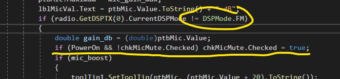

That mic turning on problem....
Code: Select all
if (PowerOn && !chkMicMute.Checked) chkMicMute.Checked = true;
the function that contains that is called from 16 places
line in
line in boost
mic boost
MIC gain
CATMic
MicGainMin
MicGainMax
all the keyboard controls to change mic gain
The actual MIC button on the front end gui
when leaving FM
when swapping to AM but only if TXing on B .. for some reason
when swapping to SAM but only if TXing on B .. for some reason
The frustrating thing is that no comments are put in here, why is FM ignored for example? Every other mode it is ok to turn on the MIC if the system is powered and the MIC is off, but not FM? Why?
The upshot of this is that it could be any number of those settings that are changing and are causing the MIC to turn back on. Easiest solution would be to drop that code tbh and let user turn it on/off.

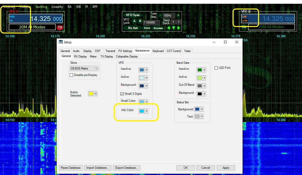

Ernst - I can clear the txt if an image is provided otherwise those without images will have a problem
I made the buttons for the 4 default skins (i think IK3VIG Special is the default one).

ramdor wrote:That mic turning on problem....
I agree, the best solution would be to let the user turn it on/off. IMO it should also be saved with TX profile, given that for some profiles (digital for example) the mic isn't used.

K1LSB wrote:Richie,
(7KDLE, v21e 64bit, Protocol 2, Win10)
Thanks for all you do for us!
Hi Mark (& Richie), it took some time before i could reproduce this but in my case the mike changed to ON after switching from LSB or USB to AM or SAM.
The solution is rather simple... set TX-FL button to ON(!), change the mike setting to OFF and save your TX profile again.
Not sure if it's a bug but with TX-FL off your mike setting doesn't get loaded properly. r/Leon

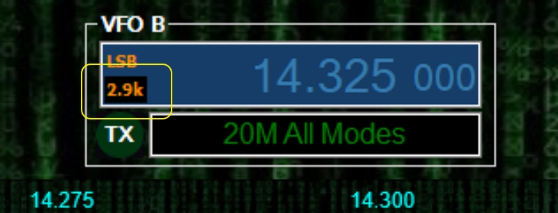

Ok, 2 small cosmetics for today :P
