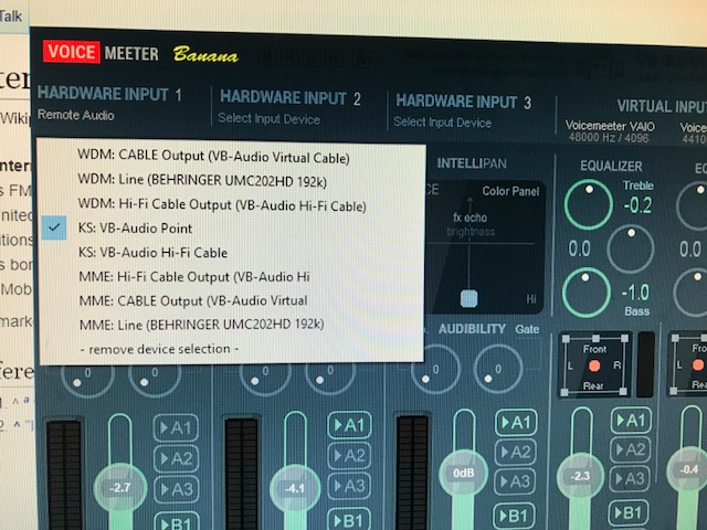

Server side settings
- vm server out settings delete.JPG (104.93 KiB) Viewed 61502 times
- VM server in settings delete.JPG (111.19 KiB) Viewed 61502 times

Wow, that set up is a train-wreck! I don't even know how it is working at all!
Why do you have VMB on both the remote and server (radio) machines? You only need it on the server (radio) side.
Why do you have all of those extra sends turned on on channels you are not even using?
And, of course, you need to set PowerSDR to run at 48KHz.
On the remote machine, just go into the Windows Sound Control panel and select the mic and speakers you want to use as the default interfaces. RDP will pick them up by, well, default!
On the server (radio) machine, set up as follows:
Remote Audio = Hardware Input 1, click ONLY the B1 button on that channel strip.
Remote Audio = Hardware Output 1
Attach PSDR to Voicemeeter VAIO for both RX and TX (you've already got this)
Click ONLY the A1 button on the Voicemeeter VAIO channel strip.
ALL other send buttons OFF.
That's all it takes. MUCH simpler. Get that working first, then we can, optionally, add on local sound interface support on the server machine after everything is proven and stable for remote op's.

I do not have VM on the remote machine. The screen shots are of VM on the server machine before I set it to remote audio and then after I set it to remote audio. The reason I changed the sample rate in psdr was because it was the only thing I could do to not get the pop up warning of wrong sample rate while trying to power on psdr while on remote computer. I will make some of these changes later you have suggested. I tested it this was last night. It seems to be working.

Ah, OK, I was confused because the photos were marked "remote" and "server".
