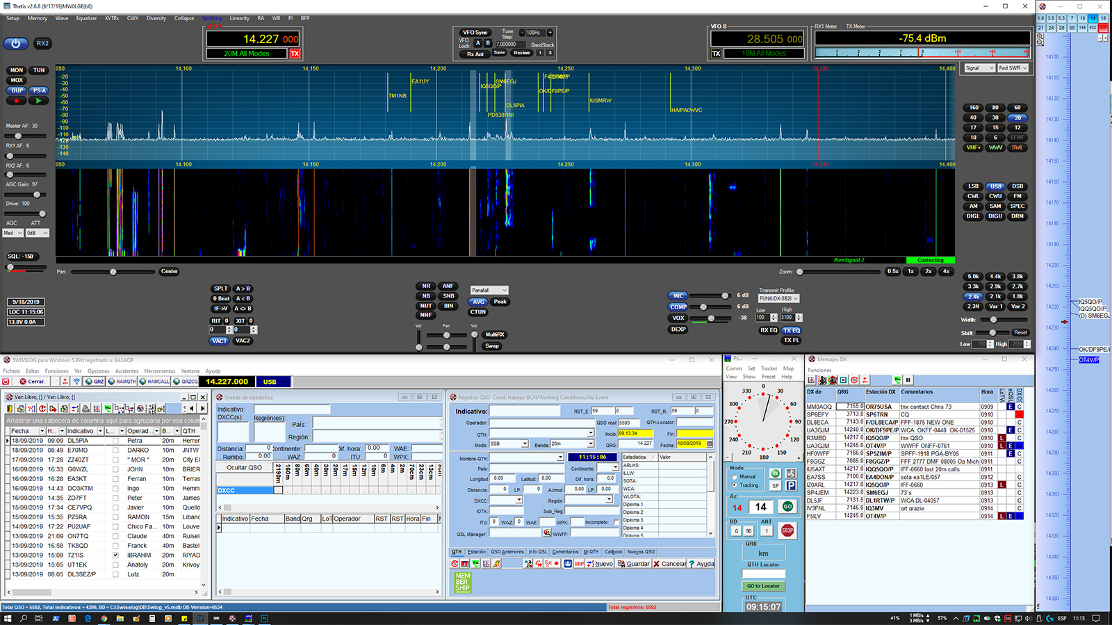

Re: 2.6.8
great find ! I did notice you had spots (in blue) on your screen shot, it was going to be my next thing to turn off after checking .net version. Will wait for the vid.ea3aqr wrote:FOUND!

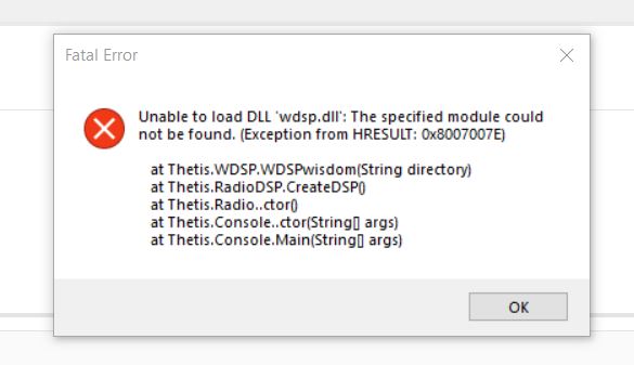

Got this error trying to install 2.6.8.
I have run 2.6.7 and FW 1.9 in the past but reverted back to PowerSDR after experiencing some problems after months of no issues.
Rig is an 8000DLE
Any help would be appreciated.
Thx
Carl

Re: 2.6.8
For those having issues related to region/language (ea3aqr SA3ATF etc) please try : https://www.dropbox.com/s/s2376eb4xf99y ... 9.zip?dl=0
You will need to delete/remove/reset your database, and possibly your memory.xml file if those have become corrupt.
changes (b6)
change: forced whole app to en-US, to overcome issue with settings files containing , instead of . Spot and Memory forms were already forced to en-US and caused issues with rest of Thetis
fix: clicking on the spot window (yellow) background does not cause an error
