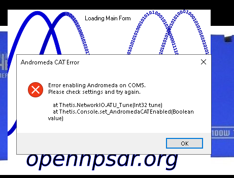

W2SDR wrote:I forgot to mention, I'm getting the same error message on shutdown.
Frank, W2SDR
in that case it is also happening when shutting it down, as part of Console_Closing, where AndromedaCATEnabled is set to false.
Can you try this build Frank? and screen shot the andromeda errors?
https://www.dropbox.com/s/jwjkoke7ytv2u ... 3.zip?dl=0
W2SDR

Hey Richie,
Thanks for the test download. Installed it and the program will not start but here is the error message I get now
Frank

Frank
I think that error message with the stack trace gives us a clue as to what's happening. I've contacted Doug for advice on what could be happening.
If you click OK can you get past it, or does THETIS exit?
Laurence Barker G8NJJ

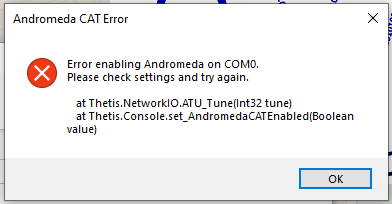

Some info regarding this error :
After some extensive testing and investigation, I can only assume the people that are seeing the Andromeda error are doing so because they are using the incorrect version of ChannelMaster.dll along side their Thetis exe.
ChannelMaster.dll includes a new call ATU_Tune. If that is not found in the dll then an error will occur during the andromeda enable/disable code and result in message you are seeing. It is impossible to see it any other way, especially after looking at the database.xml file provided.
I have checked the a2 zip file, and all correct files are there. If you are using these test versions, please make sure you follow the info in post number 1, especially the bold text.
There is nothing more I/we can do with this error as all looks ok in the code, and the only way I can get it to present itself is to use the wrong version of the dll.
Going forward, there is a case for including a version number in all the external components (dlls etc), that will get reported during an error/exception.

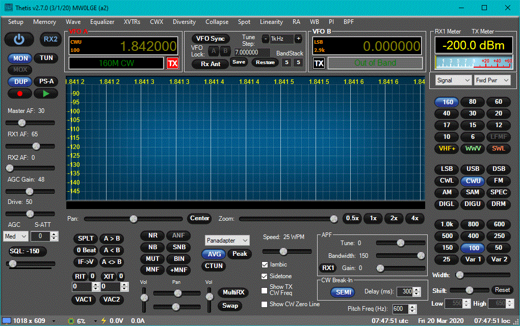

I have V2.7.0.a2 loaded now but can't enable it yet due to still P1 firmware on my 7000DLE MkII.
But I see another freq digit on the pan is needed @ 48 ksps and max zoom - see screenshot below.
Either add a freq digit or eliminate the x.xxx x5 - ie 50 Hz freq numbers.
I looked in setup but did not find a place to add a digit.
73, Paul N2PK

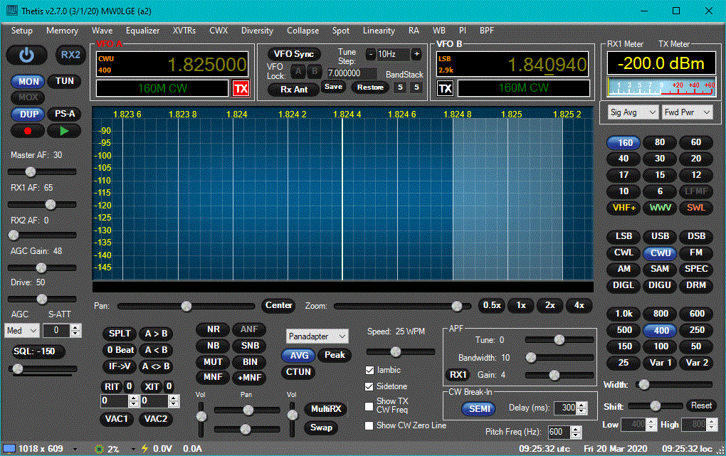

Let me elaborate on what I'm after here as a display option for ZOOMimg.
The pix below is a typical screenshot after ZOOMing in with a single CWU passband available for
display on the pan - ie MultiRX is disabled. The passband is 400 Hz wide and the pitch is 600 Hz. The
sample rate is 48 kbps.
The 1824.4 kHz injection freq is the blue vertical line ans is centered on the pan after the ZOOM. The
400 Hz passband here is centered on the VFO A 1825.0 freq and ranges from 1824.8 to 1825.2 kHz.
My problem here is that for CW, or any other mode for that matter, I NEVER care about the injection
freq. I generally ONLY want to see what's going on in the passband. While this can still be seen here,
zooming all the way takes part/all of the passband off screen. While the PAN control can be used to bring
the passband entirely back on screen, that seems to be a perhaps easily avoidable nuisance.
While one might be first inclined to suggest using VFO A as the freq to center the pan on instead of
the injection freq, that is not without pitfalls.
First VFO A for modes like USB, LSB, DIGL, and DIGU is also the injection freq and the passband is never
centered on this freq.
Even for CW, VFO A is not always the desired freq for passband centering as "Var 1" or Var 2" can be used
to make the passband center different from VFO A.
So something a bit more complex is required but I suspect it turns out to be very simple.
If we denote the passband freq boundaries, as displayed in the screenshots below, by FL and FH,
then (FL+FH)/2 ALWAYS represents the center of the passband being used at any given time for ANY
given mode.
I am guessing that you always have easy access to the values for FL and FH in programming the Thetis UI .
After all, you need them to display the passband boundaries.on the pan. So the calculation of the passband
center freq would seem to be a simple matter.
Is that all correct?
Assuming so for now, I am proposing that you consider providing a Thetis setup option
that allows the user to select either the current injection freq or the passband center
for use in pan/panafall display centering after a zoom in ANY mode.
Your thoughts?
Many thanks and stay well!
Paul N2PK
Passband Centered While Zooming.gif (226.26 KiB) Viewed 35569 times
Posts: 1595
Re: 2.7.0
Hi Paul,
Yep all do-able. Added to the list. Thanks for posting your ideas here for other people to read and give feedback on.

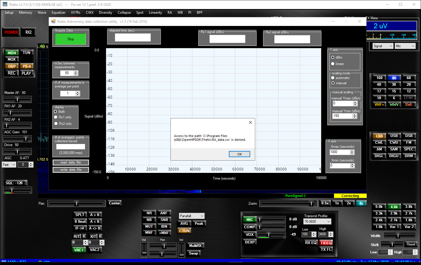

wa1oxt
Posts: 73
Re: 2.7.0
Post by wa1oxt »
RA is inop .
Thetis 2.7.0 (a2) , Fw ver 12.1pre 4
