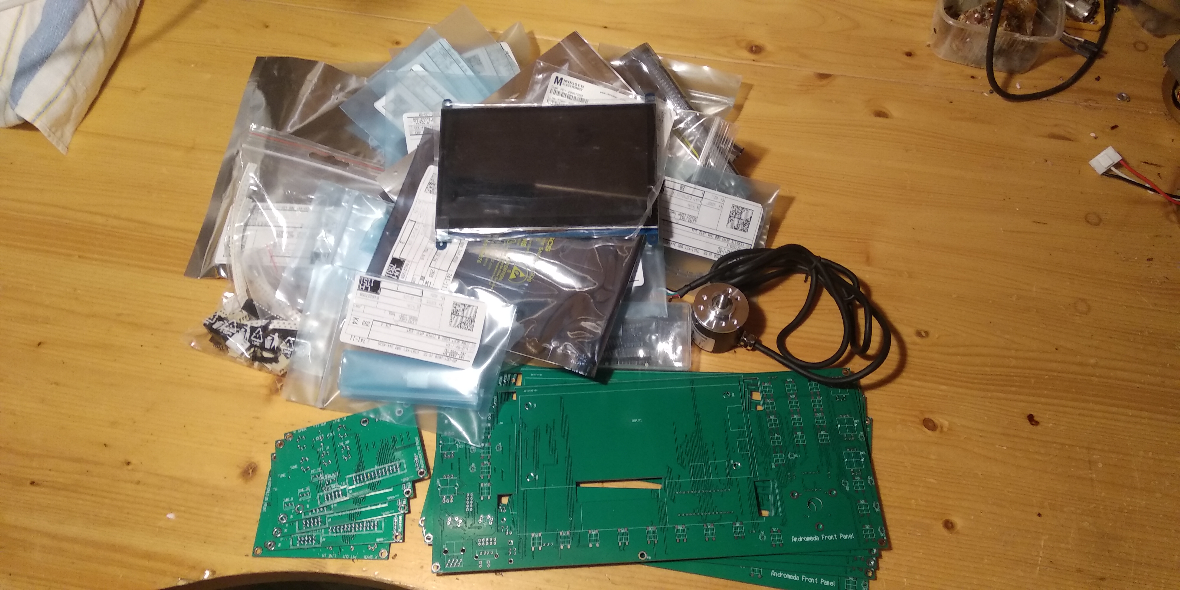

OK, I did it 8-) I ordered 5 PCB set!!! If someone would share with me it, let's go 8-) I'd prefer EU! Other regions could be too expensive... Anyway it's not cheap for me :-/

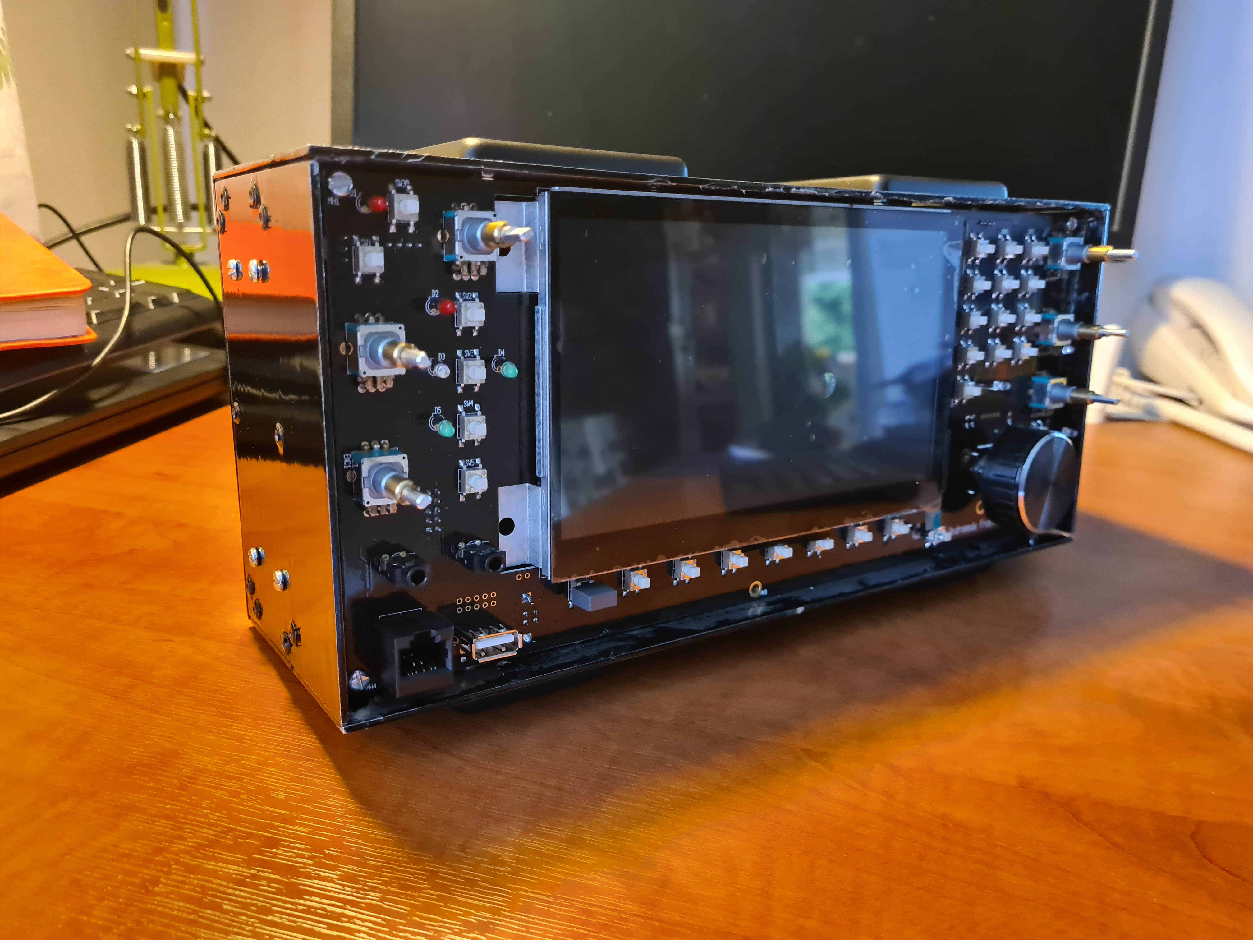

I attach a photograph of a "standalone Andromeda". I've made this because I've had too many accidents on my workbench and I needed Andromeda in a form where the wrong power lead wouldn't do any damage!
[img]]20201101_131511.jpg[/img]
This has the NUC PC on the back; it has stereo speakers on top. Most people are better at metalwork than me, so more imaginative packaging is possible!
You can use this connected to the radio hardware (eg ANAN200D; 7000DLE): so the front panel CW key, microphone and headphones all route to the Orion board in the hardware. Or you can use it remote from the radio with an ethernet connection, using PC (VAC) audio. In this case the CW key and PTT connect to Thetis via a USB serial port.
Mine doesn't have a good audio amplifier yet - you can "hear" the PC operating. I think this is coupled through the NUC power supply, which plugs into the back on my box. More work to do here. I'm planning to get rid of the prototype board and make a small PCB for the audio paths.

That looks pretty spiffy. Is that an Andromeda without its cloths on ?

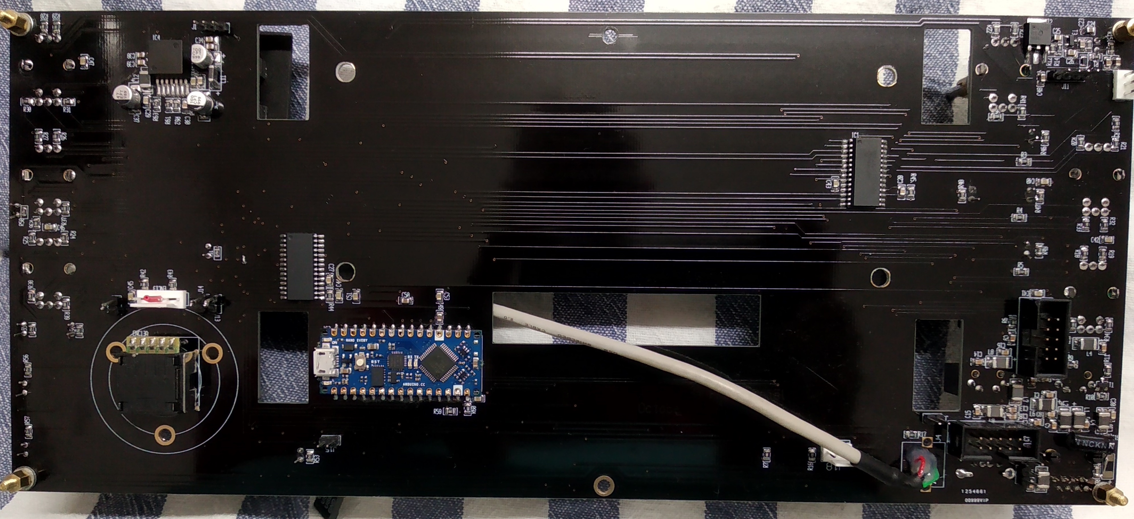

I tried to make a picture from my Andromeda pcb.
Somehow I can't get a sharp photo. :?

I can post right now, god quality images( I hope so ) of Andromeda boards from Boktech 8-)
https://mega.nz/folder/XJwg3CpB#sjnEU-BepCm-PU-acQp_gQ
If anybody suppose, it not good enough :roll: OK, I will try to punch my son to make better images :lol:
But later on, it will be with populated parts 8-)
