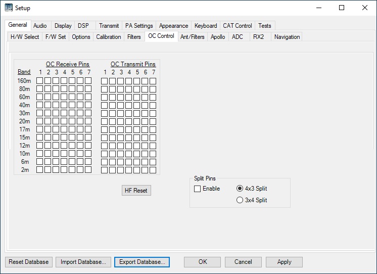

EXT CONTROL now missing in the OC Control setup window in Thetis 2.8.8 (see image attachment from version 2.7.0.) That's a real handicap for me, possibly others. I routinely go in and quickly activate/deactivate global OC control with one click to route Orion II RF and some other functions to the back panel for use with an LDMOS amp that requires 0.5W drive. As is, it now requires a lot of "click management" to accomplish the same. Not sure why OC Control is now limited.
- OC_Control 2.8.8.jpg (104.51 KiB) Viewed 42101 times
- OC_Control.jpg (82.85 KiB) Viewed 42101 times

Re: Thetis 2.8.8 Released!
Paul,
The EXT CONTROL will be added back.
Doug
Doug
W5WC
Thanks, Doug! All else working well here with 2.8.8.w5wc wrote: The EXT CONTROL will be added back.
Doug
W5WC
