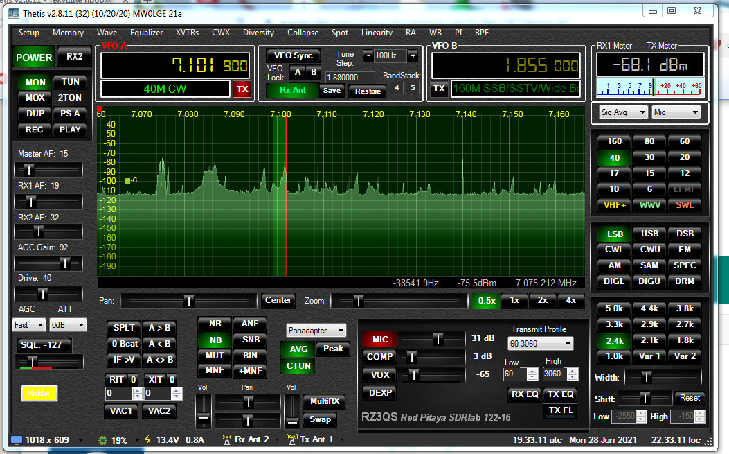

Gradient control will be better at -150 dBm 0 dBm. -200 +200 is a lot.
- 21a.jpg (301.97 KiB) Viewed 76225 times
Yes I know. However the reasons are covered in this video : https://www.youtube.com/watch?v=mLVZuK1zDkQYevgeni wrote:Hi
It is still a work in progress user control. Also, I notice in your screen shot the 'hidden' button is not hidden. I will investigate why this might be happening. It is related to the recent change to fixing the focus lost problem with rx2 in collapsed mode.

Yevgeni - yep, this has been fixed. I noticed it your image related to the dBm range. It only shows as you say if you start up with minimum size window.

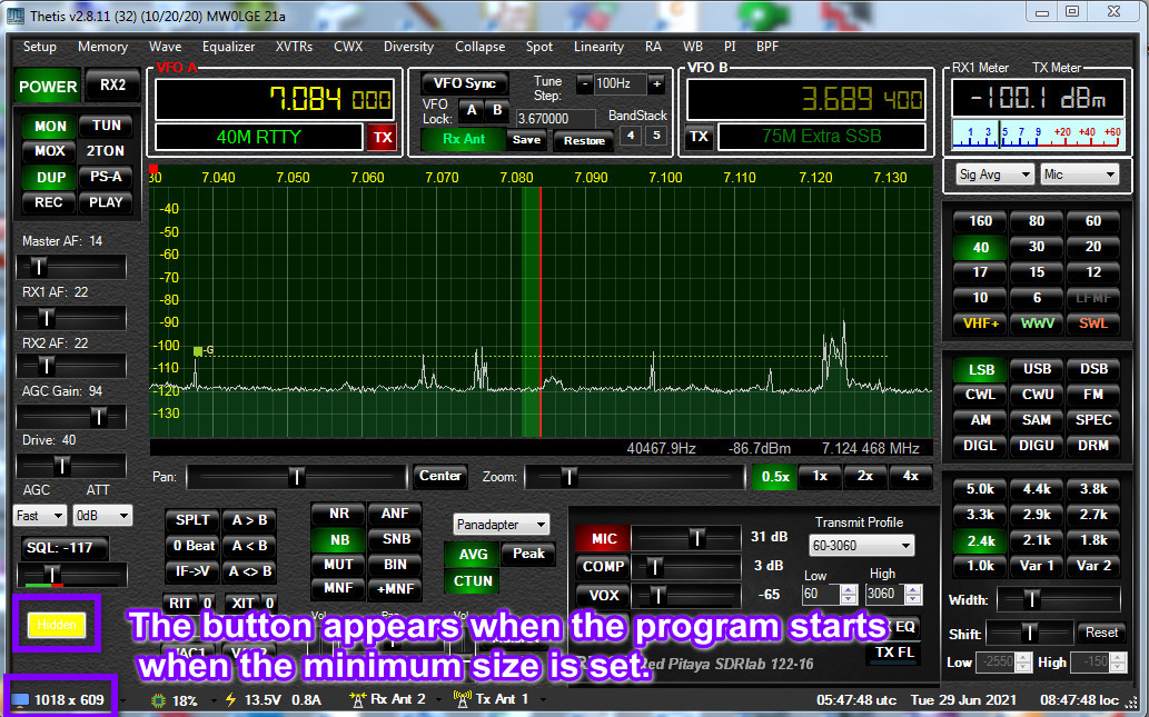

I confirm the cosmetic bug of yellow rectangle indicated by Yevgeni when Thetis window is manually resized at its minimum dimension, at next startup.

The yellow HIDDEN button issue is fixed.I2NOY wrote:I confirm the cosmetic bug of yellow rectangle indicated by Yevgeni when Thetis window is manually resized at its minimum dimension, at next startup.

The only anomaly that I noticed today with the new version is that the resolution scaling does not seem to be accurate when using the presets down in the lower left corner of the status bar. As an example, to make the GUI display as 1280 x 720 the setting in the status bar needs to be set to 1266 x 684. Definitely not a big deal but it works correctly with the original 2.8.11 so something may have changed somewhere inadvertently.
Great job on all that has been done with this version!
odd that Rob. I will look into it. It uses two methods of setting size based on the 'include borders' option :W1AEX wrote:Hi Richie,
1) Form Size - where the dimensions relate to the entire window/form including the window borders
2) Client Size - where the dimensions relate to the internal area of the whole console window/form excluding borders
I'll have to install a paint package to check out the sizes that it is creating
Cheers, RIchie.
