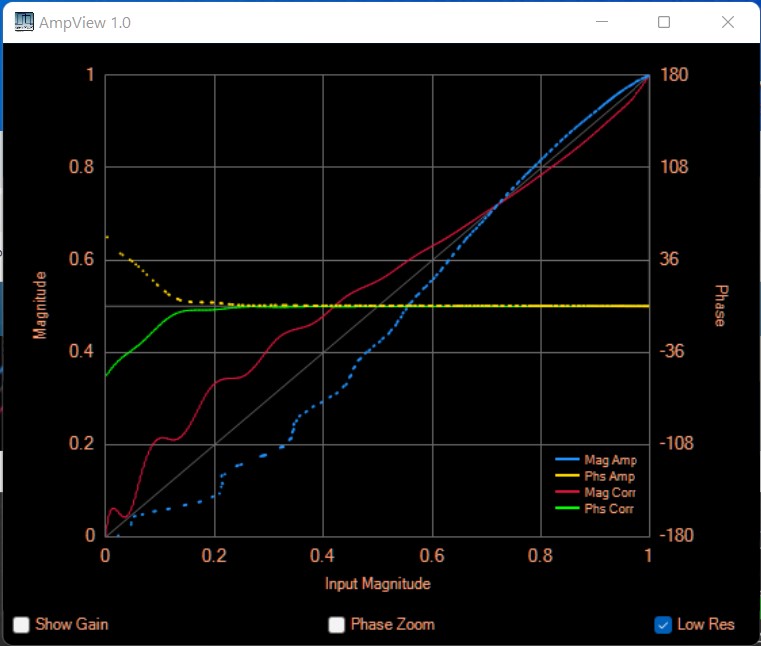

It's been my observation that PS locks on to a Correcting condition extremely quickly (typically less than a second) after simply speaking into the mic upon PTT, especially since Richie added the "Quick Attenuate Response" option.
Also, I get rather different (and kinda ugly) curves in the AmpView screen when using TwoTone. Those curves smooth out after a few seconds of mic audio so I decided early on (rightly or not) that TwoTone doesn't give me PS correction characteristics that are optimal for phone audio, so I just quit using it.

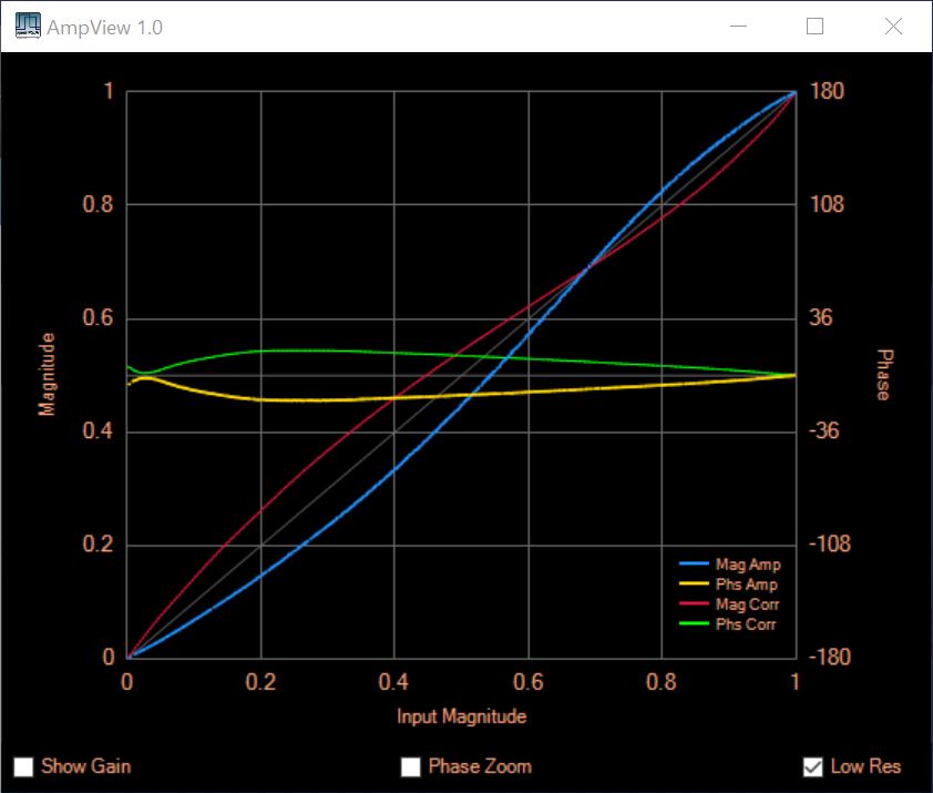

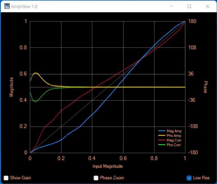

Posted: Thu Apr 07, 2022 9:03 pm
K1LSB wrote:Also, I get rather different (and kinda ugly) curves in the AmpView screen when using TwoTone. Those curves smooth out after a few seconds of mic audio so I decided early on (rightly or not) that TwoTone doesn't give me PS correction characteristics that are optimal for phone audio, so I just quit using it.
Interesting. Perhaps that is an artifact of the amp response to the two tone signal.
Have you tried 70/190 in lieu of 700/1900? I'd be interested to know if that works better for you, and it might provide some insight into the amp response.
With a KPA1500 amplifier on 15M, the AmpView curves are nearly identical for me between two tone and voice:

Posted: Fri Apr 08, 2022 12:09 am
Very insightful of you, Scott! Here's what I get with my AL-80B on 75M:
Posted: Fri Apr 08, 2022 1:15 am
Very interesting Mark, thank you for performing that experiment :)
It would seem there are certain amp's out there that really don't like the 700/1900 combination, but are just fine with the 70/190 combo. This doesn't meet the standard two tone test parameters of two frequencies between 300-3000Hz, and at least 1000Hz apart, but it does meet the requirement for non-harmonically related. At any rate, although it's not standard, it does functionally work for driving PureSignal to closure, and, if the TX panadapter is zoomed in enough, provides a good indication of IMD performance. And it is digestible by a wide variety of amplifiers.

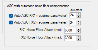

w1tr wrote:I have been using Thetis 2.8.11 21K8 and it works fine...
I upgraded to 2.8.11 21K9 a few days ago and the Automatic AGC Gain Level failed, it set the gain to the max, 120.
I then upgraded to 2.9.0.2 today and the same issue, automatic AGC GAIN level is set to max, 120.
It seems that the transition from 2.8.11 21K8 to 21K9 broke this capability?

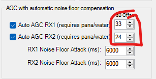

Nothing is broken, you just need to adjust the values here, to get it where you want :
there are reasons why the values changed, as it now takes sample rate / bin width into consideration. It was discussed extensively at the time it was fixed.

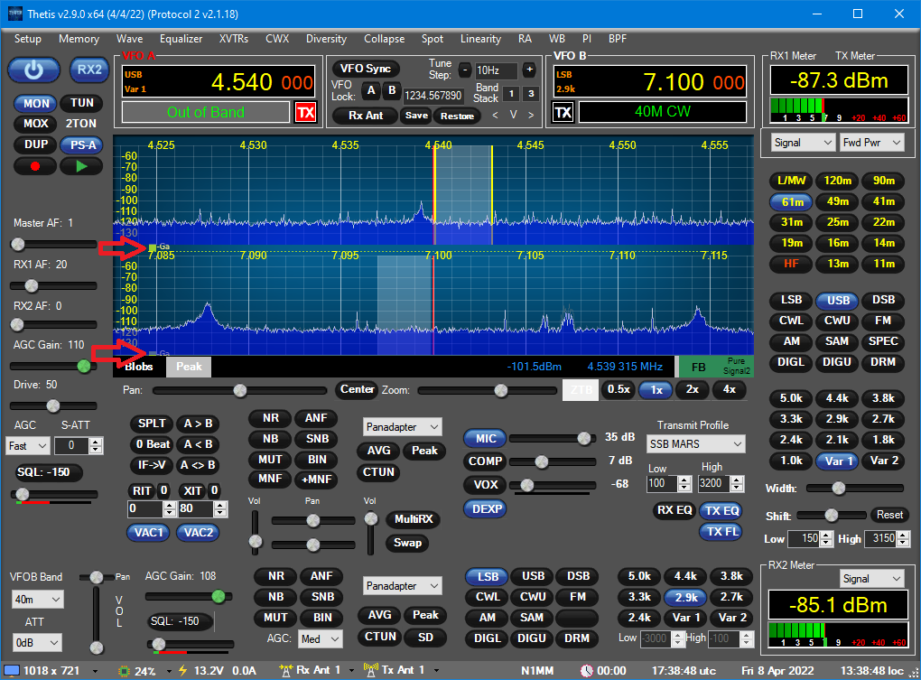

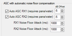

Posted: Fri Apr 08, 2022 5:43 pm
by w1tr

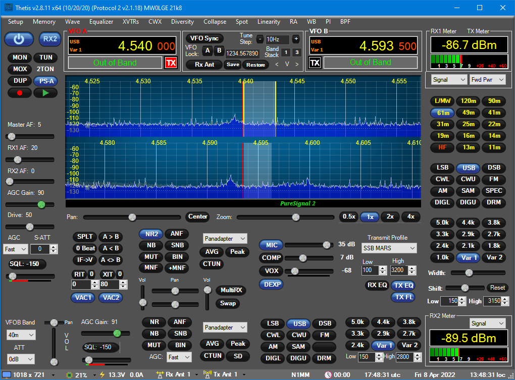

I updated to 2.9.0.3 and I claim the Auto AGC Gain is STILL BROKEN:
One image is the settings I am using, I INTEND to be just below the band noise so I pick up digital message.
the other image is the Thetis GUI... it shows where the AGC Gain is set, clearly not where it should be!!!
AGC Gain Settings.png (5.31 KiB) Viewed 21755 times
Thetis GUI.png (201.39 KiB) Viewed 21755 times

by m1tzr
w1tr wrote:I updated to 2.9.0.3 and I claim the Auto AGC Gain is STILL BROKEN:
Try setting the Value to 30 instead of -5 and see how that is. You can then tweak the value to what you like. Notice Richies is 24 not a minus number.
Paul

Here is Thetis 2.8.11 Automatic AGC Gain working as it should
Thetis 2.8.11 GUI.png (200.22 KiB) Viewed 21748 times
Posted: Fri Apr 08, 2022 5:51 pm
w1tr wrote:STILL BROKEN:
ok, whatever you say then in that case. I can't fix what is not broken however.
Increase the -5's to something larger, to move the gain compensation which is based on the noise floor. Keep incrementing it and you will see the AGC slider on the left reduce in value. You probably want it somewhere in the range of 20-40 and not -5 !

Can you at least ACKNOWLEDGE that the GUI for 2.8.11 shows it working correctly, and 2.9.0.3 NOT ?
Posted: Fri Apr 08, 2022 5:56 pm
by Tony EI7BMB
2.9.3 is working correctly, you need to set the auto agc offset value to something more than -5
Posted: Fri Apr 08, 2022 5:58 pm
w1tr wrote:Can you at least ACKNOWLEDGE that the GUI for 2.8.11 shows it working correctly, and 2.9.0.3 NOT ?
Not really no.
It used to move all over the place if you changed bin width. It works differently and now correctly.

Well, I guess I stuck with 2.8.11...
Furthermore... if you use Memories...
1) there is no place to enable/disable the Auto AGC Gain
2) If you select a memory channel, it wipes out the Auto AGC Gain setting and you have to re-enable it.
Is there some action when changing versions between 2.9.0.3 and 2.8.11 other than the directions to RESTART, could that be affecting things?
Does Auto AGC work for you on 2.9.0.3?
Regardless of the offset value +20 or -20, the result is the same... max AGC GAIN here.

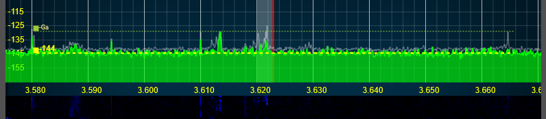

1) right click on the AGC slider (rx1 or rx2) to enable/disable or use the checkbox in settings
2) any change to agc value, cat, memory, midi, etc, causes auto agc compensation to turn off. I can add an option to ignore that
If you display the noise floor (under display-rx1) you can check where it thinks it is. It is where the AGC with automatic noise floor compensation gets the NF calc from. It does not need to be shown for this to work, however it will only operate with panadaptor/waterfall atm.
Something to note, you should be able to 'drive' up the values in the config to move your AGC. Just mouse wheel them, and move it to where you want. I would suggest you increase them.
Also, just to add, I can run with a dummy load with a NF of around -144dB and the auto comp agc runs fine (i use approx. +32dB as the setting).
