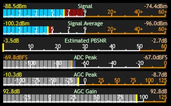

ramdor wrote:Some more progress. I have been busy + rather ill recently so not much spare time.
https://youtu.be/rB5HRvNXWEI
Get well soon, Richie!
The code in the video is not committed to git yet, correct?
Posts: 1587
Re: Thetis 2.9.0.7 x86 (4/23/22) MW0LGE pre-release (meters testing)
no, not yet, perhaps in a few days

I have been building the wip over the past few days and enjoying the latest progress.
1. The kenwood meter image in the zip is not as clean as the one from the latest youtube short... The cross needle one is clean. The short video shows this cleaner kenwood meter image very nicely. :-)
2. The kenwood meter signal strength is a little less than the other signal meter. Perhaps because I am using a dated kenwood-s-meter.pgn ? (thanks orlando bob for pointing this out) I will create an issue in the repo to indicate this if I don't hear of an updated pgn
DISREGARD. WORKS GOOD on latest today.
3. This work of course opens up the topic of layout management of all the components in existing thetis... not sure what the intent/plan is there... obviously not everything fits in existing layout... works great when meter containers are out of the main thetis window... the current implementation is very nice and my thoughts are... wouldn't it be nice to extend this to the rest of the UI... create a container for say, the band buttons, another for the bw size buttons, etc... and be able to position them in a smart layout mgr... familar with the difficulties of doing this without some other underlying platform which is likely not there in existing thetis... Great work with the new items and glad you are having fun doing this Ritchie.
4. The CFC meter seems missing. Not sure if a known issue. Do you want github issues for things still under development?
Hope you are feeling better now Richie :-)
miguel/kc1lko
Posts: 1587
@miguel/kc1lko

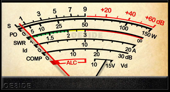

1) oe3ide (Ernst) has been working on these extensively, including dark mode, but not public yet
2) kenwood meter now is able to display sig_avg/sig
3) in my next life perhaps
4) no, cfc_av, cfc_pk and cfc_gain (previously comp) now available, it was on my list todo

we have ditched the various skins based on output power, and now the scale is rendered in code. You can specify power limit for the cross/ananmm. Tomorrow the hbar scaling will be reworked in a similar way.
Try out the new commit from this evening, clear out your meters folder, and run v1.1 of the meter skin installer.

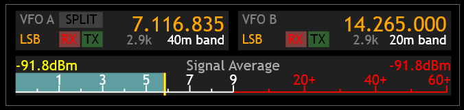

Watched your video short demonstrating meter display. I would like to suggest to change the numbers about the bar graph numbers on the right side to something other than red. This way they will contrast with the numbers directly below them Yellow or Orange like the left side unless they are above the limit then turning Red is good.
https://youtube.com/shorts/z_BORrwSCdE?feature=share
K4IBC wrote:Watched your video short demonstrating meter display. I would like to suggest to change the numbers about the bar graph numbers on the right side to something other than red. This way they will contrast with the numbers directly below them Yellow or Orange like the left side unless they are above the limit then turning Red is good.
It will be all configurable by user.
73 de Ernst

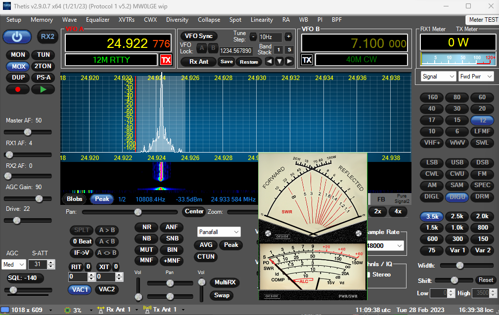

Last night I downloaded the meter skin file .exe from GitHub and installed it. It created a new folder. I could not change the default meter though using ANAN 200D. Everything was working as always. When I switched on the PC and ran Thetis this morning, I realised my TX Meter is not working. Power output is okay.
I have reset the database. No change
I have installed Thetis again after Uninstalling it and deleting the folder.
What I am doing wrong? Please suggest.
Thetis Version is 2.9.0.7 x64 91/21/23)
Thank you.
Bhanu
VU2MB

@vu2mb The default top right meter in main thetis window has not been touched/changed other than fixing ADCL/R to use adc-pk/adc-av instead of returning the same value for L/R. You probably have the incorrect TX meter selected, or one that you are not expecting.
The new meter config is in Setup->Appearance->MultiMeters2.
vu2mb
Posts: 128
Post by vu2mb »
Dear Richie,
Thanks for your response. Yeah, I know the main meter should not be affected.
Now, none of the meters (Main or Kenwood) shows TX output.
A screenshot is attached. In my version of Thetis Multimeter2 option is not there.
I am transmitting 25W on a random 12M freq in FT8 mode.
What I must have done wrong?
Thank you.
Bhanu
VU2MB
Thetis TX meters not working.png (335.74 KiB) Viewed 20433 times
Posts: 1587
No clue, but it is an old build you probably got from somewhere dated (1/21/23) in the title bar. Could be any number of reasons. I certainly haven't released any compiled version. Did you build it?
edit: might be an incorrect version of wdsp.dll

I built the latest that was posted yesterday. At least I think I did, I'm not fully up to speed on pulling down Git updates, etc. I spent a lot of time playing with the new metering to get it just the way I wanted it (so far) and posted the results here:
I'm not at all interested in the old school meters, but the magic eye came in handy to fill in some otherwise blank screen real estate :D
Everything is very usable as is and represents a major leap in metering just the way it sits right now. But what kind of post would this be without a wish list? ;)
Wish list (in no particular order):
- User adjustable low/high threshold (for instance to set a lower SWR threshold, but might as well make it generic to any meter).
- Add low/mid/high threshold (for instance, mic level green below -5, yellow -5 to 0, red > 0, and user adjustable as per the previous wish)
- Allow horizontal/vertical stretch (override aspect ratio).
- Option to fade entire container to transparent on RX or TX (use case--place TX meter container over the spectral display but it only appears during TX, alternate use case--separate RX and TX containers inhabit the same screen real estate but only one is visible at a time, etc.).
- Not meter related, but dark theme for the Thetis title bar would be super-nice.
Things that might be bugs or might just be work-in-progress:
- Allow clicking the PBSNR meter to get S units or decibels (like the Signal and Signal Average meters).
- Peak hold/history doesn't seem to work (yet) on TX related meters.
Point of confusion:
- Not sure exactly how all the windoid controls work. I did figure out that tacked means "always on top" :)

w-u-2-o wrote: Wish list (in no particular order):
Point of confusion:
Hey Scott,
Glad you managed to get it up and running to give it a look/see. Unfortunately most if not all of the wish list probably wont happen any time soon as I just don't really have enough spare time at the moment to rework a bunch of the scaling code which would be needed for configurable cross over points etc. Container transparency has been looked at and is probably a no go using windows forms. We make use of a usercontrol to target the directX renderer into. The usercontol's parent is re-assigned from the main console window to a sub form when docked/undocked. Transparency/alpha is something that is not very well handled by usercontrols in windows forms and is something that needs some more research.
Yes, the pin/tack is on top option. The dock/undock icon is also there. When docked the arrow defines the internal edge of the console window that the docked window tries to maintain distance from when the console is resized.
Regarding pbsnr sunits etc, yes on the list to do. Also, the peak hold stuff in your video on tx is getting disrupted by vox unkeying/keying between words. There is an ignore time when tx<>rx/bandchange happens before peak/history is gathered, and at the moment this is around 2 seconds. The reason being is that WDSP needs to settle and would otherwise show odd history where the whole meter bar may get filled with min/max. This delay/ignore time could probably be made configurable for the end user.
I am working on a couple of extra 'meter' bars at the moment, such as vfo display, clock, spacer, s-meter text only etc, and I really do hope to have this done by the end of weekend or early next week. A pre-release compiled version is on the cards for next weekend (17th March).
73 for now, need to get back to the code ;)
