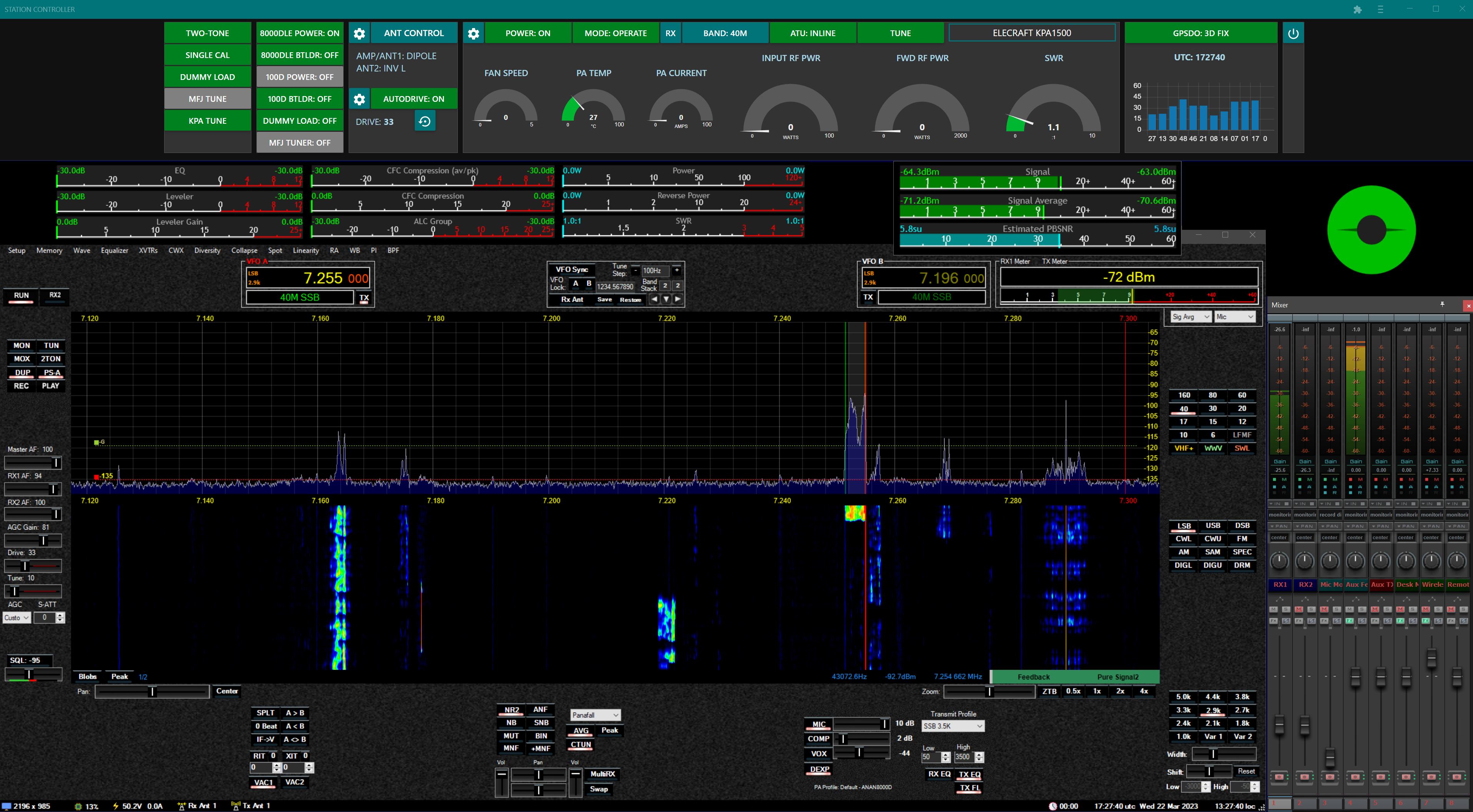

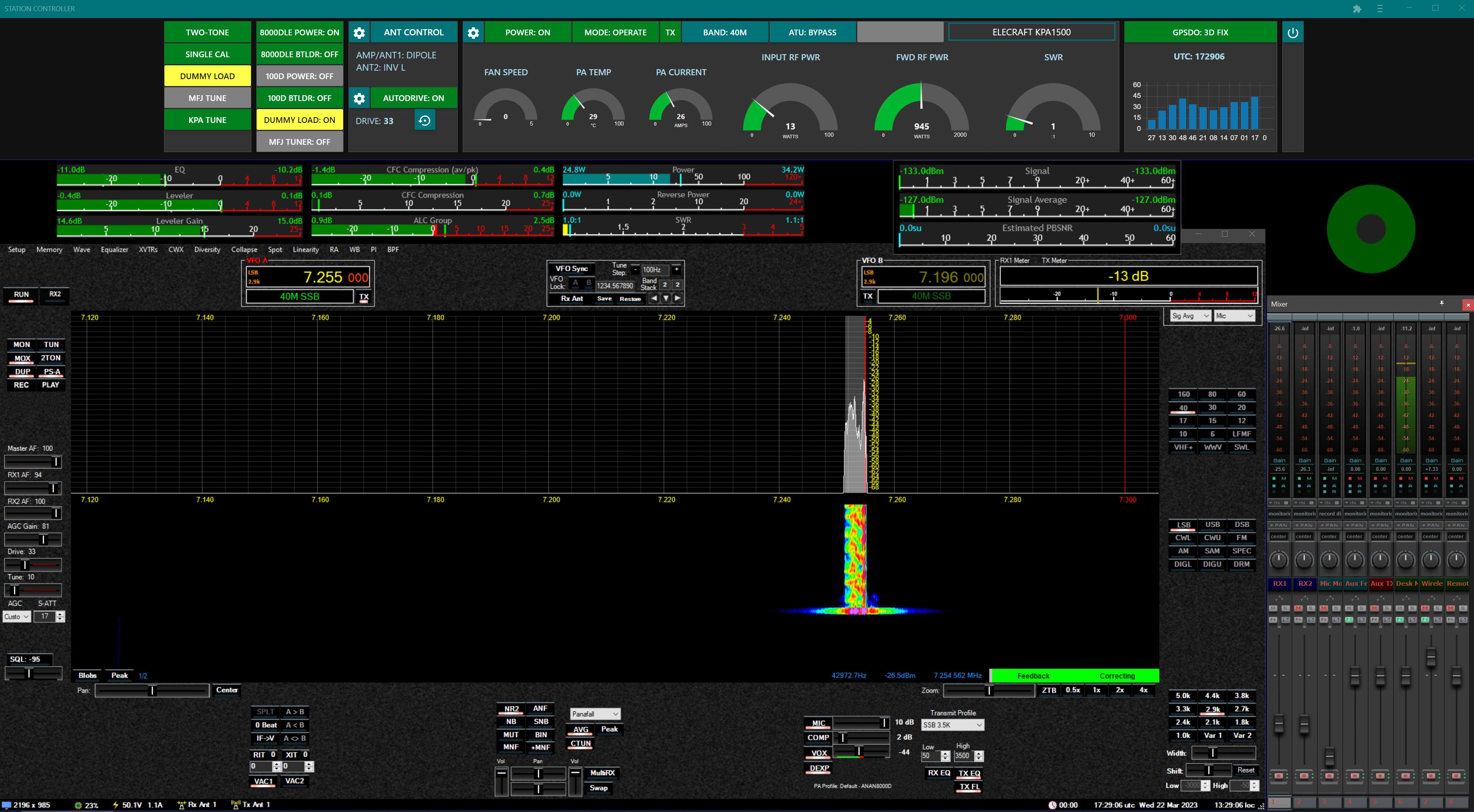

With the EVGA control panel blivet out of the way, a whole day's worth of fussing has evolved this layout, which uses an entire 4K display.
Right click and "Open in image in new tab" for full resolution.
Receive...
Transmit...
Too busy to talk on the radio, still fussing with the meters :D

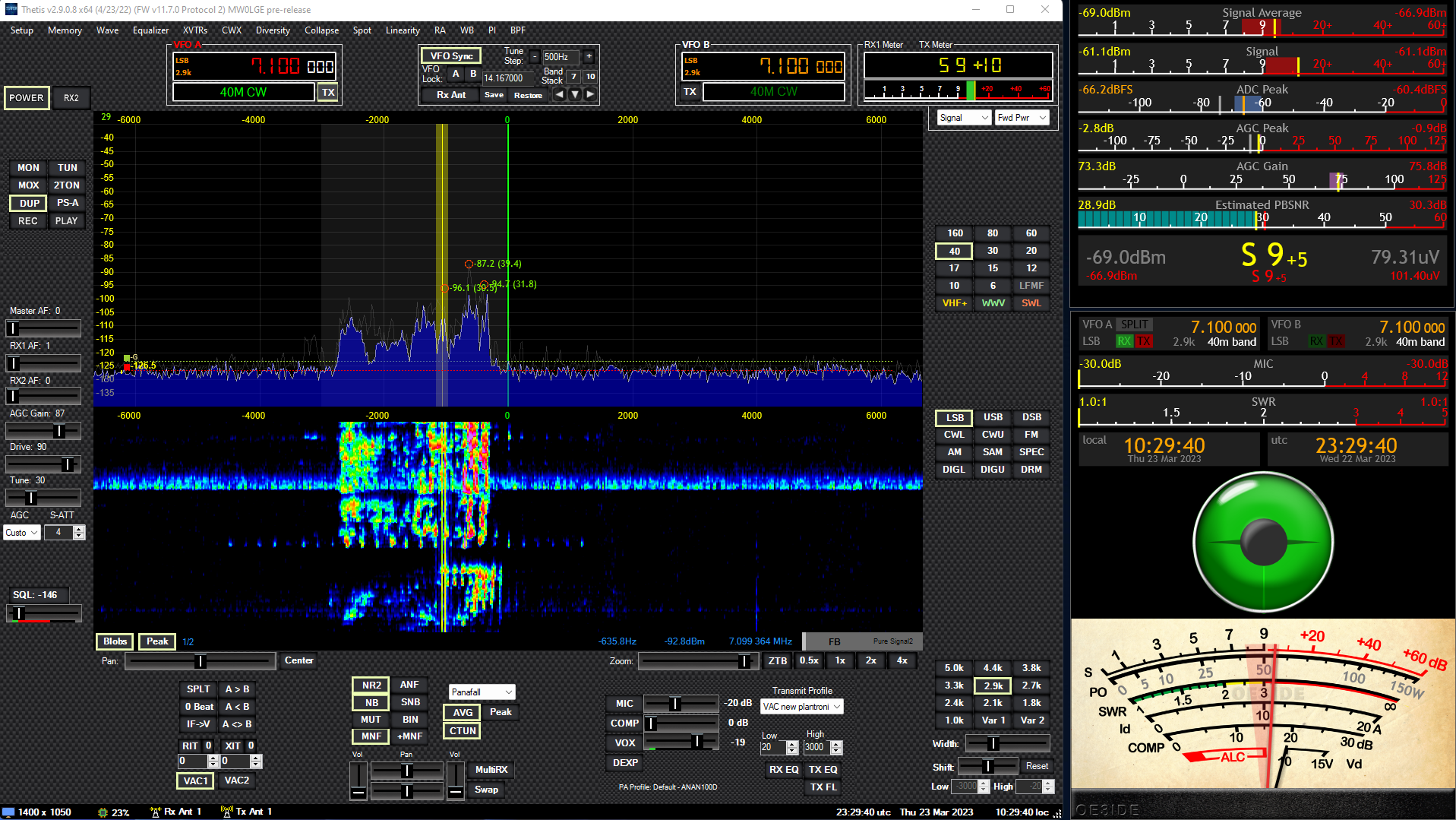

During the last few months, I have not been able to dedicate much time to my favorite distraction – the Anan and Thetis.
Today I had a little dive to see what’s been happening on the forums.
- WOW !!! :o
Richie, you have done an amazing job with all the code for the meters!
Putting on my “dev hat” – I know the effort required to achieve what you have done in such a relatively short period.
You are truly a master of your craft.
I am sure that on behalf of ALL of the community – in particular the silent majority – I would like to thank you so much for your dedication and stellar contribution(s).
Also, Ernst has done a fabulous job with the skins – they look great and more importantly track well.
Below is a screenshot of my little “fiddle” with your fantastic pre-release.
Thetis v2.9.0.8 x64 - just playing with it.png (1.08 MiB) Viewed 24297 times
I love the concept of the “containers” and the ability of being able to virtually customize everything.
I can see that many of us will be very busy fiddling with this wonderful interface – to create our own little “masterpieces” of visual overload enjoyment as we use our radios. :D
