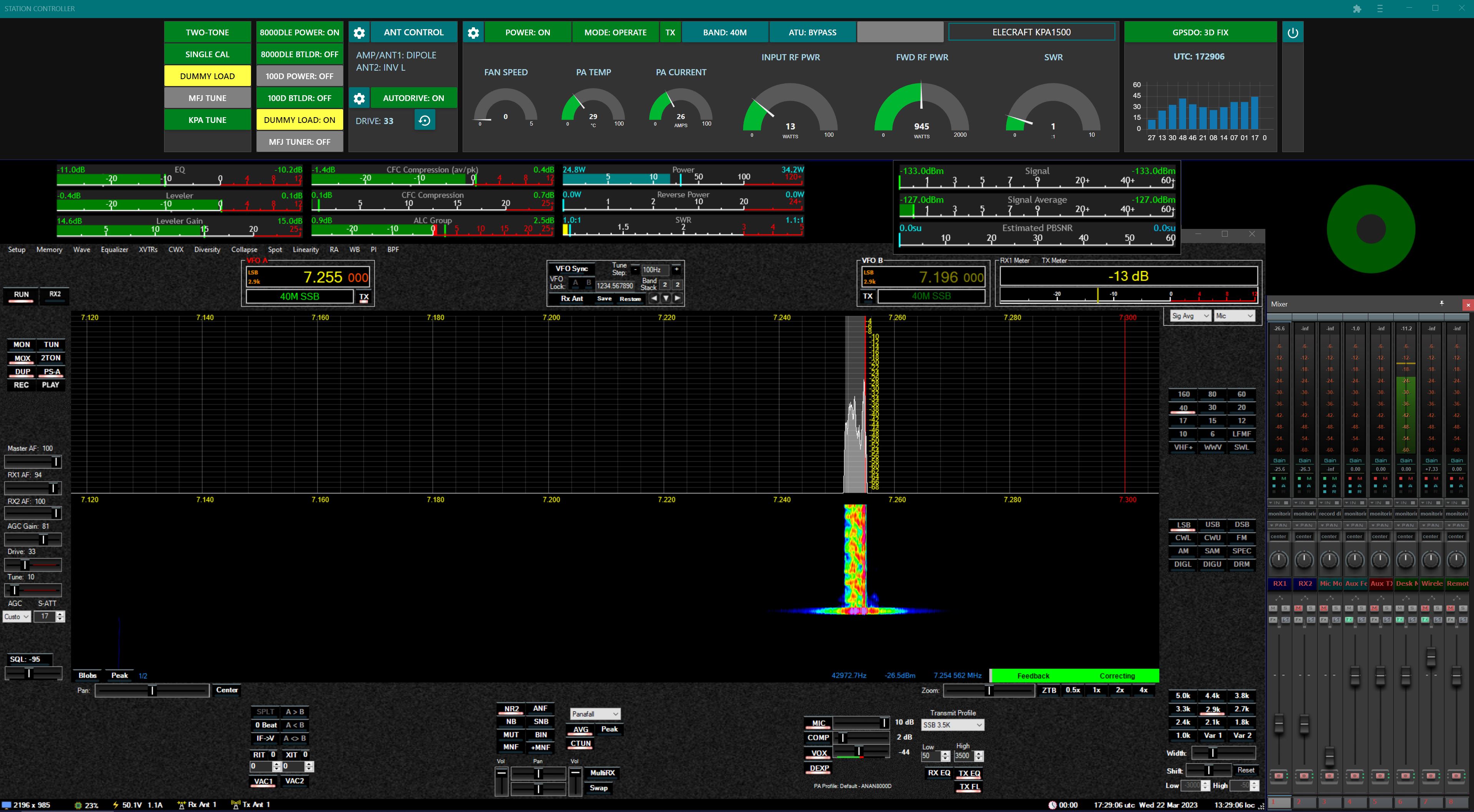

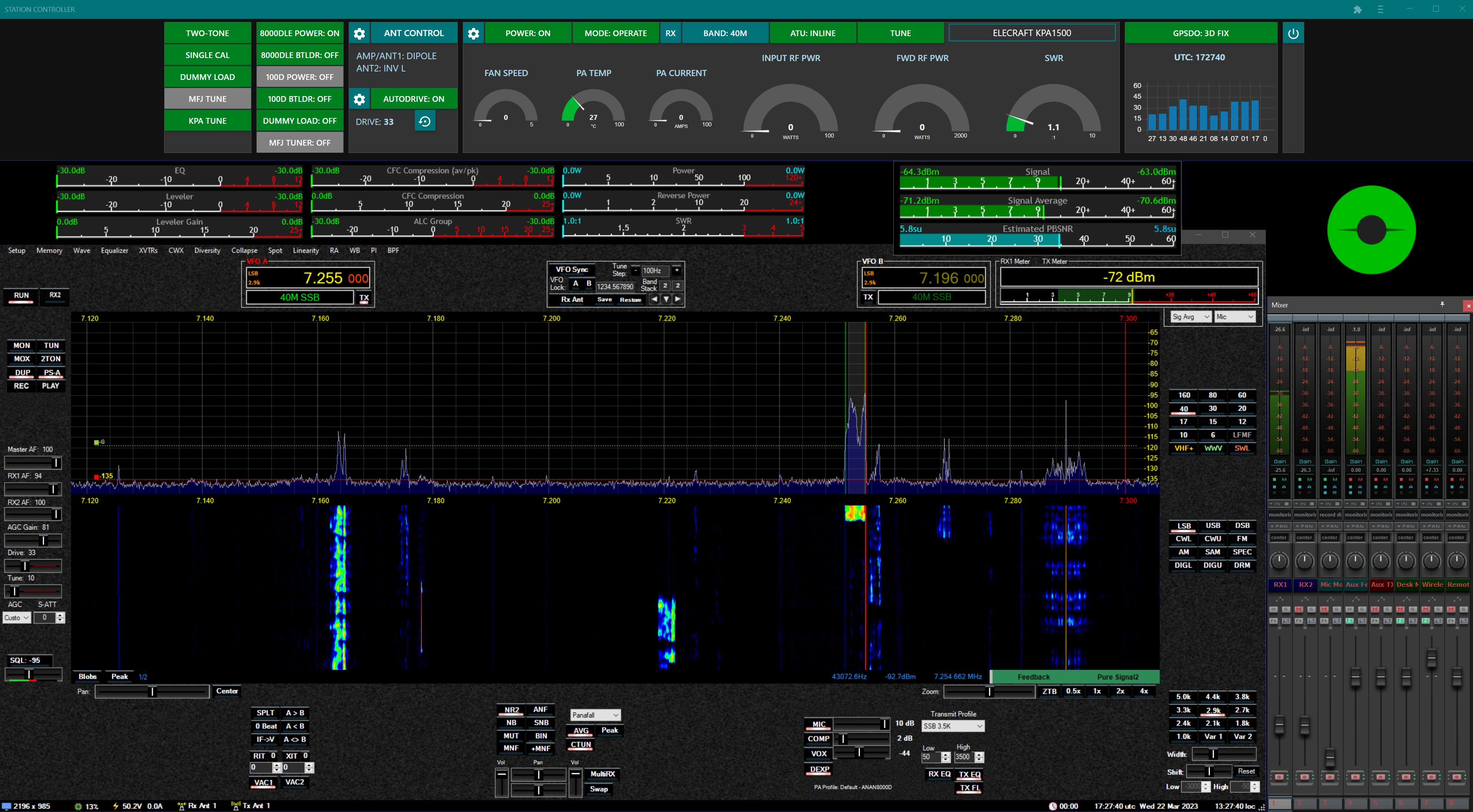

With the EVGA control panel blivet out of the way, a whole day's worth of fussing has evolved this layout, which uses an entire 4K display.
Right click and "Open in image in new tab" for full resolution.
Receive...
Transmit...
Too busy to talk on the radio, still fussing with the meters :D

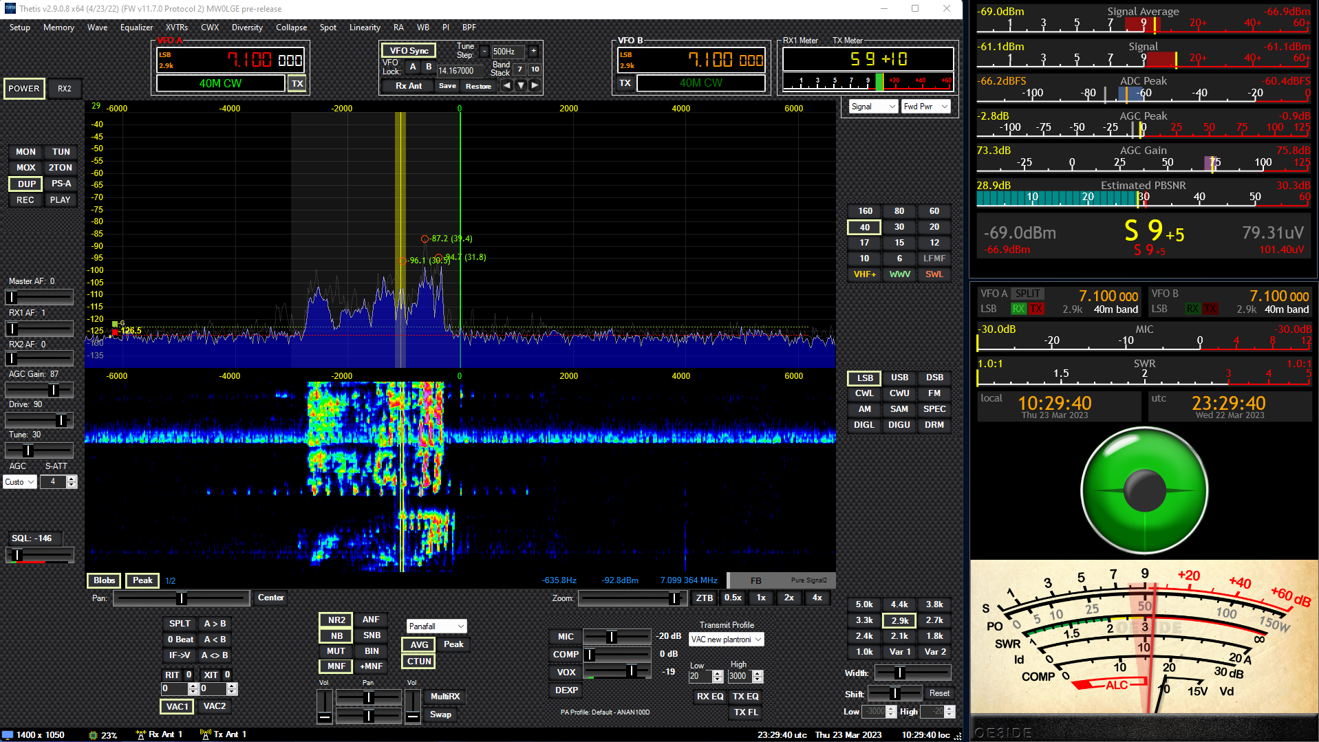

Below is a screenshot of my little “fiddle” with your fantastic pre-release.
Thetis v2.9.0.8 x64 - just playing with it.png (1.08 MiB) Viewed 24782 times
I love the concept of the “containers” and the ability of being able to virtually customize everything.
I can see that many of us will be very busy fiddling with this wonderful interface – to create our own little “masterpieces” of visual overload enjoyment as we use our radios. :D
