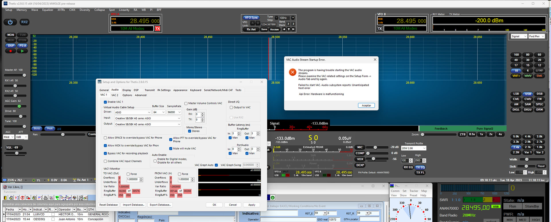

I'm geting this error very often when I start Thetis.
Any idea?
My audio settings are exactly the same I was using without any issue with ver. 2.8.0.9
PS: When I get this error I must reboot my PC and power cycle my radio to sucessfully start my setup.

I had that error after a windows update, the update had scrambled my audio (interface) from being recognized properly. In my case, I went into to windows audio setup and reset everything. This just happened two days ago after win update. Hope this helps.

ea3aqr wrote:I'm geting this error very often when I start Thetis.
Any idea?
Ha! I had to download your image to see it properly.
All I can suggest is that you try a different audio API. IN particular, WDM-KS has about the same latency as ASIO. I do have a friend, though, who uses ASIO with no trouble.

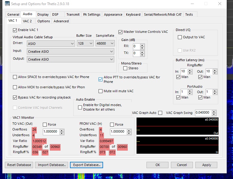

Any idea?
Just noticed that your PA buffer sizes are 0 (zero). Please note that this currently does not work for me, using any API Host. I set mine to 1.
Hope this helps!

nobba wrote:Guys,
How do you make the images that people post large?
my eyes are not good enough to see the audio trouble guy's picture!
I tried clicking on it, and nothing happens
Click and open in new windows for a larger screenshoot!

Jordi, make the following adjustments and see if that helps.
1) Increase your VAC1 Buffer Size to 256 (your current size of 64 may be too low).
2) Reduce your VAC1 Sample Rate to 48000 (your current rate of 96000 may be too high).
3) Increase your Ring Buffer latency (both In and Out) to 20 (your current setting of 3 may be too low).
If those adjustments work then you can gradually start bringing them back towards where you had them while watching for any glitches.

K1LSB wrote:Jordi, make the following adjustments and see if that helps.
Thanks, but negative... my settings worked fine for years without under/overflows using several versions of windows 10 or 11.
I always try to get the lowest stable latency settings I can achieve.
I was the guy who discovered the network throttling index tweak after searching for 2 month because one Windows 10 update broke my system stability that was running fine for years without any issue.
Seems that setting portaudio to 1 did the trick!

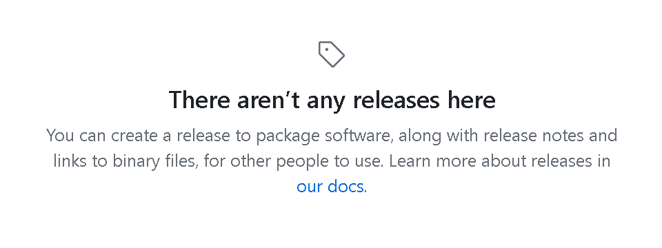

Hi Steve, I love your new versions of Thetis. The only issue I have is finding your new releases. Is there a new link. I went to the old one and there was nothing there. Keep up the great work! Thank you :D
NC3Z
Posts: 493
Location: Merritt, NC
Re: Understanding G7KLJ 2.9.0.11 release
Post by NC3Z »
It was here https://github.com/sjk7/Thetis-2.9.0/releases but now seems to have been removed.
