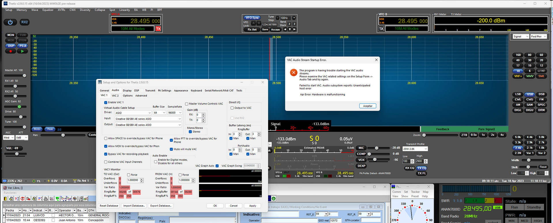

I'm geting this error very often when I start Thetis.
Any idea?
My audio settings are exactly the same I was using without any issue with ver. 2.8.0.9
PS: When I get this error I must reboot my PC and power cycle my radio to sucessfully start my setup.

I had that error after a windows update, the update had scrambled my audio (interface) from being recognized properly. In my case, I went into to windows audio setup and reset everything. This just happened two days ago after win update. Hope this helps.

Joe wrote:I had that error after a windows update, the update had scrambled my audio (interface) from being recognized properly. In my case, I went into to windows audio setup and reset everything. This just happened two days ago after win update. Hope this helps.
73’s
Thanks Joe.
Unfortunately I only had this issue after installing G7KLJ build, never with Richie's one.

I had the exact same error with vac not seeing my audio interface correctly, I believe G7KLJ’s software has the alert of vac error. When I started up the setup form would come up at first and the error would show. Hope you get it straight, I really like the new Thetis, works great here.

ea3aqr wrote:I'm geting this error very often when I start Thetis.
Any idea?
Ha! I had to download your image to see it properly.
All I can suggest is that you try a different audio API. IN particular, WDM-KS has about the same latency as ASIO. I do have a friend, though, who uses ASIO with no trouble.
You might also like to try ASIO4All just to see if stuff works in there. This version of Thetis uses the latest portaudio, which is why you see the different behaviour. I am sure you will get it working,
Steve, G7KLJ.
Any idea?
Just noticed that your PA buffer sizes are 0 (zero). Please note that this currently does not work for me, using any API Host. I set mine to 1.
Hope this helps!
Steve, G7KLJ

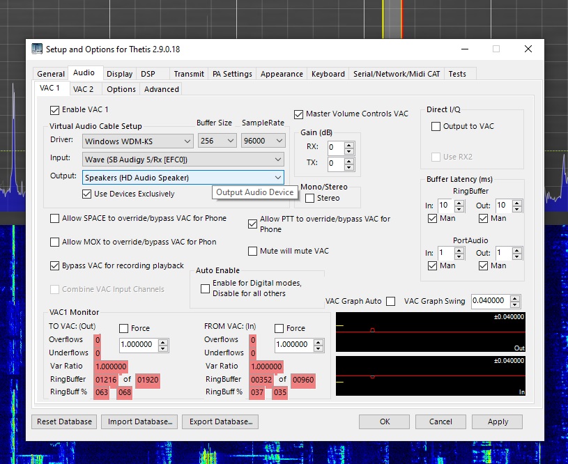

nobba wrote:Guys,
How do you make the images that people post large?
my eyes are not good enough to see the audio trouble guy's picture!
I tried clicking on it, and nothing happens
Click and open in new windows for a larger screenshoot!
Any idea?
Hope this helps!
Steve, G7KLJ
I will try and let you know!
ASIO4ALL (bad drivers AFAIK) or WDM-KS are no option for me, my Creative ASIO drivers worked flawesly with my Anan radio for so many years with a very low latency settings!

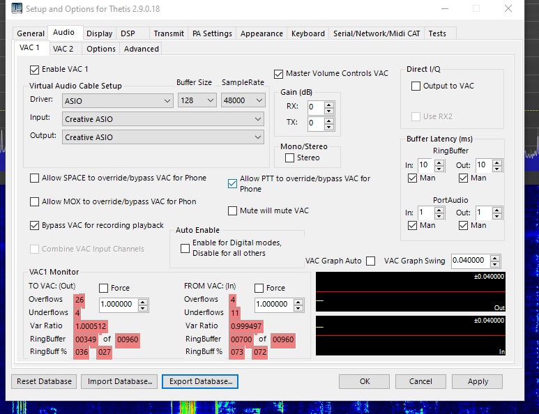

Jordi, make the following adjustments and see if that helps.
1) Increase your VAC1 Buffer Size to 256 (your current size of 64 may be too low).
2) Reduce your VAC1 Sample Rate to 48000 (your current rate of 96000 may be too high).
3) Increase your Ring Buffer latency (both In and Out) to 20 (your current setting of 3 may be too low).
If those adjustments work then you can gradually start bringing them back towards where you had them while watching for any glitches.

I'm running latest drivers, seems that port audio = 1 did the trick.

K1LSB wrote:Jordi, make the following adjustments and see if that helps.
Thanks, but negative... my settings worked fine for years without under/overflows using several versions of windows 10 or 11.
I always try to get the lowest stable latency settings I can achieve.
I was the guy who discovered the network throttling index tweak after searching for 2 month because one Windows 10 update broke my system stability that was running fine for years without any issue.
Seems that setting portaudio to 1 did the trick!
Yes, now I have studied the portaudio docs about this. And they don't have much to say. Apparently, when you set driver buffer size to zero, it is supposed to select a low latency, but with no guarantee of success. Richie's revision has an extremely old portaudio implementation, so we can assume that over the years they have changed how they handle a latency request of zero.
In my original rehash of Thetis, I have something to display the _actual_ latency you get in the UI. It's quite nice, and satifying to see what you actually end up with. Latency is shown in ms for both in and out. I will add it at some point.
Glad you have it working!
Steve, KLJ

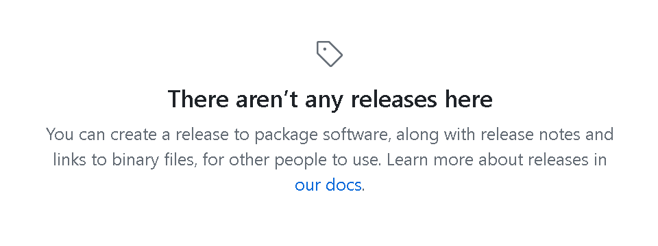

Hi Steve, I love your new versions of Thetis. The only issue I have is finding your new releases. Is there a new link. I went to the old one and there was nothing there. Keep up the great work! Thank you :D
Re: Understanding G7KLJ 2.9.0.11 release
Posted: Sun May 14, 2023 10:20 am
by NC3Z
It was here https://github.com/sjk7/Thetis-2.9.0/releases but now seems to have been removed.

Yeah they have been removed for some reason

That is odd. It was there yesterday morning. I wonder what happened?
Maybe he is getting ready to post another release.
