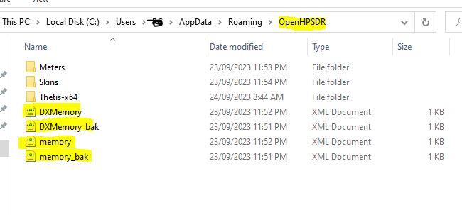

Well I managed to break the Band Stack issue by loading an Audio profile from another Database/version of Thetis into 2.10.1.
Luckly I had saved the original database to revert to without having to go through the process. So don't load saved/exported audio profiles. I had to recreate mine.

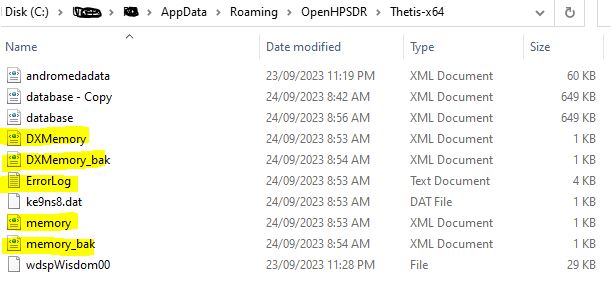

Also I am not sure why all the Memory/Memory_bak / DXMemory/DXMemory_bak files are also sitting in the Thetis-x64 folder where the DB and Wisdom files are. These files are located one folder back. There is also some ErrorLog text file too. See attached image. Each time I delete this and restart Thetis, they are back. Hmm :?

Terry,
I set everything up (band frequencies, modes etc) new database on v2.9.0.8 before upgrading to Thetis 2.10.1 over the top. So far it is still working. But I did break it when importing an Transmit Profile from another version/database.
The files I am seeing in the Thetis-x64 folder where the Thetis database and wisdom file is located. Normally those files are reserved to the folder 1 level up (refer to image below). They are still in that folder but duplicated in the folder I just mentioned. There is also an error log, which I don't see occuring in older versions of Thetis.

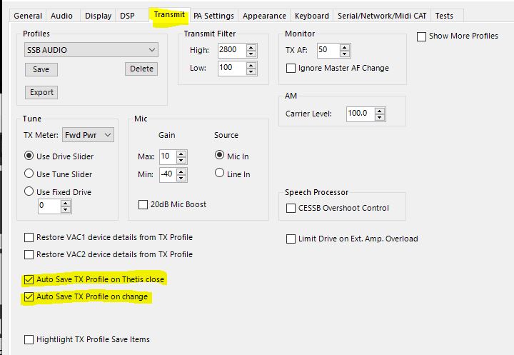

EDIT: I think I've worked out what the casue of this is. Working with WD5Y's version of Thetis 2.10.1, I like to select both the Auto Save TX Profile options (refer to image below). What I did was untick those options and now Thetis is remembering which Band Stack I was on (freq, Band and Mode etc) after closing an reopening.
If you're havng the same issue, Thetis not remembering the last use freq etc, check if you are using the Auto save TX Profile option (under the Transmit Tab in Setup) and uncheck it and see if that corrects the issue. If not, try WD5Y's version of Thetis 2.10.1.

Phil, you are definitely on to something with the auto save tick boxes on the transmit form! I just installed 2.10.1 so I could try Joe's version. When I first ran Thetis 2.10.1 it imported my 2.9.0.8 database as I forgot to press shift. Anyway, just as an experiment, I let it run with the imported database but first went to the transmit form and unticked those two boxes.
I am happy to say that so far, 2.10.1 is now working correctly! it is saving all my frequency, mode and band data on exit and restart. Lets see how it goes.

I can confirm, that saving Transmit Profile manually "does not" corrupt the database.

I've selected the Auto Save TX Profile on change. seems ok

Thanks for that Phil, so it is just the save on exit one we need to leave unchecked. I'll try that now.
This discovery also explains why not everyone is seeing the original problem. Not everyone will have those autosave options ticked in the first place.

Yep still works with save on change ticked, so the only one we need to leave unticked is "save transmit profile on Thetis close". Maybe this info should go in a new thread if it proves to work over the next few days. Might save other folks a lot of frustration!

I've tested the "Official" release of Thetis 2.10.1 and if I leave the "Save Tx Profile on Thetis close" unchecked the issue is not experianced. However I do have the "Save TX Profile on change" ticked and all good with the Band Stack saving.
I am also not seeing the duplication of Memory and DX memory files saved in 2 locations and the error log file is gone. Refer to previous images in posts above.
