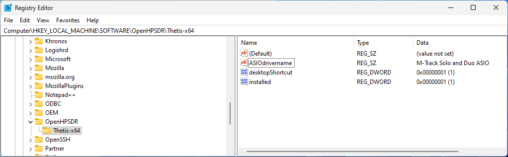

So I updated the registry key with
M-Track Solo and Duo ASIO
Started Thetis and still have the red CM icon with the same message

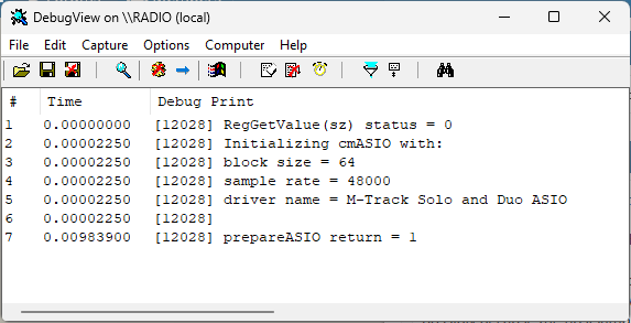

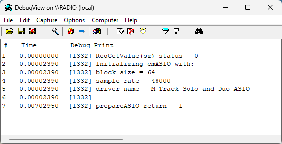

Debugview shows
00000001 0.00000000 [11076] RegGetValue(sz) status = 0
00000002 0.00001840 [11076] Initializing cmASIO with:
00000003 0.00001840 [11076] block size = 64
00000004 0.00001840 [11076] sample rate = 48000
00000005 0.00001840 [11076] driver name = M-Track Solo and Duo ASIO
00000006 0.00001840 [11076]
00000007 0.03536030 [11076] prepareASIO return = 1
Thats all
Any ideas?
Jim M0CKE

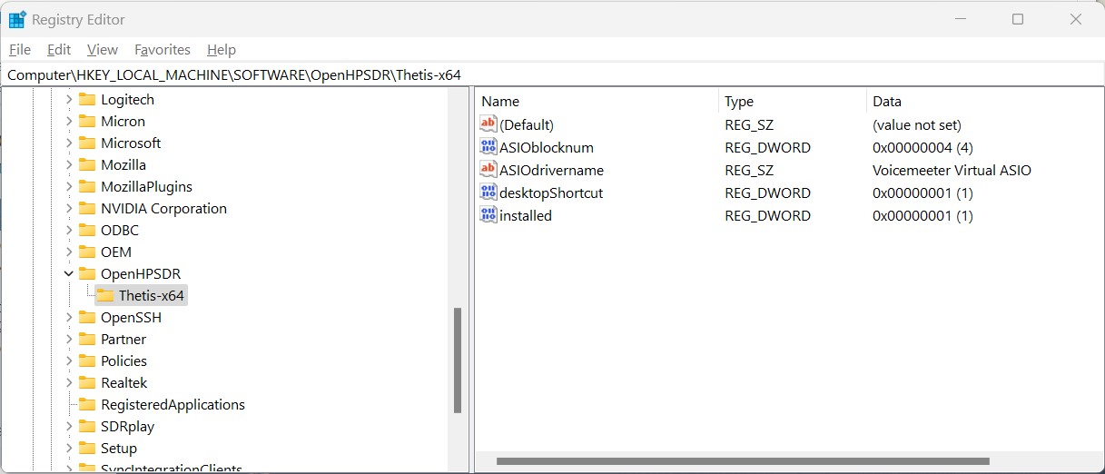

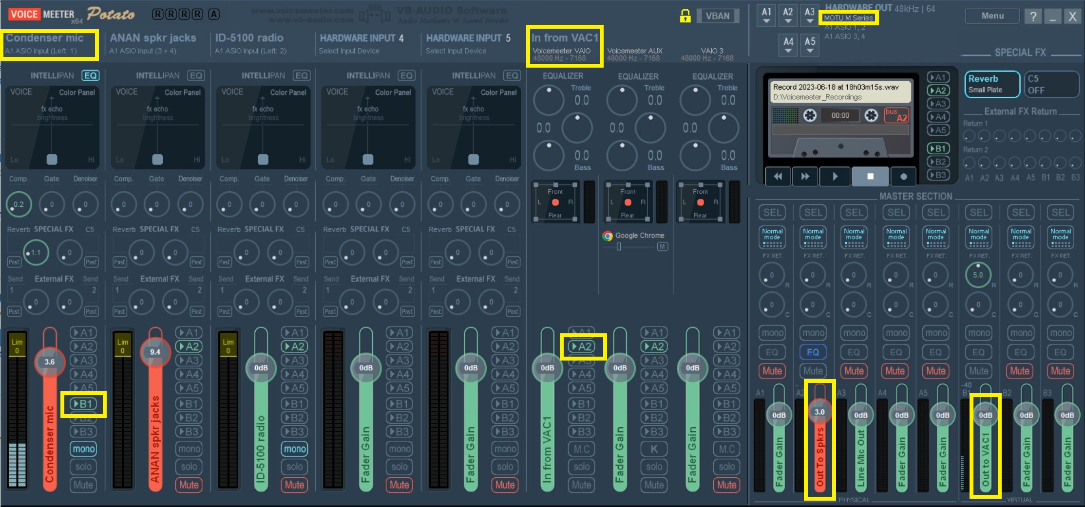

Jim,
If it helps, here's how I've got my setup:
Registry Setup.jpg (93.16 KiB) Viewed 30454 times
VMP Setup.jpg (529.56 KiB) Viewed 30454 times
Notice that I have the Registry pointing to "Voicemeeter Virtual ASIO", which is Voicemeeter's Channel 1. So any signal appearing on VM channel 1 output (my mic audio in this case) will get routed by cmASIO in Thetis to TX audio, and any RX audio will get routed by cmASIO to VM channel 1 input (which I have routed to the speakers).
Notice my Voicemeeter setup. My Motu M Series driver is used by VM channel 1 ( which is always assigned the reserved VM name "Voicemeeter Virtual ASIO" by Voicemeeter), which uses Virtual Input Strip B1 to capture RX audio coming in from Thetis (that Strip is labeled "In from VAC1") and uses Output Bus B1 to send TX audio out to Thetis (labeled "Out to VAC1") due to the cmASIO assignment in the Registry. In VM my mic audio is routed from Hardware Input Strip #1 (labeled "Condenser Mic") to Output Bus B1 where it gets sent to Thetis.
Hope that helps,
Edit: To clarify, the labels "In from VAC1" and "Out to VAC1" in VM were formerly used to feed audio back and forth from VAC1 but those I/O's are now captured by cmASIO (I just never bothered to change the label names).

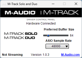

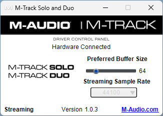

Exactly the same results, rebooted PC, M-Audio M-Track set to 48000 and buffer size 64
m-track 4800.png (26.79 KiB) Viewed 30292 times

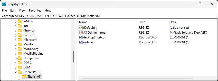

Registery set to the device
regedit 2.png (29.83 KiB) Viewed 30292 times

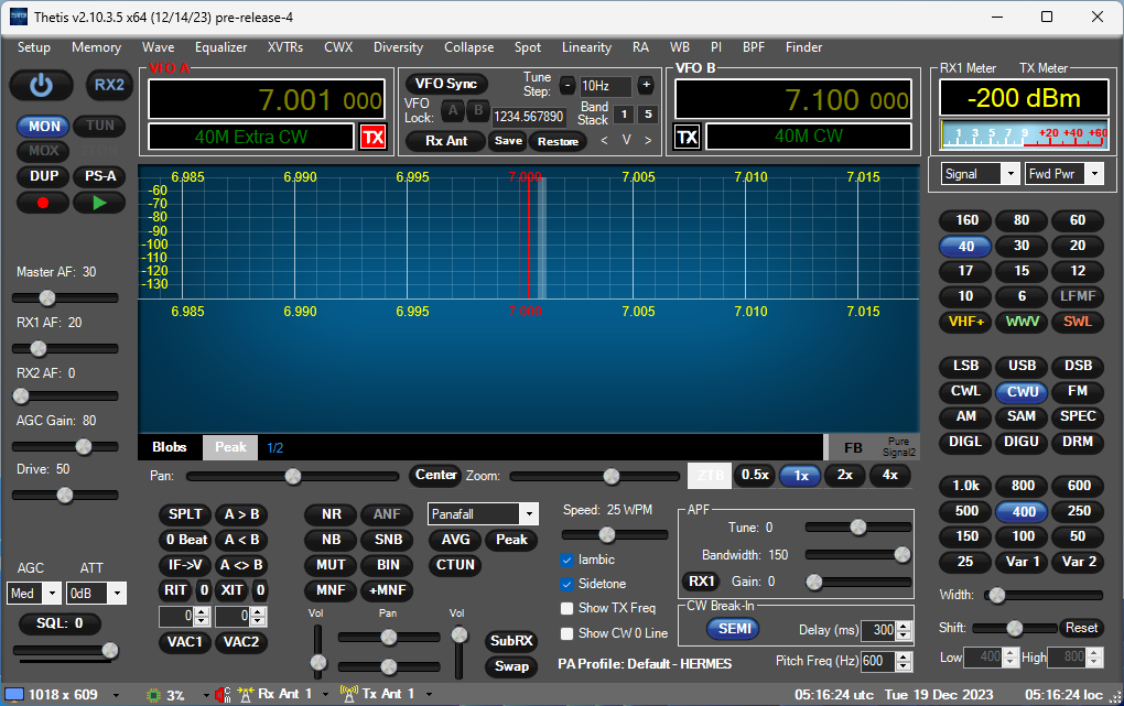

Start Thetis and get the red CM icon
thetis 2.png (126.24 KiB) Viewed 30292 times
Messages states "Issue starting CM ASIO. Check drive rname in registry
Same messages ininb DebugView
DeBugView 2.png (19.68 KiB) Viewed 30292 times

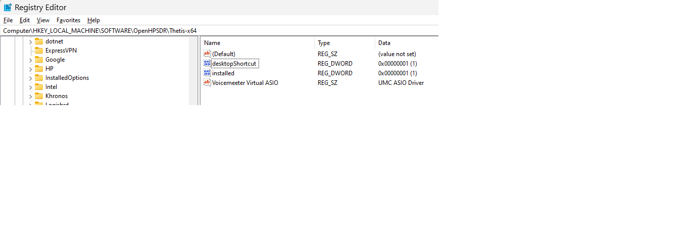

One more thing I just remembered you should check. When you populated the registry key value with your driver name, if you left a trailing space at the end of the driver name it will cause the failure to load that you're seeing. Please check that this isn't the case. Maybe you should re-enter the name to make sure.
Bryan

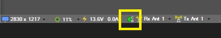

Running 2.10.3.5 pre-release 5 and I just noticed that the CM icon in the Thetis status bar is gone:
Anyone else seeing (rather, not seeing) this?
W4WMT
Posts: 346
Post by W4WMT »
Hi Mark,
Look to the right. Richie moved it for pre-release-5, but it's still there!
Bryan
Posts: 736
BOOM!! I see it, thanks Bryan!
Bryan

Post by m0cke »
W4WMT wrote:
m0cke wrote:Update from here
So I tried the M-Audio on a laptop, had the same results
Hi Jim,
As far as I know, you are the first user to try the M-Track Solo (or any M Audio device for that matter) with cmASIO. So, it's possible that the M-Track ASIO driver is just plain incompatible with cmASIO. I will have an M-Track Solo in my hands for testing late this afternoon. So let's see how that turns out, and we'll go from there. Hang in there and I will report back.
Bryan
Hi Bryan
OK thanks, Maybe a list of known working hardware is required, out of interest what hardware did you find that works out?
ASIO4ALL seems to work here which is software only on 3 different machines so far.
Jim M0CKE

K1LSB wrote:Running 2.10.3.5 pre-release 5 and I just noticed that the CM icon in the Thetis status bar is gone:
I am not seeing this. cmASIO seems to be working. I have it set up to deliver Thetis sound directly to the sound card via cmASIO. I am also using pre-release 5.
It's on the right side between CAT-Status icon and utc-clock.

OK, maybe I have something configured incorrectly. Hare are a couple of captures that might tell a story. My intention with the cmASIO feature is to send Thetis sound directly to the sound card which it seems to be doing.
Your screenshot is not not showing "ASIOdrivername" entry ?
"Add a new ‘String Value’ with the name ASIOdrivername.
Populate the new string value with the name of your ASIO drive"
rbduck wrote:
oe3ide wrote:
OK, maybe I have something configured incorrectly. Hare are a couple of captures that might tell a story. My intention with the cmASIO feature is to send Thetis sound directly to the sound card which it seems to be doing. capture.pngcapture2.png
