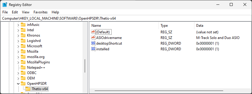

Hi Bryan
So I have the M-Audio M-Track Solo and have installed the software
Using hostsample I get
driverCount = 5
ASIO4ALL v2
M-Track Solo and Duo ASIO
Voicemeeter AUX Virtual ASIO
Voicemeeter Insert Virtual ASIO
Voicemeeter Virtual ASIO
Press any key to continue . . .

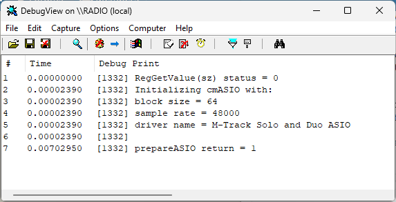

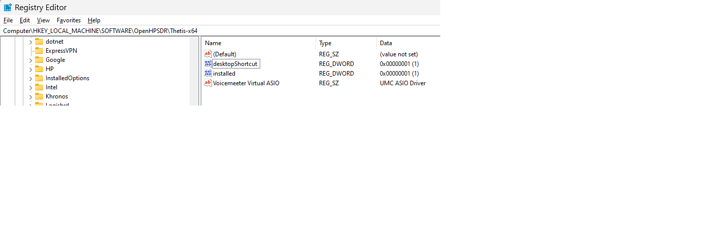

So I updated the registry key with
Started Thetis and still have the red CM icon with the same message
Debugview shows
00000001 0.00000000 [11076] RegGetValue(sz) status = 0
00000002 0.00001840 [11076] Initializing cmASIO with:
00000003 0.00001840 [11076] block size = 64
00000004 0.00001840 [11076] sample rate = 48000
00000005 0.00001840 [11076] driver name = M-Track Solo and Duo ASIO
00000006 0.00001840 [11076]
00000007 0.03536030 [11076] prepareASIO return = 1
Thats all
Any ideas?
Jim M0CKE

m0cke wrote:So I have the M-Audio M-Track Solo and have installed the software
driverCount = 5
ASIO4ALL v2
Hi Jim,
Was that the only output from hostsample? No details shown for the M-Audio device?
The error code from debugview shows the driver didn't load, which usually means the device is not running, or another app has captured it.
Also, if you didn't get any output from hostsample about the M-Audio, that means it's not running, or another app has captured it.
As Ernst says above, Voicemeeter may have captured the driver, make sure Voicemeeter is not running.
Can you double check things
Bryan

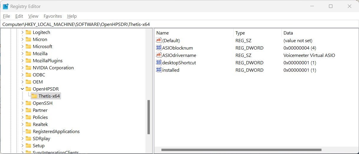

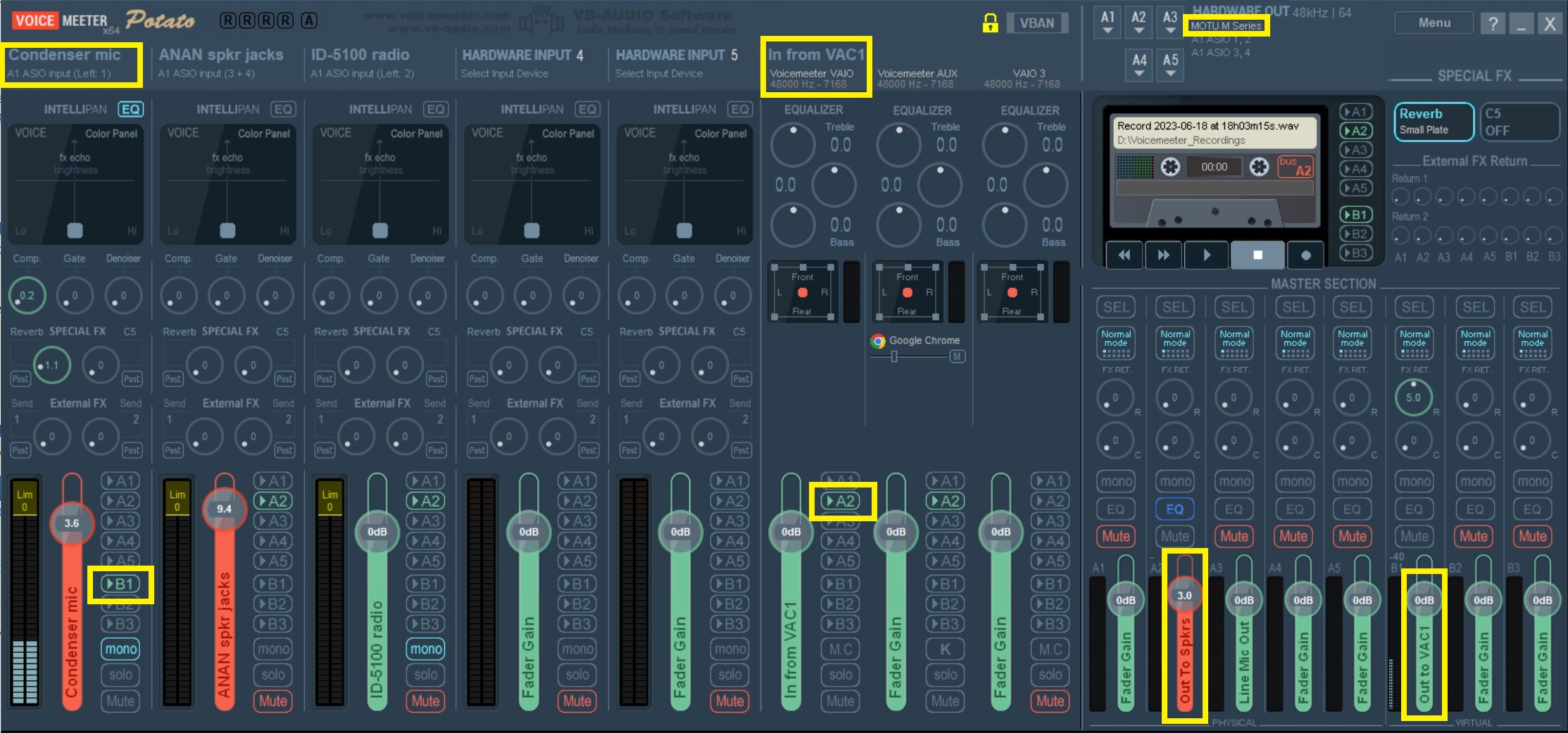

Posted: Tue Dec 19, 2023 2:00 am
Jim,
If it helps, here's how I've got my setup:
Registry Setup.jpg (93.16 KiB) Viewed 30456 times
VMP Setup.jpg (529.56 KiB) Viewed 30456 times
Notice that I have the Registry pointing to "Voicemeeter Virtual ASIO", which is Voicemeeter's Channel 1. So any signal appearing on VM channel 1 output (my mic audio in this case) will get routed by cmASIO in Thetis to TX audio, and any RX audio will get routed by cmASIO to VM channel 1 input (which I have routed to the speakers).
Notice my Voicemeeter setup. My Motu M Series driver is used by VM channel 1 ( which is always assigned the reserved VM name "Voicemeeter Virtual ASIO" by Voicemeeter), which uses Virtual Input Strip B1 to capture RX audio coming in from Thetis (that Strip is labeled "In from VAC1") and uses Output Bus B1 to send TX audio out to Thetis (labeled "Out to VAC1") due to the cmASIO assignment in the Registry. In VM my mic audio is routed from Hardware Input Strip #1 (labeled "Condenser Mic") to Output Bus B1 where it gets sent to Thetis.
Hope that helps,
Edit: To clarify, the labels "In from VAC1" and "Out to VAC1" in VM were formerly used to feed audio back and forth from VAC1 but those I/O's are now captured by cmASIO (I just never bothered to change the label names).

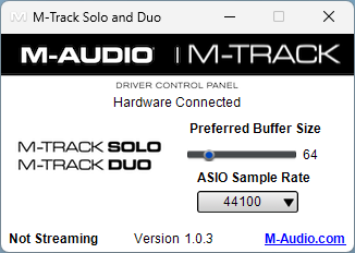

Hi Brian
I've removed Voicemeeter and ASIO4ALL, now I just have the 1 ASIO device, hostsample shows this and can sucessfully start the device as seen below
driverCount = 1
ASIO driver: [0] = M-Track Solo and Duo ASIO
asioVersion: 2
driverVersion: 3501
Name: [M-Track Solo and Duo ASIO]
ErrorMessage: No ASIO Driver Error
ASIOGetChannels (inputs: 2, outputs: 2);
ASIOGetBufferSize (min: 16, max: 2048, preferred: 64, granularity: 16);
ASIOGetSampleRate (sampleRate: 44100.000000);
ASIOOutputReady(); - Supported
AsioCanReportOverload Not Supported
ASIOGetLatencies (input: 175, output: 174);
channel: 0 isInput: 1 isActive: 1 channelGroup: 0 type: 18 name: In 1
channel: 1 isInput: 1 isActive: 1 channelGroup: 0 type: 18 name: In 2
channel: 0 isInput: 0 isActive: 1 channelGroup: 0 type: 18 name: Out 1
channel: 1 isInput: 0 isActive: 1 channelGroup: 0 type: 18 name: Out 2
ASIO Driver started successfully.
Closing hostsample the M-Audio device goes into Not Streaming
Regedit shows the correct device
Now starting Thetis I still get the red CM and M-Audio is still in Not Streaming DeBugView shows it's initialising cmASIO
I'm really at a loss as i've reset the thetis database, just in case.
Hair getting thinner ;)
Jim M0CKE

Try changing the sample rate from 44100 to 48000
Posted: Tue Dec 19, 2023 9:39 am
by W4WMT
That's correct Tony, about the sampling rate.
Repeat all of yours above, but this time with the M-Audio sampling rate having been set to 48000 in advance.
Looking at your debugview output suggests that you may have had the hostsample detail screen open while Thetis was trying to start. Because it's not even making it to the part where it would try to change the M-Audio sample rate from 44.1 to 48. It's not able to load the M-Audio driver, possibly because the hostsample detail screen had the driver open at the same time.

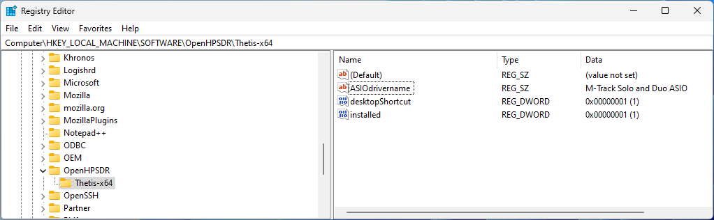

Exactly the same results, rebooted PC, M-Audio M-Track set to 48000 and buffer size 64
m-track 4800.png (26.79 KiB) Viewed 30294 times
Registery set to the device
regedit 2.png (29.83 KiB) Viewed 30294 times
Start Thetis and get the red CM icon
thetis 2.png (126.24 KiB) Viewed 30294 times

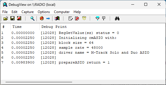

Messages states "Issue starting CM ASIO. Check drive rname in registry
Same messages ininb DebugView
DeBugView 2.png (19.68 KiB) Viewed 30294 times
I'm going to try the M-Audio on a different PC
Jim M0CKE

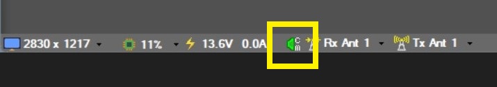

Posted: Wed Dec 20, 2023 12:38 am
Running 2.10.3.5 pre-release 5 and I just noticed that the CM icon in the Thetis status bar is gone:
Anyone else seeing (rather, not seeing) this?
Posted: Wed Dec 20, 2023 12:51 am
by W4WMT
Hi Mark,
Look to the right. Richie moved it for pre-release-5, but it's still there!
Bryan
Posted: Wed Dec 20, 2023 1:00 am
BOOM!! I see it, thanks Bryan!

m0cke wrote:Update from here
So I tried the M-Audio on a laptop, had the same results
Hi Jim,
As far as I know, you are the first user to try the M-Track Solo (or any M Audio device for that matter) with cmASIO. So, it's possible that the M-Track ASIO driver is just plain incompatible with cmASIO. I will have an M-Track Solo in my hands for testing late this afternoon. So let's see how that turns out, and we'll go from there. Hang in there and I will report back.
Bryan
Hi Bryan
OK thanks, Maybe a list of known working hardware is required, out of interest what hardware did you find that works out?
ASIO4ALL seems to work here which is software only on 3 different machines so far.
Jim M0CKE

K1LSB wrote:Running 2.10.3.5 pre-release 5 and I just noticed that the CM icon in the Thetis status bar is gone:
I am not seeing this. cmASIO seems to be working. I have it set up to deliver Thetis sound directly to the sound card via cmASIO. I am also using pre-release 5.
Posted: Wed Dec 20, 2023 5:06 pm
by oe3ide
It's on the right side between CAT-Status icon and utc-clock.
Posted: Wed Dec 20, 2023 5:25 pm
by rbduck
oe3ide wrote:
OK, maybe I have something configured incorrectly. Hare are a couple of captures that might tell a story. My intention with the cmASIO feature is to send Thetis sound directly to the sound card which it seems to be doing.
Posted: Wed Dec 20, 2023 5:31 pm
by Tony EI7BMB
Your screenshot is not not showing "ASIOdrivername" entry ?
"Add a new ‘String Value’ with the name ASIOdrivername.
Populate the new string value with the name of your ASIO drive"
rbduck wrote:
oe3ide wrote:
OK, maybe I have something configured incorrectly. Hare are a couple of captures that might tell a story. My intention with the cmASIO feature is to send Thetis sound directly to the sound card which it seems to be doing. capture.pngcapture2.png
