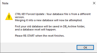

It will require CTRL to be held as you launch it to update the database as a new entry as been added to the TX Profile table. Please make note of any DB settings you lose during this process this and I will work towards maintaining these settings in future updates.

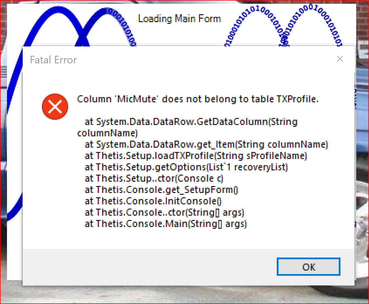

My first glitch this morning, every update from 21a 64bit to 21e 64bit has been error-free. Of course, holding down CTRL to install. But with 21f after the routine, I get Fatal Error with this message when starting up..
Screenshot 2021-07-31 084944.jpg (32.9 KiB) Viewed 24167 times
N4QNT wrote:My first glitch this morning, every update from 21a 64bit to 21e 64bit has been error-free. Of course, holding down CTRL to install. But with 21f after the routine, I get Fatal Error with this message when starting up.. Screenshot 2021-07-31 084944.jpg
Looks like the database has not been updated. Did you get both messages (on first start with ctrl pressed and on 2nd start)?

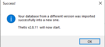

@N4QNT did you resolve this? Like Ernst said, it looks like the DB has either not been updated, or is now in a condition that cant be updated. Hold CTRL not during the install (which is just copying the files from the zip over the top of the files in the install folder), but hold it during the launch process when you click/double click the Thetis shortcut. You should see :
followed by
and then after you restart Thetis again
Note: these message boxes may end up behind other windows, obscured, so you may have missed them, and perhaps have now another Thetis running in the background. This issue is on the list of things to fix.

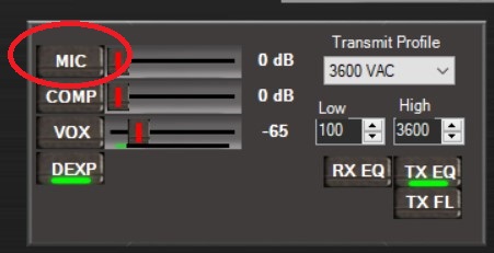

Dumb question, where is the mic mute feature located?

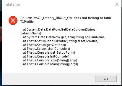

I
I get this error when trying to install 21f. It's been smooth sailing until now. I know it states it is the micmute issue. Any suggestions.

W9BHI wrote:where is the mic mute feature located?
Mic Mute.jpg (25.9 KiB) Viewed 24090 times

All had gone well up to this time on all the updates. I thought that I had followed the instructions, but guess not. I went back and did a reinstall and it loaded as it should have. Makes me feel kind of stupid when stuff like this happens! :oops: I'll be more careful next time :D . Thanks again for all your hard work!!
Posts: 1595
W4GM wrote:Thanks Richie,
ah good stuff Mike. Yes, the CTRL thing is not ideal, but it saves having to update version numbers. Thetis could better handle the DB being all out of whack though I must admit.

Thanks for the response Richie, yes after the Zip overlay I hold the CTRL double-click thests.exe, got the Blue anyway window saw all the popup windows you mentioned about DB overwrite and Re-start, then after that re=start is when I got the VAC fatal error.. So not the end of the world I'm ready to start with a fresh uninstall/reinstall then I guess I can try again jumping right to 21f I presume?
w-u-2-o wrote:Is it not time to deprecate both GDI+ and the 32 bit version?
yes Scott gdi+ is getting ignored now and getting left behind, it needs to go. 5 downloads of the 32bit 21f patch, vs 43 downloads of the 64bit version, so perhaps x86 should stay ;)
followed by

Well, you could rename your database.xml file, this will cause Thetis to make a new one. Either way could you send me your DB. My email is over on QRZ.
the file is in C:\Users\<you>\AppData\Roaming\OpenHPSDR\Thetis-x64 or C:\Users\<you>\AppData\Roaming\OpenHPSDR\Thetis
depending if you are running the 64 or 32 bit version.

All good here now Richie.. I had the YIPS with the mouse today. 21F working wonderfully. I thought I read somewhere you mentioned maybe with 21F configuring the MIDI controller to tap the 2TON button :)))) pretty please
