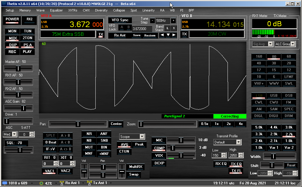

  • fix: scope views now work again in TX mode (spectra scope panadapter issue still exists - todo)
Signal is distorted, looks like aliasing due to wrong samplerate.
  • fix: scope now renders in DX2 correctly using filled geometry
Cannot get the point on filled geometrie? A scope trace is a simple line by definition.
In distorted TX trace there are flashing up large areas occasionaly.

I will investigate that TX scope issue, seems to be more obvious at very short sample frame times.
ANAN100 has now been removed from the 31db limit. It sneaked its way in somehow ;) 21h will see that change at some point.

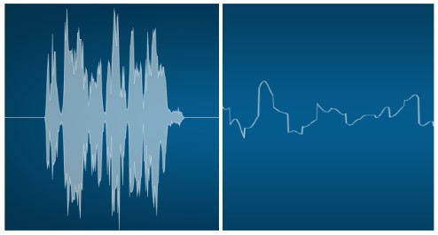

Ref the fill. If you look at 2.8.11 display.cs DrawScope (gdi source to make it easier) you will see it actually uses a min/max for each pixel and with that creates a enclosed complex filled shape which defines the scope display (the majority of work is done through DoScope or DoScope2 in audio.cs). The min/max comes into play with slow frame times as you can see in the pic below, and it is not as simple as a single point. There are a number of samples per pixel, which will require a min/max value of those samples. Anyway, short story is DX2 version of DoScope was only drawing max points, so gaps would show up from time to time. It has now been recoded to be the same as the GDI version, which is draw lines and then fill poly.
