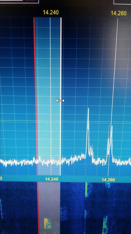

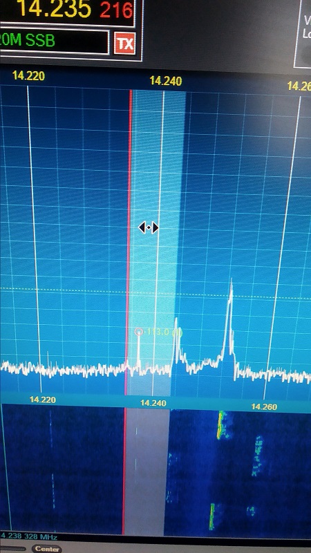

Posted: Sun Sep 12, 2021 8:12 am
by oe3ide
add: filter edges are hightlighted by mouse when you are able to drag them
add: you can now resize filter in CTUN by hovering mouse on an edge and dragging
Using 21h2 - in CTUN mode:
Highlighting works, but moving the line does not alter the rx-filter, instead its tuning the vfo.
Same problem here.
Posted: Sun Sep 12, 2021 9:33 am
by DH1KLM
For me it works without problems.
Big arrow changes VFO
Small arrow changes Filter
Posted: Sun Sep 12, 2021 10:01 am
by sv1jso
Also here works without a problem.
