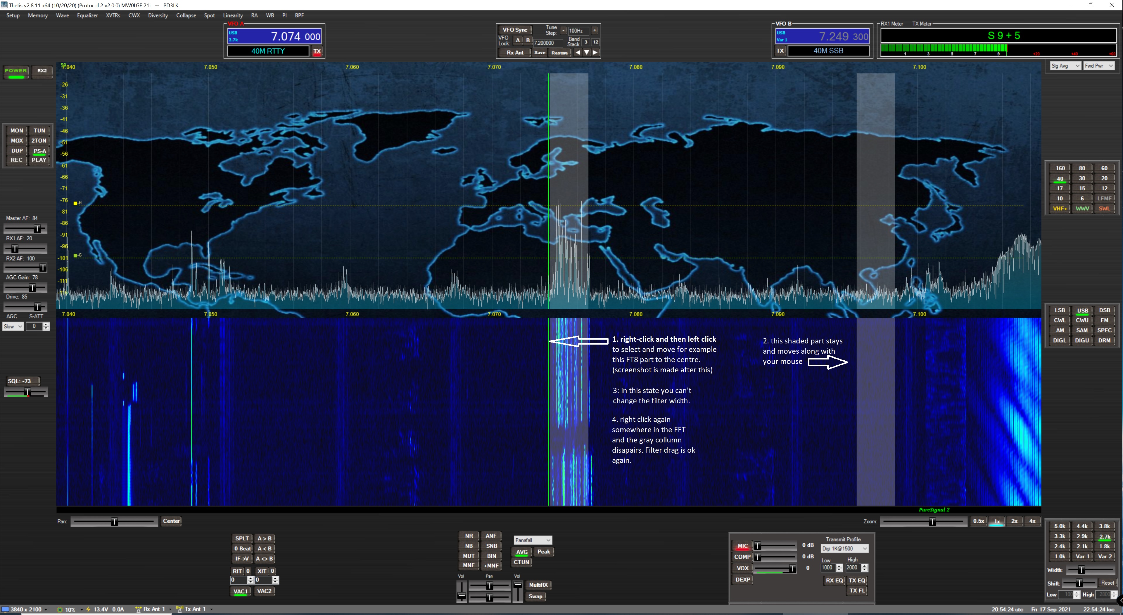

It's something different, i made it more simple with a screenshot and some text in it.
This issue isn't related to the band stack or the "show on panadapter".
- Filter drag issue.jpg (1.41 MiB) Viewed 24296 times
Right click puts it into a mode where you left click to qsy. When it is in that mode the filters can not be dragged until you right click again to take it out of the right click to qsy mode (abort). This is how it works, and has always worked.
