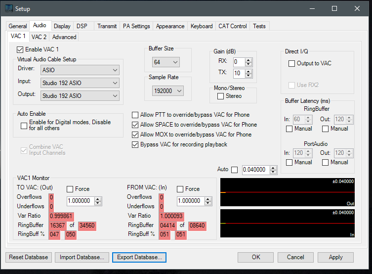

Posted: Sun Sep 19, 2021 6:25 am
w9mdb wrote:I see the little white lines too on N1ZLE's VAC1 Monitor plots.
What does the white line mean?
ring buffer occupancy %, at the bottom 0%, 100% at the top. Ideally RB should be 50% occupied, so the yellow line should be in the middle
Posted: Sun Sep 19, 2021 1:11 pm
What variables influence RingBuffer occupancy, and how can we best target a 50% occupancy?
TIA,
Posted: Sun Sep 19, 2021 1:31 pm
The resampler handles the buffer occupancy. There is little you can do to influence it. You can achieve small changes by changing the feedback gain value on the Advanced tab, but even dramatic changes don't make huge differences.
