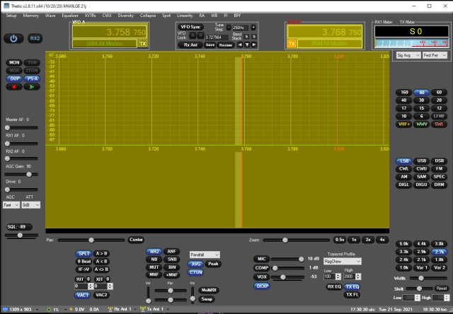

UPDATE 21j - 24/09/21
Post #1 updated with 21j, ready for the weekend. Please note, there have been changes to the OC pin outs. Also, step size is only stored against RX1 modes. There is some slight 'bodge' code around this area until RX2 gets its own step.
I have also added my extra IK3VIGspecial buttons as a direct download in post#1.
21j Update video : https://youtu.be/npsctPDI2U4
Additional warning for this update.
Please make sure you fully test and get the OC outputs you expect before hooking something up to it that might release the magic smoke.
21j
fix: vac advanced slew setting now updated when the setting is changed in setupform
fix: penny now told when TX VFOb, so will now pick correct VFOb band for OC pin assignments
fix: labels on VFOB box show correct mode and filter when RX1 is the only rx in use
fix: when leaving TUN the TX meter will now show the correct meter. Caused when TX meter and TUN meter were the same
fix: if in DIGU/L and a TX profile is loaded we now turn off TXeq/dexp/leveler/comp/rxeq/anf/nr/cessb/cfc/phaserot
fix: when selecting a transverter from VHF+ button, if there are no stack entries you will be taken to middle of the transverter range. Previously it would take you to 0MHz
add: additional advanced audio settings exposed
add: OC tx pinout action. Can specify when a pin will enable, based on mox, tune or 2tone state
add: hardware pin state shown on OC setup tabs. green 'leds' for rx state, red for tx state
add: xPA button appears on main console if you have any OC TX pin set as an externalPA control in OC control. This button acts as a master control for any pin assigned as an externalPA pin. When the button is off the pin will always be 0.
add: RX1 + RX2 mute button now mutes audio over VAC
add: diversity form, always on top option
add: tune step is stored against mode, and recovered when mode is changed. Also new option to enable this in Options, default off. Note, only works with RX1 at this time.
add: external PA cat command ZZUP, and midi button to enable/disable xPA button

ps: I just noticed that when I set master AF to 0, I can't hear logically anything on RX2 either. RX2 often runs on the ssb call qrg while I have FT8 running on RX1/TX.

Hi Rich
"Unfortunately I don't agree with the change 'add: RX1 + RX2 mute button now mutes audio over VAC'.
Using the MUT button to turn off the FT8 noise in the Powerspeakers while WSJT continued to run was a big advantage.
Maybe it's just me, but for me it's a step backwards to have to push the master volume slider to get rid of the annoying sounds because I don't have another volume control within reach :-) Is it possible to change this behaviour via a switch in the setup?"
I agree with Thomas
