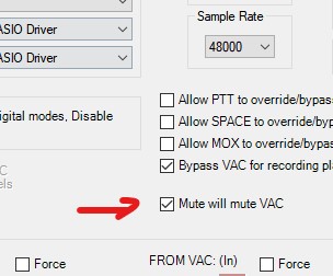

Mike wrote:Hi Rich
"Unfortunately I don't agree with the change 'add: RX1 + RX2 mute button now mutes audio over VAC'.
Using the MUT button to turn off the FT8 noise in the Powerspeakers while WSJT continued to run was a big advantage.
Maybe it's just me, but for me it's a step backwards to have to push the master volume slider to get rid of the annoying sounds because I don't have another volume control within reach :-) Is it possible to change this behaviour via a switch in the setup?"
I agree with Thomas
Mike G8ALS
Yep, will add option to exclude vacs from mutes. Probably be an update later tonight or tomorrow.

UPDATED to 21j2
You can now prevent the vacs from muting.
21j2
add: options to include VACs when MUTE is enabled, for both vac1 and vac2 (Setup->Audio->VAC1/2->[Mute will mute VAC] )

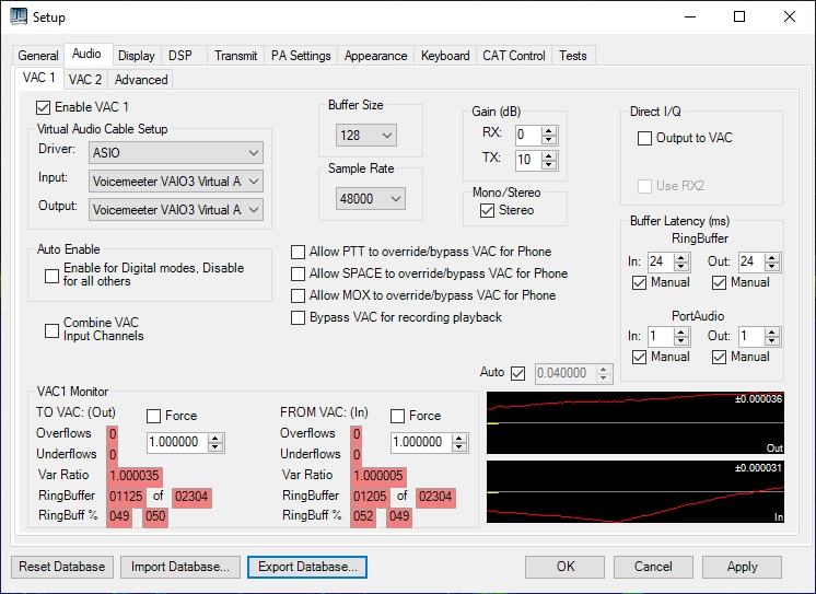

The advanced VAC settings are reset to defaults on 21j & 21j2 after restart

Posts: 1588
just a heads up, the saving of advanced audio is dead as a dodo in 21j/21j2 . I have resolved it, but working on something else tonight so will attempt to get fixes out tomorrow.
My vac audio has runaway overflows/underflows now on startup in 21J . Previously it was solid. Anyone seeing any issues ?
VAC is stable here with 21j
Vielen dank Ernst, I will try J2 now
