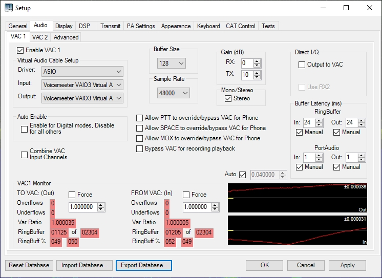

by ea3aqr
The advanced VAC settings are reset to defaults on 21j & 21j2 after restart

just a heads up, the saving of advanced audio is dead as a dodo in 21j/21j2 . I have resolved it, but working on something else tonight so will attempt to get fixes out tomorrow.
Posted: Sat Sep 25, 2021 10:33 am
by Tony EI7BMB
My vac audio has runaway overflows/underflows now on startup in 21J . Previously it was solid. Anyone seeing any issues ?
Posted: Sat Sep 25, 2021 10:51 am
by oe3ide
VAC is stable here with 21j
Posted: Sat Sep 25, 2021 11:25 am
by Tony EI7BMB
Vielen dank Ernst, I will try J2 now
Posted: Sat Sep 25, 2021 11:34 am
by w9ac
