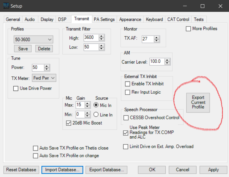

I loaded the latest 2.6.8 this evening to give it a try. Got it loaded and then went to load my tx profiles only to find that they are no longer standalone files in the Thetis directory but are now incorporated in the database.xml file. Not sure which version of 2.6.8 this started in but it seems to be in the latest and as far back as the 9/9/2019 version. I had saved my latest changes in these files from my last 2.6.8 test version "assuming" they were saved in the Thetis directory as standalone files as usual before I updated to this latest version. I deleted my database.xml file before updating to this version but fortunately had a backup and the previous version still available so I have access to them but am not sure how to get them out of that database into this new, latest version database other than just using that older database and letting the latest version "import and use" it which I'm not sure is the best idea with all the changes going on.
This presents a problem in that you now can't delete your database to do a complete reinstall as you will be deleting your tx profiles too and I don't see a way around this unless I'm just missing something.
Is there a way to do this that I am missing?
Joe W4WT
NC3Z
Posts: 493
Location: Merritt, NC
Re: 2.6.8
Post by NC3Z »
Why don't you just export your TX profiles?
W4WT
Posts: 172
Location: Cumming, GA
Re: 2.6.8
Post by W4WT »
Senility is definitely setting in Gary. Thanks!

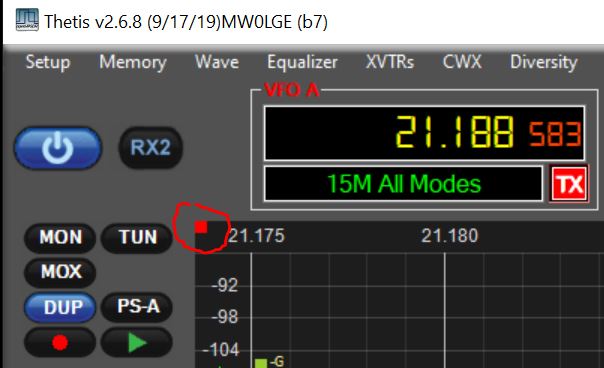

Try this version : https://www.dropbox.com/s/srhq9rm6rvlob ... 9.zip?dl=0
I have just quickly added an indicator, that will show top left of spectrum/waterfall. A red indicator will show if the render thread is not achieving requested fps. Turn your fps down until this red indicator turns off 99.9% of the time. I can just about manage 40fps at 4k full screen on a 680GTX when showing panafall (with disable picDisplay enabled and no spot background).

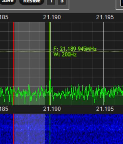

Also, in this build (b7) :
Notch filter gui, still work in progress. No gui resize of notch as yet. Not fully tested, bugs to be found I am sure.
- Click +MNF to add a notch filter at current VFOA frequency, 200Hz wide. Shift click +MNF to add one 100Hz wide.
- Middle click a notch to toggle active state (it turns a feint grey and text pop out is red when inactive)
- Shift middle click a notch to delete it
- Drag notch to move, change only apply after release
- MNF toggle state will make all notches turn feint shade
- mouse over a notch to give pop out details

Great work, I notice that red dot flashing every now and then, may be time for a better video card :-)
Running dual RX both in Panafall I can run @ 40FPS with no red indicator. But if I switch to Collapse mode I need to go to 30FPS.
But I am not getting the clicks and pops like I did with b5.

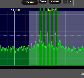

Manual multi tracking notch filters, work in progress video. Still a couple of things to tidy up.
https://youtu.be/LQdpbv1aD9g

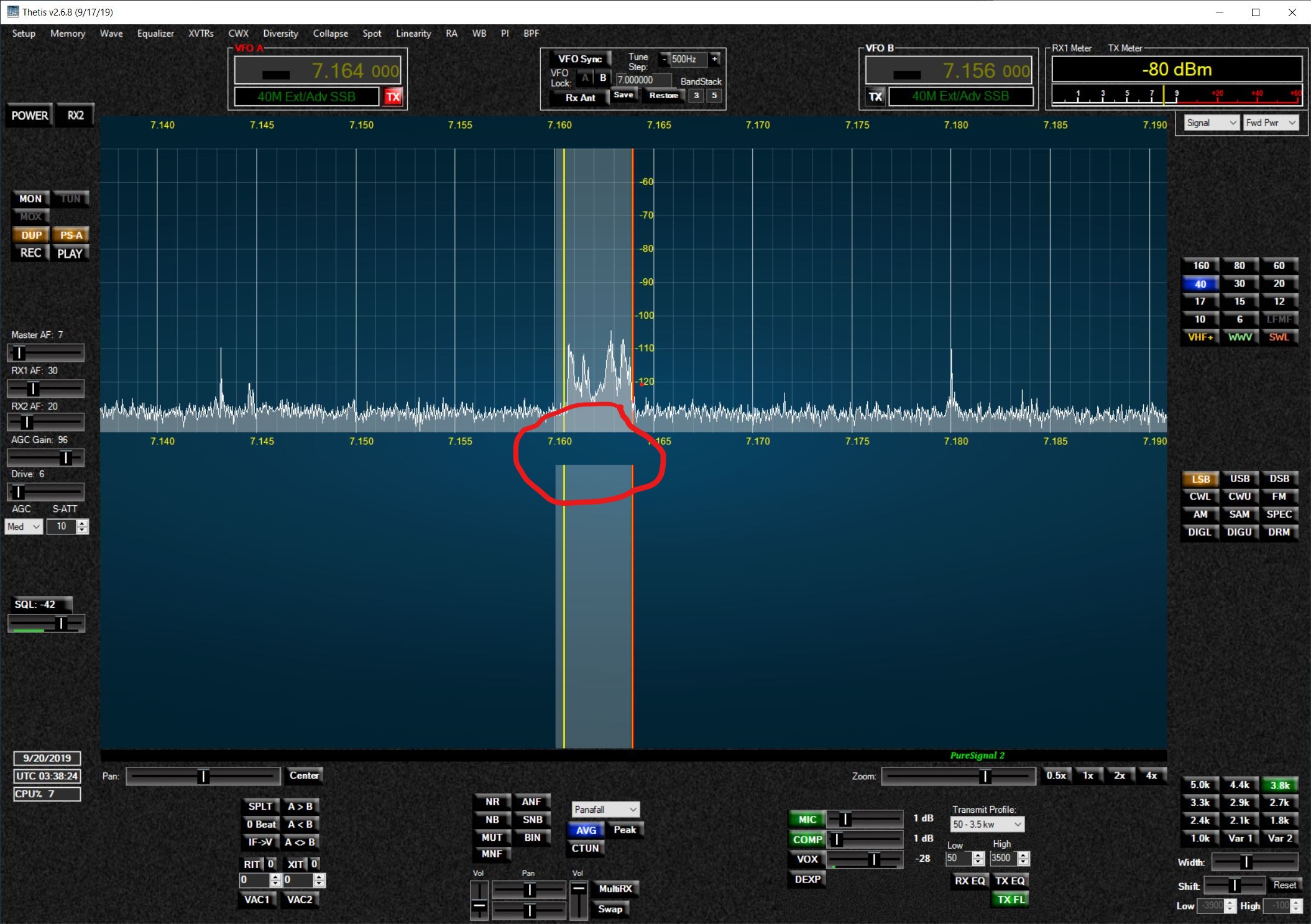

Fresh install yesterday showing same gaps others posted....
Carl
Carl Licari
NX5T

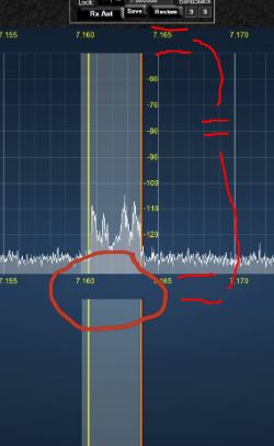

Posts: 1588
Re: 2.6.8
cLicari wrote:Fresh install yesterday showing same gaps others posted....
Carl
Hi Carl, cheers for the report. It is quite far down the bug list as it doesn't really break anything.
It is caused by the offset used on the grid in the spectrum. If you notice when you resize the grid vertically, the top position changes. This is old code that I haven't had a chance to change yet to 'fill' the available area. If you set a low step size in setup->display->rx1/2->Spectrum Grid->Step then the gap will 'reduce'.
'tis on the todo list :)
