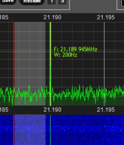

Also, in this build (b7) :
Notch filter gui, still work in progress. No gui resize of notch as yet. Not fully tested, bugs to be found I am sure.
- Click +MNF to add a notch filter at current VFOA frequency, 200Hz wide. Shift click +MNF to add one 100Hz wide.
- Middle click a notch to toggle active state (it turns a feint grey and text pop out is red when inactive)
- Shift middle click a notch to delete it
- Drag notch to move, change only apply after release
- MNF toggle state will make all notches turn feint shade
- mouse over a notch to give pop out details
also
- notches can be added/edited etc via standard setup->dsp->mnf
- notches can not be added/deleted etc if setup->dsp->mnf is in add/edit state

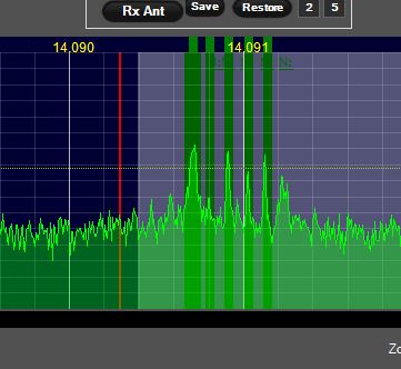

Posted: Fri Sep 20, 2019 1:34 am
Manual multi tracking notch filters, work in progress video. Still a couple of things to tidy up.
https://youtu.be/LQdpbv1aD9g

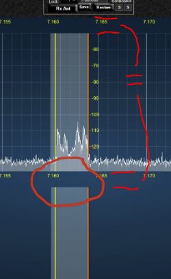

by cLicari
Fresh install yesterday showing same gaps others posted....
Carl
Re: 2.6.8
Posted: Fri Sep 20, 2019 4:01 am
cLicari wrote:Fresh install yesterday showing same gaps others posted....
Carl
Hi Carl, cheers for the report. It is quite far down the bug list as it doesn't really break anything.
It is caused by the offset used on the grid in the spectrum. If you notice when you resize the grid vertically, the top position changes. This is old code that I haven't had a chance to change yet to 'fill' the available area. If you set a low step size in setup->display->rx1/2->Spectrum Grid->Step then the gap will 'reduce'.
'tis on the todo list :)

by K9RX
Although I've yet to try Thetis you are making things very interesting! I use the radio a great deal - 24/7 for DXing and need it to be 100% reliable... I'm still a little leary about Thetis in that regard but it seems to be getting a lot closer with your efforts.
One suggestion re the notch placement. Having to change the VFO to place the notch, coupled with the fact that the notch is at that point and above (if Upper of course) means a little gymnastics. On FT8 it is a bit problematic since moving the VFO means you lose your current decode period so a wait of another 15 seconds ... and not being centered you have to mentality figure out where to place the VFO in order to end up with it properly centered.
It would be nice if instead you could use the yellow cross hairs and place it, centered, on them. This way in an FT8 window one could very easy notch out a loud station - move the yellow cross hair on top of it - centered and bingo. Since MNF is a global thing - turning on/off all notches that were created, maybe instead use (after having enabled MN with the MNF button) CTRL or ALT under these circumstances (or to be safe since they might be used for other functions CTRL+ ALT)? So one might hit MNF, it lights up, hover the yellow cross hairs over the offending signal, centered on it, hit CTRL or hit ALT (or SHFT) and BAMM its there. Then the ability to expand and contract it while leaving it centered ... if the yellow cross hair is over it use +/- keys to do so - just a suggestion.
