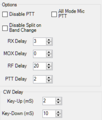

Rich,
Don't the following software options currently control the RCA jack?
NC3Z
Posts: 493
Location: Merritt, NC
Post by NC3Z »
Mark, that only disables the PTT in line on the Mic connector. TUN and MOX and 2TON still drive the RCA jack if this is checked.
Best bet is to use the new OC pins feature.
Posts: 1588
They insert delays and stuff into TX/RX switching, but do not de-couple the PTT Out RCA from TX.

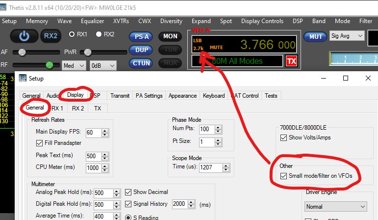

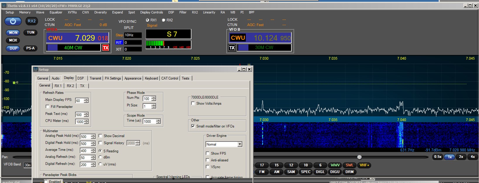

Hello.
I use "Andromeda Top Controls" screen with midi console. All is perfect. I'm missing only the filter value in this window.
Gintas
Posts: 1588
LY3G wrote:Hello.
Gintas
LY3G
Posts: 3
Joined: Sun Apr 21, 2019 7:22 pm
Post by LY3G »
[img]
[/img]
Posts: 1588
ah sorry, they do not display with the adromeda top controls. I had top controls turned on, which is different to adromeda top controls.

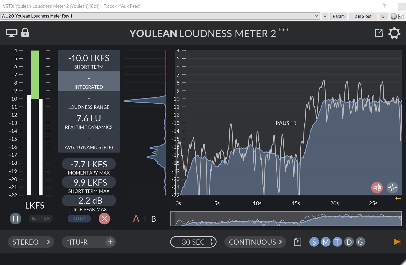

Interesting! I had noticed this before but never paid it much attention. Like Mark, I leave NR2 engaged 100% of the time. I know that some AM purists don't like to do this because they feel the NR2 artifacts change the character of the sound, and they do. But like Mark, I much prefer the sound of NR2, even on high SNR signals. For me it is far less fatiguing.
However, to Chris' point, this is a real thing. I tried the DC block option to see if it would cause a difference but it does not. Turning off NR2 and all other processing, it can be seen that the difference is essentially 6dB. In this example, I tuned an AM broadcast station, zero beat, 10KHz passband on AM/SAM, and 5KHz passband (40 to 5100Hz, actually), stock Medium AGC setting, and made the following graph. The first 15 seconds are in SAM (and AM appears the same), the latter 15 seconds in LSB.
The question, of course, is does this really matter? Surely you would want AGC to account for the energy in the AM carrier, no?
W2PA
Posts: 178
Location: LaGrangeville, NY
Post by W2PA »
Nice measurement, Scott. I would have guessed the difference was more like 3dB. Interesting.
Well it's a minor thing, but an annoyance as I pointed out, having to adjust the AF gain when switching modes.
I think a simple (software) adjustment of the level of AGC reaction to the carrier would solve the problem, yet retain AGC action in response to the carrier that provides the nice quieting action of the carrier against the background noise. This would be applied only in AM modes.
I guess the bottom line is I want the AGC to provide a constant audio level within its operating range - the main point of AGC - when changing modes.
Chris, W2PA
Posts: 741
w-u-2-o wrote:Surely you would want AGC to account for the energy in the AM carrier, no?
IMO (and to Chris' point) the AGC should level audio energy, not RF energy. If it did that then mode (AM, SSB) would be irrelevant.
I did some research on the AGC issue. I can report that it is working as originally intended, nothing is broken. The AGC responds to the full signal, including carrier. Long ago in the development of the WDSP library there was an attempt to have it respond to audio for AM, much as has been suggested here. The AM operators at that time quickly responded that the quieting due to the carrier was missing and they found that quite annoying. Thus the implementation remained as it is today.
It should be possible to merely add a 6dB boost in the audio chain when in AM/SAM. You could potentially petition Richie for such an option.
